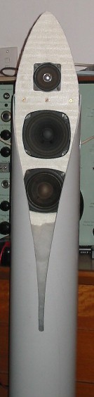

Yep, I've done it...
with 150mm plastic pipe about 1.2 meters tall, baffle down the middle, so it's folded, & 4" drivers,
it worked really well for me, but I haven't measured the result.
Plenty of low end
(I bi-amped with chip amplifiers, xover @ 150 Hz)
I'll post a pic when I get back to my usual computer...
I'd like to try again with good drivers and bigger pipe,
but too many other projects at present....
Pete McK
nah...
All my drivers are on the baffle, which is down the middle of the pipe. The top of the pipe behind the baffle is closed off. The baffle goes all the way down the middle except for a gap of 150mm at the bottom, so essentially its a folded pipe, loading the rear of the drivers.
The K slot is cut down one side of the pipe opposite the fronts of the drivers, so they can radiate into the room.
How do they sound...well, not having measured, this is subjective, but they sound very different from my stereo speakers (I'm using them for TV/HT sound - got 100% SAF 🙂 (even though i think they could be made to look a lot better). Plenty of lows for such small drivers & 5W amp; the pipes seem to have a gradual roll off which gives the impression of more bass
when augmented by the pipe resonances. I don't know how the transient response of these would measure, (for TV it doesn't matter to me), and I'm sure the slot has an effect on the radiation pattern. Of necessity, I have placed on either side of the room, (not ideal) and seem to sound best when aimed to cross over in front of the listening position by quite a bit.
The drivers I used were just odd 'no-name' units I had lying around, that's why I'd like to try again with better & bigger drivers, the sound is good enough that I'm convinced the approach has merit. I've got a pair of high q 10" drivers which might be good, however, I've been seduced by OBs in the meantime....Pete McK
pic
here ya go.... I'd do the slot a bit different next time though...
