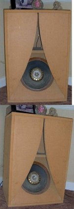

Hi MechanicalAnimal - here's a meaty 12" coax for which I hope to have a good new & little K-coupler which can pound. That's a 109 ounce ferrite slug. I think a LC-allpass network after the lowpass will help it blend. I hope it has some "life" with the 4" coil - -ideally a K-coupler should be capable of playing quite loud on dynamic music passages while maintaining an almost imperceptible cone travel.
Freddi,
That looks like a very interesting driver, not seen one of those since Urei/Altec made something like it (with grating in the horn).
Could you please give a bit more info on this driver?
tnx,
vac
tnx,
vac

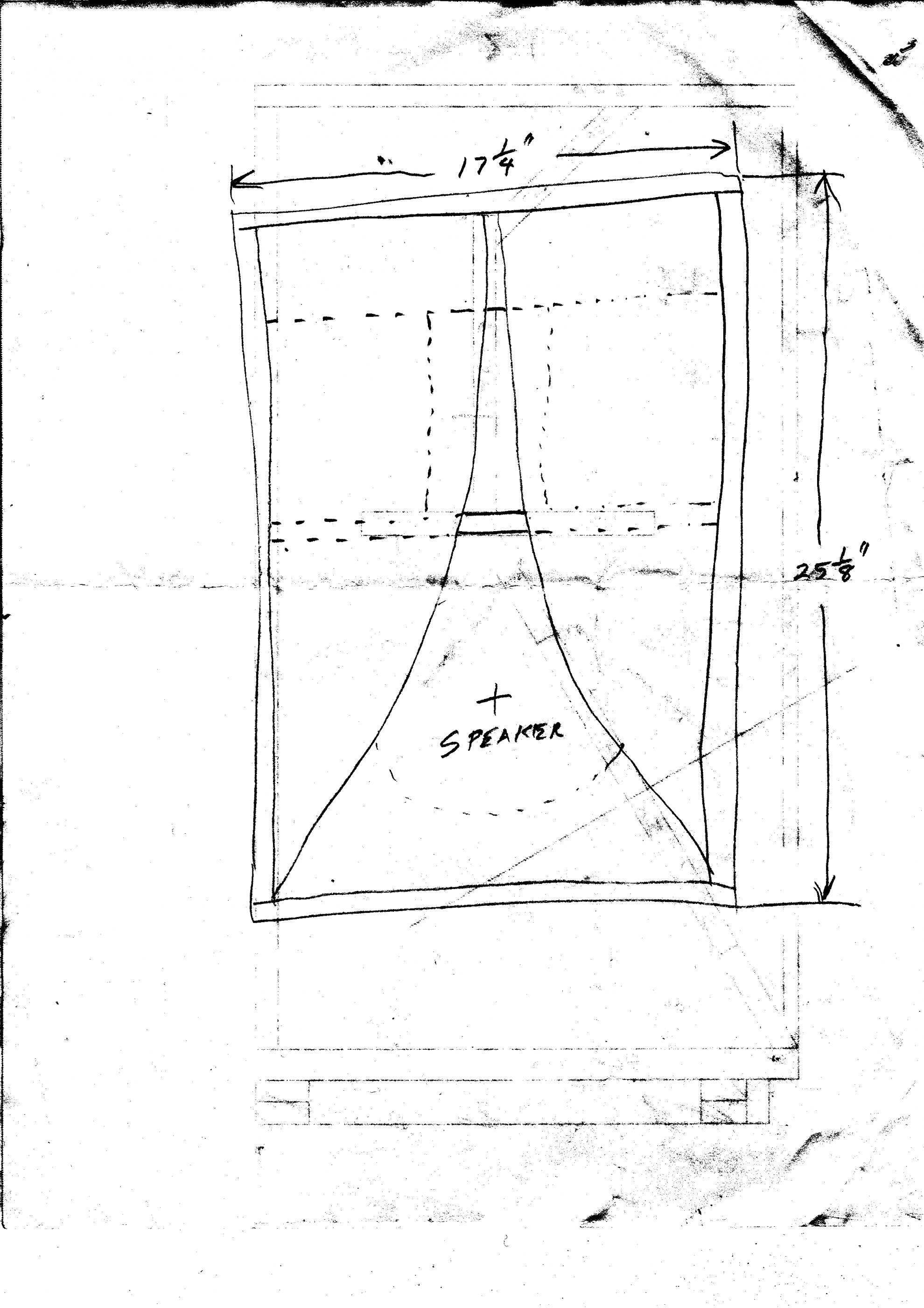

I built these 3/4 Scale Karlson's, Many Years ago.
And a friend of mine built me a couple of 12 Inch Coaxial speakers for them.
Excellent Results.
Those 8 inch Speakers seem to lack a bit in the Bass Response and not so good on the Highs.
A 12 inch Coaxial Speaker would be better
Excellent Results.

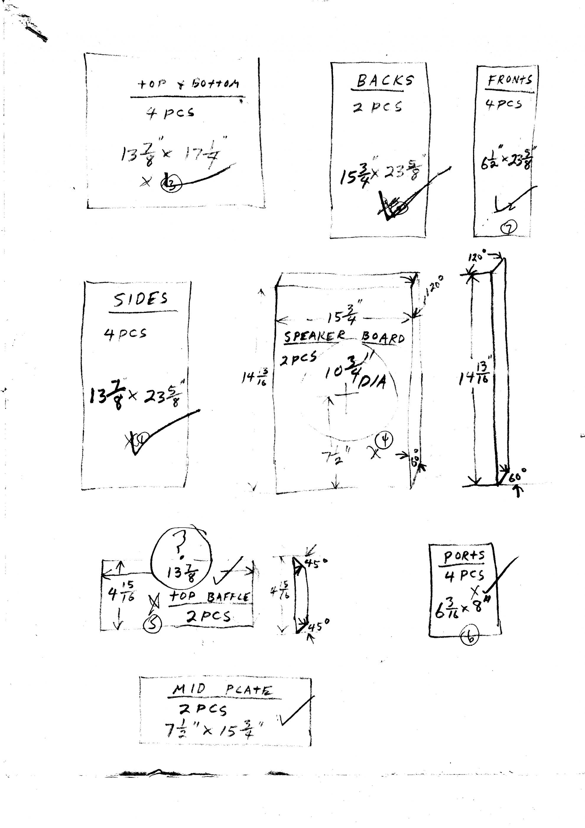

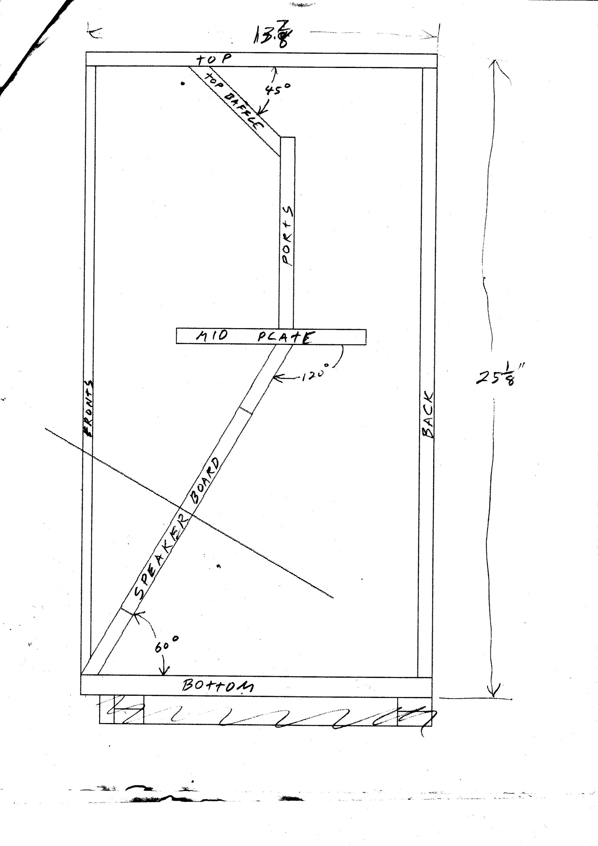

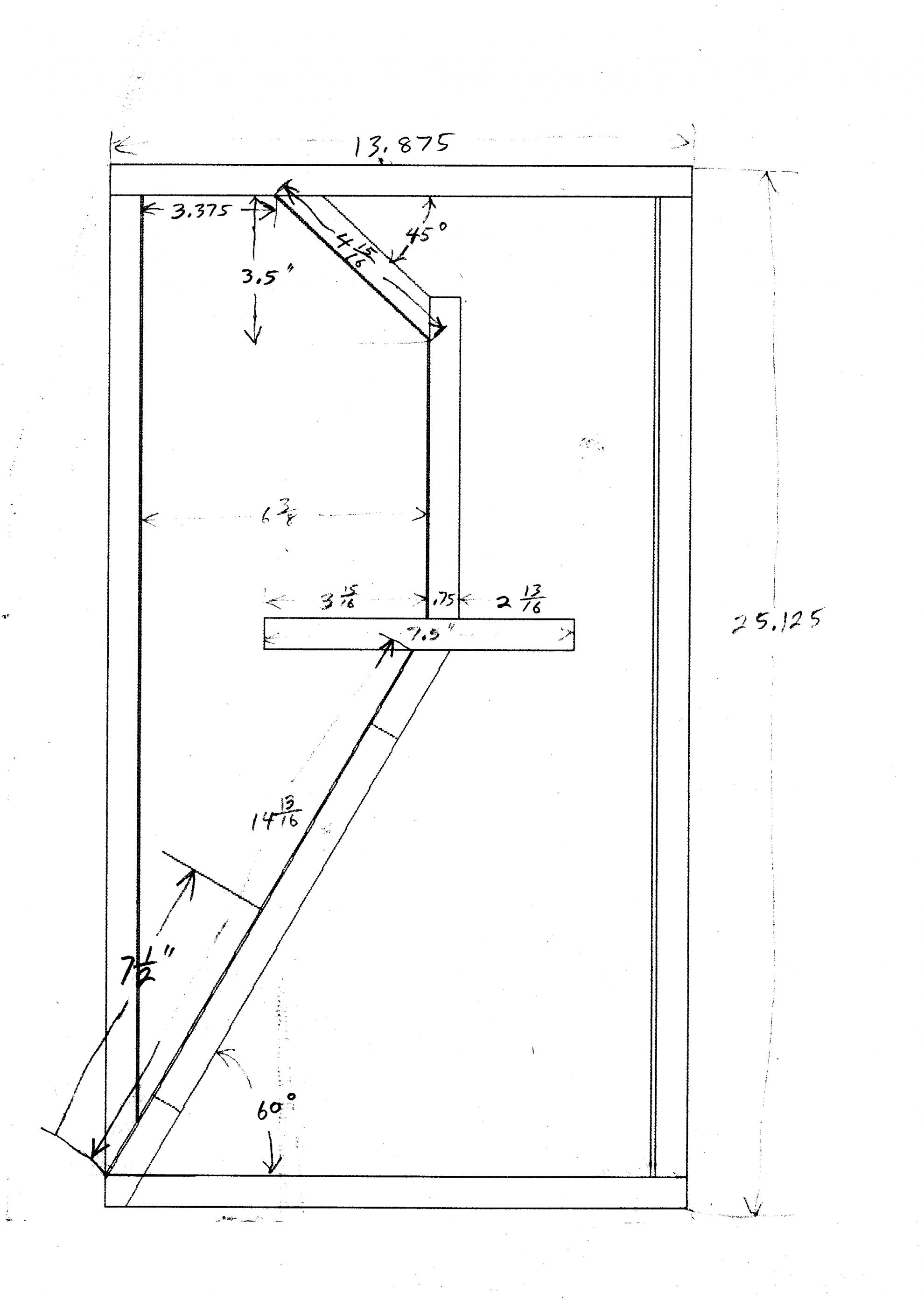

Here were my original drawings for the Two 3/4 Scale Cabinets.
Exactly what my father had in his youth... will be nice to have these built for him for Xmas 🙂 Many thanks 🙂
These were made using 3/4 Inch High Quality Particle Board.
Not the Cheap Grainy Stuff, But The Really Hard, Fine Grained Particle Board.
Don't use Plywood, it is Not Suitable.
I put these cabinets Together as a Dry Run test, Screwed but No Glue.
They worked so GOOD, I Never took them apart to Glue and Screw them.

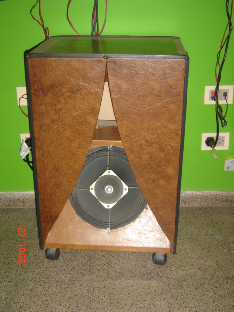

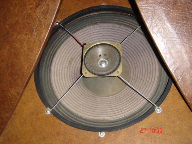

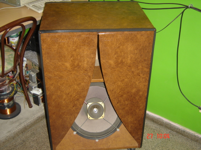

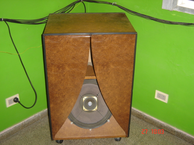

This 3 K's are being used driven with a TDA2006 (12WPK per channel). I can't use full power because my house shakes.
Do you use one as a centre channel?
Effectively. In the preamplifier stage, there is a opamp differential amplifier who subtracts (adds algebraically with one phase reverted) both Left and Right channels. Then, this signal is feed to a 3rd channel who has independent volume (gain) control and power stage. As many low quality MP3 files give unpleasant sounds in this speaker, I mute it in those cases. 128Kb MP3's (Or better), ogg vorbis, FM's and CD's creates a good 3D sensation when listened sitting in the axis of the 3 cabinets (Mainly in live concerts), with few power and trying not to disturb neighbors.
The 12" + 4" K is located back to the listener (me) and the L and R (15" + 4") are at 90° between them in a corner of my house, and in front of me.

Ah, the cabinets have leather covered baffles too?
