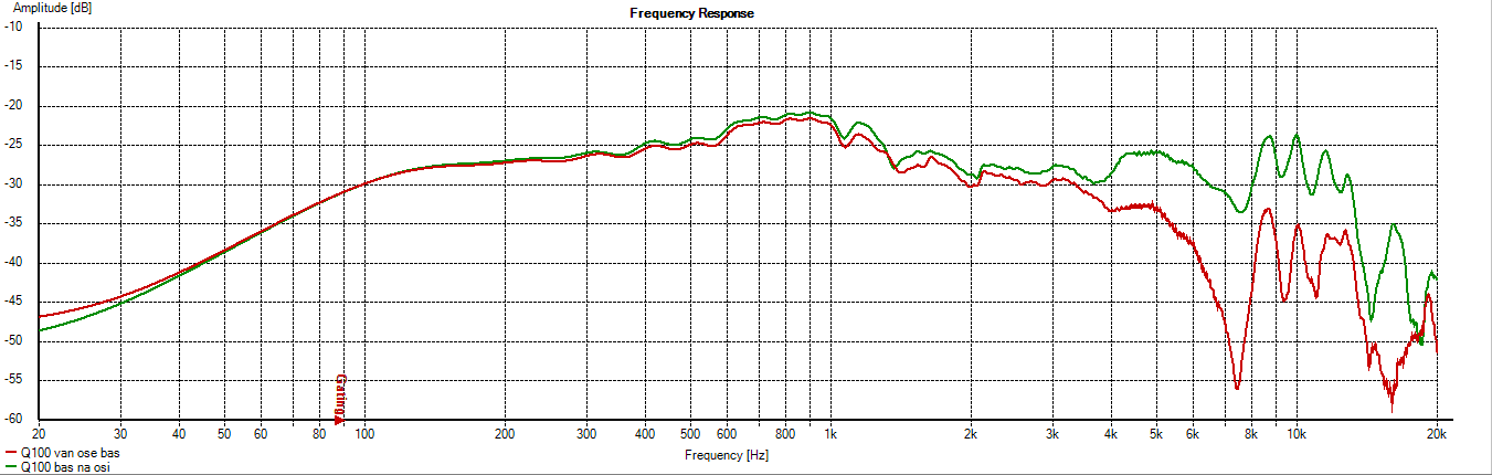

[ Enclosure is made from MDF 19mm, front baffle 22 mm, internal bracing glued with elastic glue. Front baffle is glued to enclosure with soft polyurethane glue that is used for gluing car windshield. Driver is coupled with back and side walls... ]
Clarified, optimized... to see inside details
Bass-reflex.Closed box, without rear bass-reflex?
Unfortunately I do not have any pictures of the later added supports.

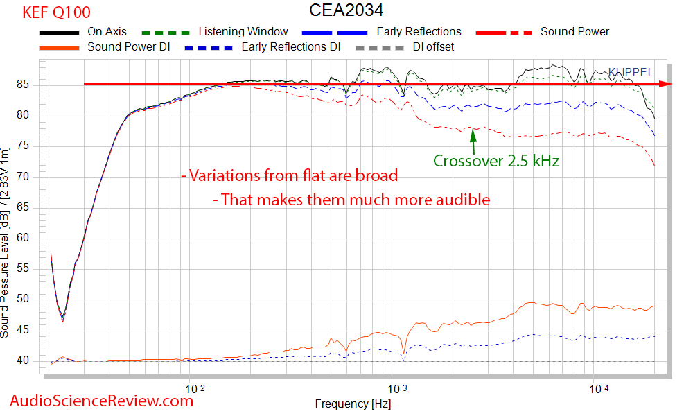

The response certainly looks good with your crossover, but hard to judge who won the war without seeing the other side- what does the response look like on/off axis with the stock crossover?
KEF Q100 Speaker Review | Audio Science Review (ASR) Forum
In the above site you have measurements with a factory crossover. As there is one coil on the bass, the effect of membrane resonance at 10kHz can be clearly seen. That's why it sounds really bad.
And simulation of factory crossover

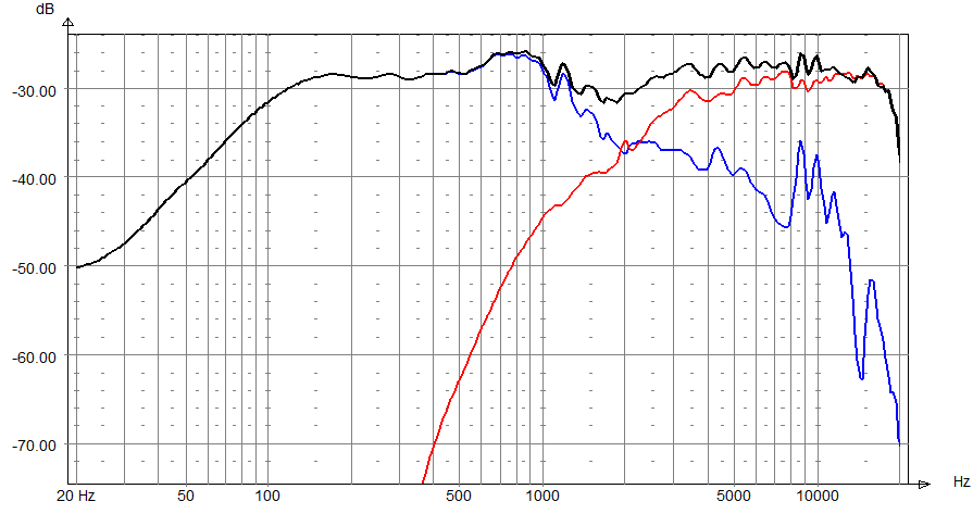

[ Some time ago Zvu passed me the files of his measurements and I did a few simulations based on his proposal for a new filter.
* It is important to me that the tweeter uses a first-rate filter and thus take advantage of the best quality of the components. With Miflex KPCU-01 0.022uF (22 nF in the image) 600Vdc as bypass cap.
* The other restriction was to keep the original woofer air coil. ]
With one or two filters at 1.4 kHz and 1.7 kHz ... with minimum phase PEQ + rePhase...
Proposed by Zvu
Proposed by Zvu
With Zvu crossover we lose 2 dB in sensitivity with respect to mine -> amplifier with more watts at 4 Ohms.
With KEF Q100 driver, which is better, lower or higher the crossover frequency? It is the doubt that corrodes me.
My proposition should be looked at for what it is - quick and cheap way to remove the midbass resonance from the sound of finished loudspeaker using the most out of factory crossover components.
If i were to build the crossover to correct all the things bugging me with Q100, it would probably look a lot like what Jokerbre did.
