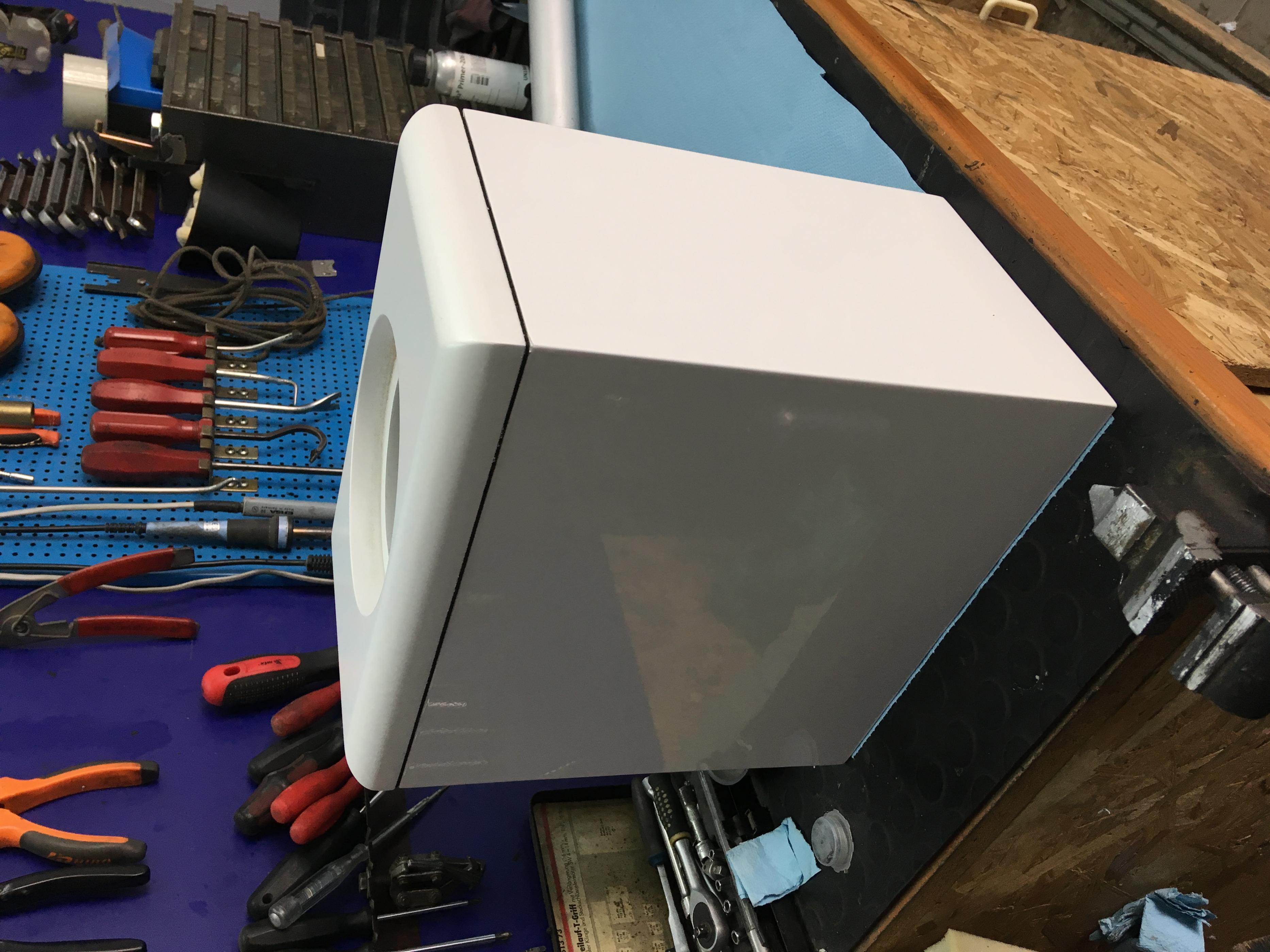

Made new enclosures, new measurements in new enclosures and these are the results.
Mic is Umik-1

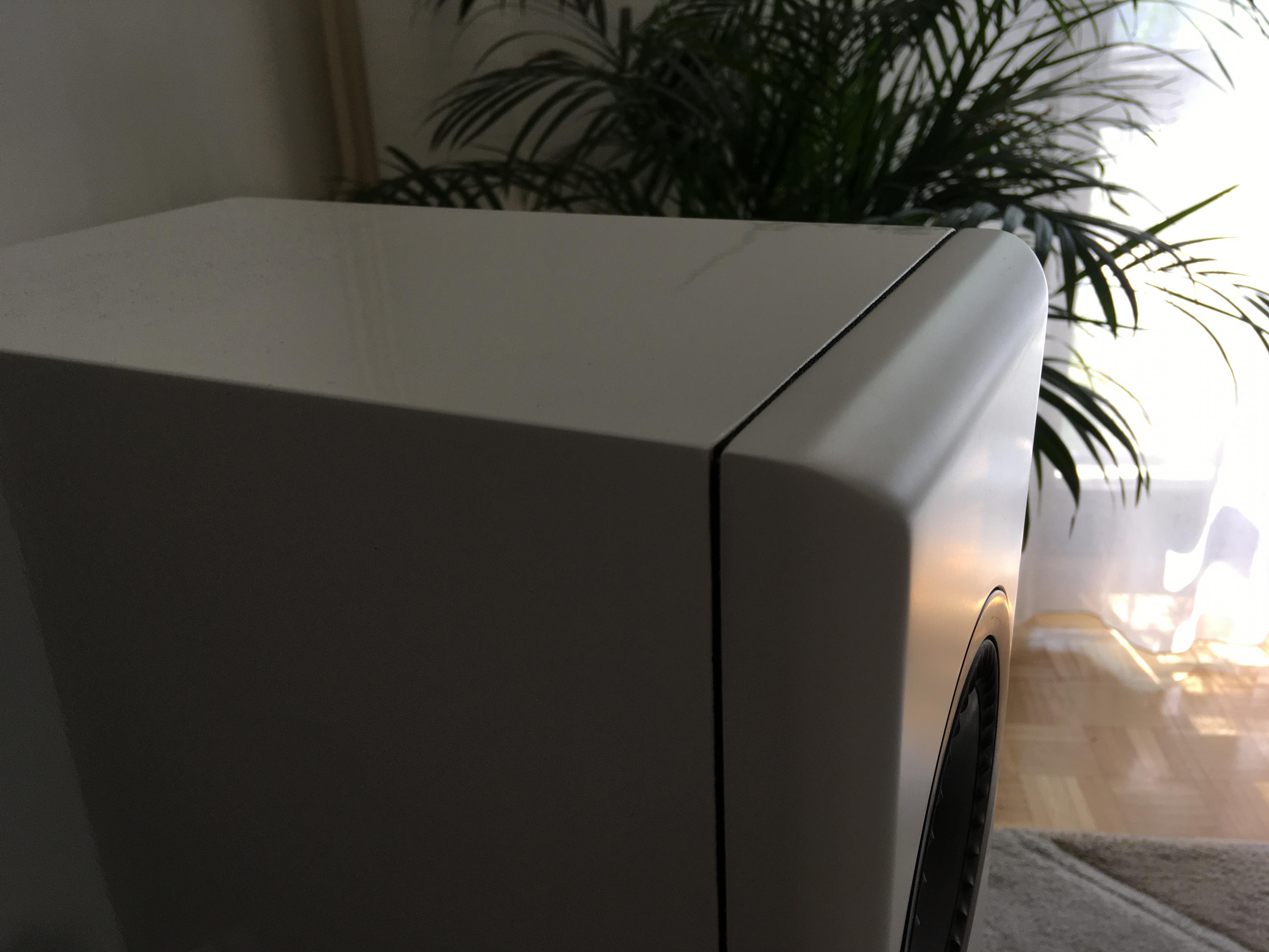

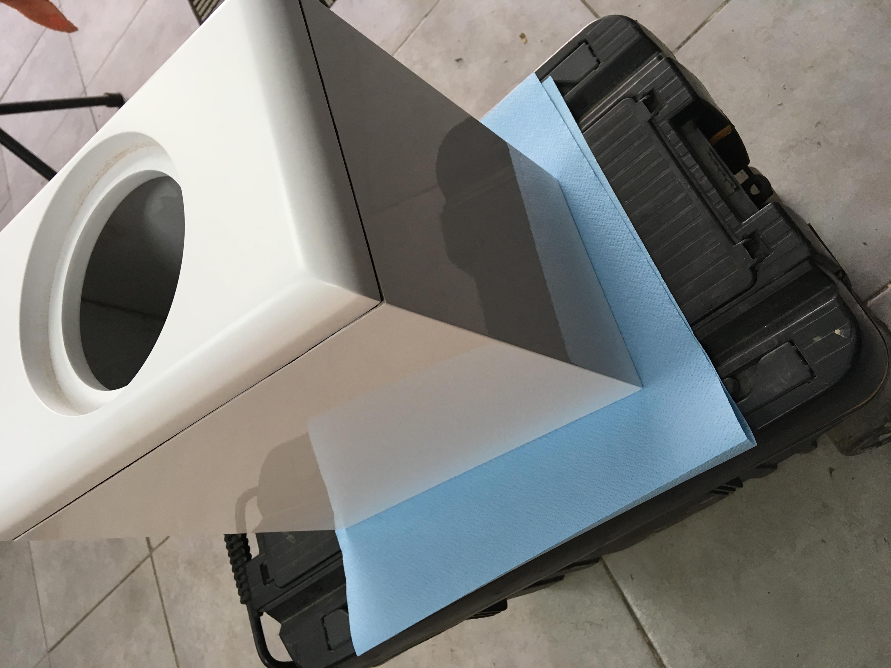

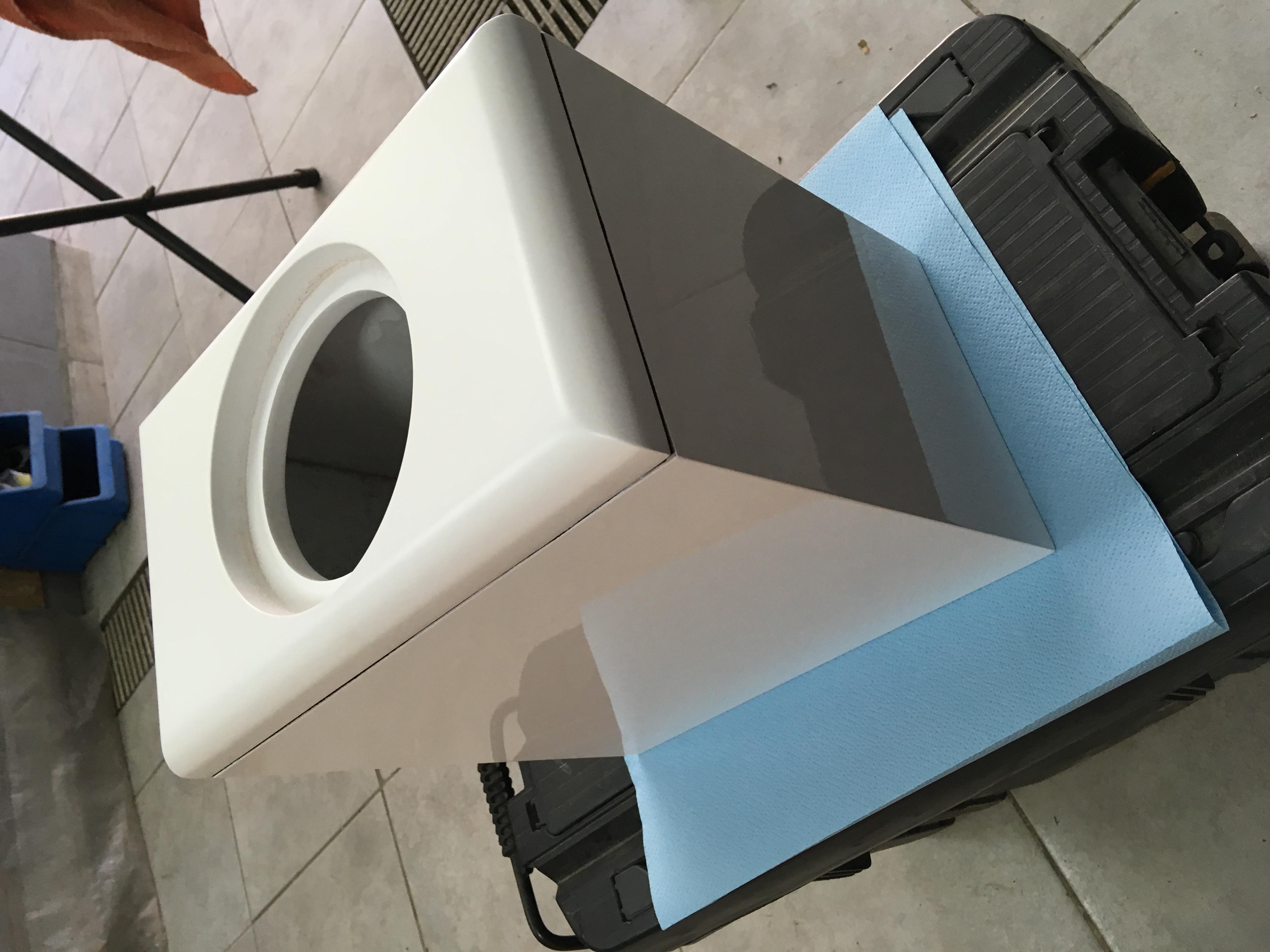

I made them myself from 19mm mdf, front baffle 22mm.Jokerbre, did you make the enclosure or purchase it from a vendor. If you purchased the enclosure, would you please share with us where you found it?
I'm asking because I'd like to follow your lead and improve my q100s with a more robust--and sealed--enclosure but I lack access to woodworking tools. Thanks in advance for your help!

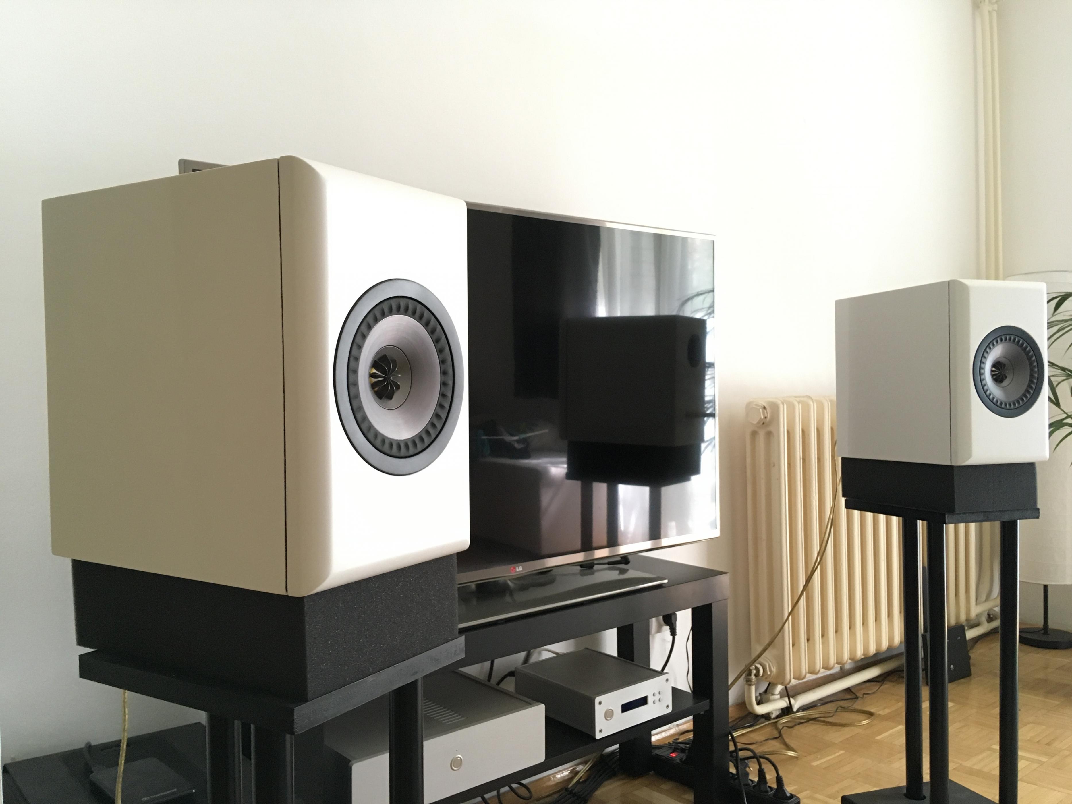

Already some years ago there was a project from Germany that has won a DIY contest using the driver from the Q100
Here a picture:
The guy has chosen to run the stuff with miniDSP and 6 amplifiers.
One of the remarkable things i have read is that there was the finding that with the active crossover there is a chance for a slight improvement with a delay between the cone driver and the tweeter of the coax - there is no good chance to get this with a passive crossover.
KEF made a lot of research for the crossover of the KEF Blade - they stay with acoustical LR12 and correction RLC for the resonance of the tweeter.
I have made some listening tests with woofer + KEF R300 coaxial driver unit with 2 X miniDSP 2 X 4 HD and the best soundstage is achieved with LR 2 and not as usual for many other designs with LR 4.
Here a picture:
