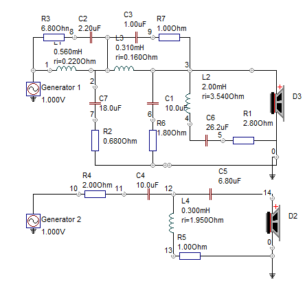

I prayed to the gods of DIY, and went to war against poorly executed Crossovers.

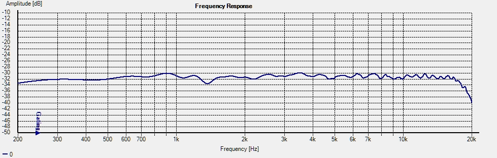

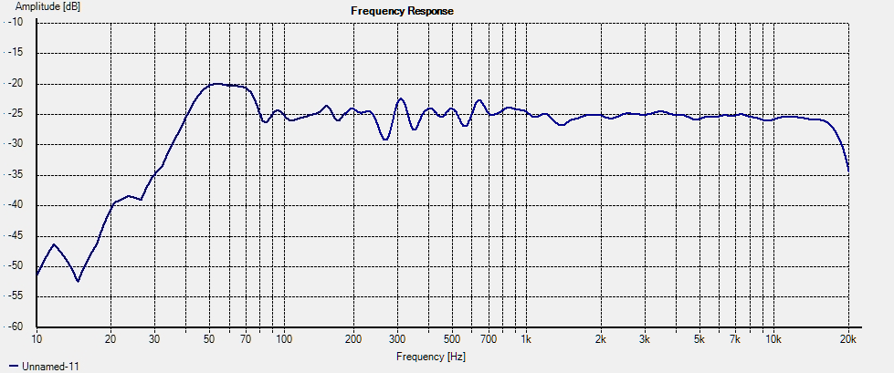

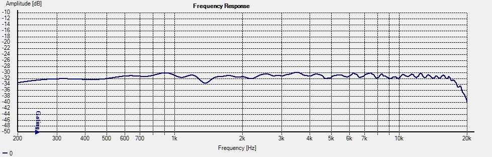

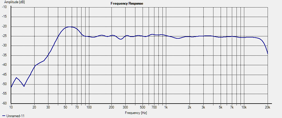

Made new enclosures, new measurements in new enclosures and these are the results.
Mic is Umik-1
Crossover
On axis
Of axis 0-10-20-30-40-50
3db/oct
I don't know exactly how the speaker behaves below 200hz due to the measurement in the room. This response is combined from two measurements, read approximation…

Jokerbre,
First of all very impressive work on Q100 upgrade. I'm trying to figure out required components for you crossover design but having some issues with finding the exact match for following:
  • C6 26.2uF
    [*]R1 2.8 Ohm
    [*]R3 6.80 Ohm
    [*]R6 1.80 Ohm
    [*]L3 0.310mH
Do you think you could point me in the right direction, please? Thanks.

If it's complicated for you, you can combine 10+10+6.8uF, it's not a problem a small change in value. You also combine resistor values. This project served me to get a better sound than the LS50 for less money. And I succeeded in that. Can there be a simpler and simple crossover? Yes, of course it can be, but my logic is always to do the best possible without paying attention to the number of components, but only to measurement and sound. When I achieve that, I can slowly reduce the number of components because I have a starting point.
