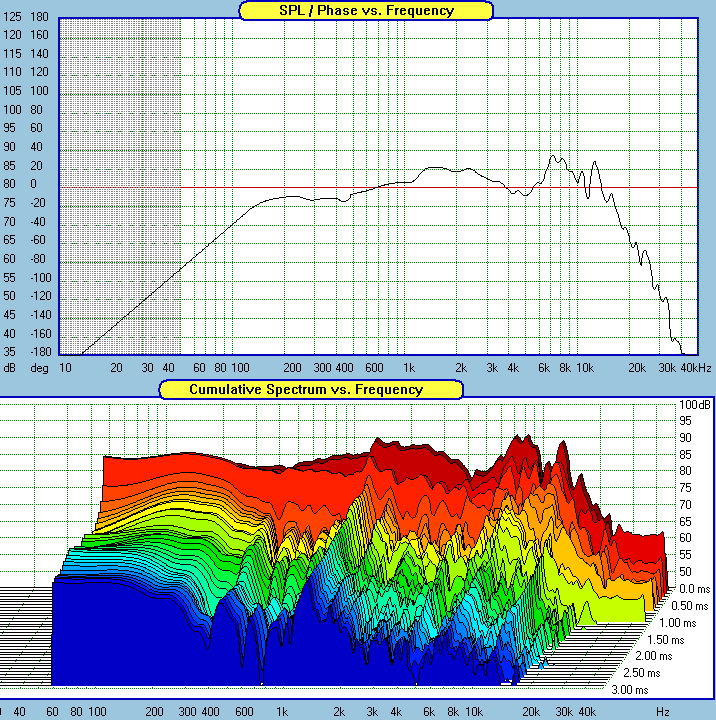

I didn't do any comparison yet, but I ran some quick tests of the WR125s. On the good side, what I found so far is a very smooth and low distortion midrange. There was some high frequency breakup, but it looks controllable. On the bad side, Qts was nearly 1 and efficiency was low.
I've attached some data - Frequency response, on axis and 30 degrees off axis, T/S parameters, a CSD chart and exported Z and SPL for modelers to mess with. Don't trust the drive level, but it's supposed to be 1 watt measured at 1/2 m. These are all infinite baffle measurements, so don't forget to sum in the baffle step to get a real in-box response.
In my opinion, these need a tweeter and a crossover. Also, the effective corner frequency and shaping of the baffle step compensation could help minimize the midbass peaking from high Qts. What's left is dealing with the low efficiency. It's probably fine if you have a decent power solid state amp and you use a subwoofer, but these are probably too inefficient to use as a midrange in a passive 3-way unless you double up to a MTMW or a MMTMMW or something.
I'll let you guys know when I do more complete testing and a comparison to other drivers.
I have forwarded the results to Dan Wiggins the designer of the driver and am awaiting input from him before responding.

Zaph- what kind of break in did you do? The CSD looks sort of nasty, too, with a lot of ridges. I sure wouldn't use it beyond 5k or so, that is for sure. Still, up to 5k it is quite smooth. Making me a little nervous about my Extremis order 🙁
Breakin was a few hours at high Xmax.
The CSD, in my opinion is very good. Yes, there are ridges, but nothing large, and notice how through the midrange the signal immediately drops off almost 20db. Measurements like this are unfortunately not very usefull unless you have a point of comparison. Hold off on judgement of the CSD until there are side by side comparisons.
