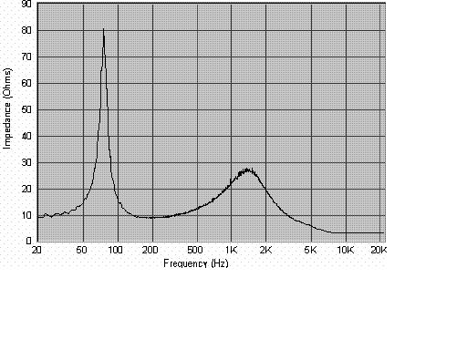

Sorry for the delay posting, but please find the impedance curve attached. This curve includes tweeter and woofer plus crossover and is the final system impedance:
Dan:
The design I posted (with notes) is the final design. My current recommendation is to go with the 1.8mH inductor on the woofer and a slightly higher value resistor on the tweeter - between 1.0 and 1.1 since the increase in midrange output will also require a bit more from the tweeter. Using the 2.0 mH inductor just makes the midrange too laid back. Also, please note the error in the x-over layout - both tweeter and woofer must be wired in phase.
Andrew

For anyone considering the design I posted, I am now recommending a slight change to the design. Please substitute a 1.8mH inductor on the woofer instead of the 2.0mH originally specified. The 1.8mH should be a Madisound Sidewinder "Low Resistance" 16 gauge air core. If you already purchased the 2.0mH parts (as I did), you can simply unwind them a total of 18 complete turns to get them down to the 1.8mH value. Please note that the parts I received from Madisound were actually rated a little too high to start - coming in around 2.17. If you wish to try variations between 1.8 and 2.0 you may do so and I have determined that an approximate adjustment for each turn unwound is .02mH (please realize that in reality this value will change as the diameter of the coil itself is changed with each turn as it is unwound . . .)
