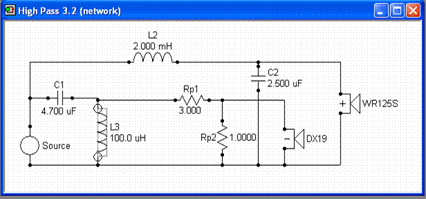

Final X-Over
Folks:
Here is the final x-over schematic attached for download, a parts list and some of my notes:
Please note that the design is subject to change and no guarantees of performance are provided.
1. The design does not include impedance compensation circuitry.
2. My testing of the 2.0mH inductors show that their values were about 7% too high. I manually unwound these inductors by hand exactly 8 turns. This brought the measured value down to 2.0 from about 2.17. The degree to which these speakers sound "mid-forward" is controlled by the value of this inductor. If you wish to play with the woofer x-over you may try unwinding the 2.0 mH more than 8 turns or you could just try a 1.8 mH. I have tried both and the speakers sound very good but brighter with the 1.8 mH. With the unwound 2.0mH they sound a little more "darK" with a more pronounced mid-bass but are a little easier to listen to overall. The value of this inductor is used to control the baffle step as well as helps to define the 2nd order low pass x-over for the woofer. The change from 2.0 to 1.8 mostly impacts the baffle step correction. I have found that with different electronics either the 1.8 or 2.0 might sound better. Running off my Denon receiver directly I prefer the 1.8 but running the Denon pre to my Dynaco ST-400 amp I prefer the 2.0 as the Dynaco (with a full rebuild and my modifications) is brighter in the midrange than the Denon on its own.
For Home Theatre I would recommend going a little brighter and opting for the 1.8mH inductors. For music the choice is yours.
3. The 1 ohm inductors in the tweeter L-PAD can be swapped out to make the tweeter brighter or more laid back. Differences of 1/10 ohm are noticable. If you wish to calculate additional values, you may do so easily with this on-line tool:
http://www.1728.com/resistrs.htm
To get the tweeter brighter try a value of 1.1. To bring the level down try .9 ohms.
For reference, 1.1 can be obtained by running a 2.0 and 2.4 in parallel. A .9 can be obtained by running a 1.5 and a 2.4 in parallel. These values are all available in the Dayton non-inductive line from PE . . .
4. Although the system is using 2nd order x-overs, be sure to wire the tweeter and woofer with the same polarities (not inverted on the tweeter). This eliminates a null which is formed from the inverse wiring configuration in the farfield measurement.
5. Pack the enclosure heavily with fiberfill directly behind the woofer in both the front and rear parts of the lower half of the enclosure.
6. Build your x-over on the fiberboard strips and mount them in the middle of the enclosure to the cross brace using zip ties and put some fiberfill between the x-over and the cross brace to eliminate noise/vibrations. Drill holes in the fiberboard to define mounting locations. Be sure to mount your inductors perpendicular to one another and rotated 90 degrees to reduce magnetic interference between them.
7. Be sure to make your baffle cut-outs as mirror images of each other.

Please note that there is at least one error correctly identified by Timn8ter in the cut-out notes listed above - the woofer ring should be 5" diameter not 6". I can't emphasize enough how important it is to confirm those measurements - they may not be correct as represented above.
Yes, I do have an overall impedance curve. The crossover itself impacts the impedance dramatically. I can also post the individual driver impedance curves if you are interested in those as well, just let me know.
I am traveling today through Friday on business, but I will try to post the curve for you over the weekend.
Generally speaking I think the concern has to do with making sure the impedance doesn't go so low that the load is hard for an amplifier to drive. The good thing about the impedance I measured is that it is not too low and therefore should be okay for amplifiers to drive the speaker without any problem. Off hand I can't remember the lowest point but I will share the curve with everyone once I'm back home.
Andrew
