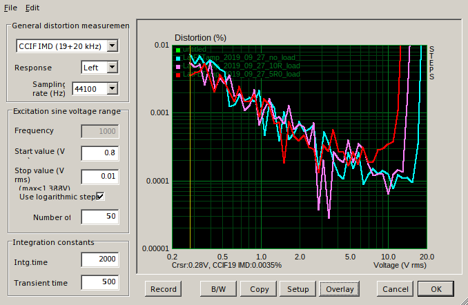

Today I add TIM measurements with 5R/10R and no load. I assume that distortion level is hidden within the noise floor, which is dominated by soundcard output noise.
This looks to be IMD , how about the harmonics at 10w . What bias current you ended up with ?
You are right, this is IMD. Bias was all the time 100mA.
You can read IMD/10W at the depicted plot at 10V/10R and 7V/5Ohm respectively.
Is there some way to display the harmonics within STEPS?
edit: I see ARTA FFT offers multitone measurements.

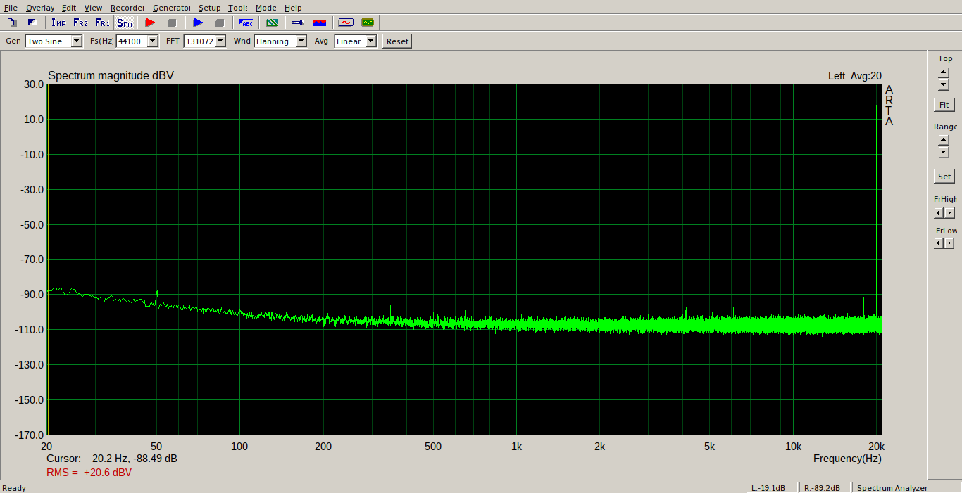

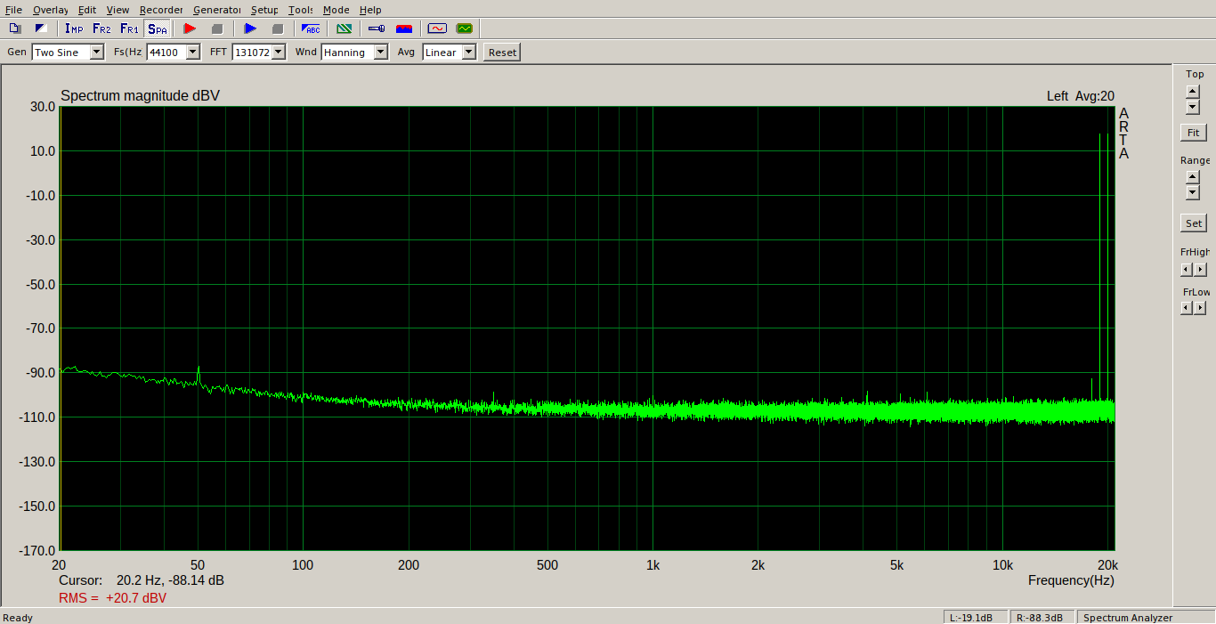

So I measured the spectrum of 2-tone IMD 19/20kHz with ARTA.
10Vrms/20dBV at 10R/no load
7Vrms/17dBV at 5R0 load
What do you think of the result?

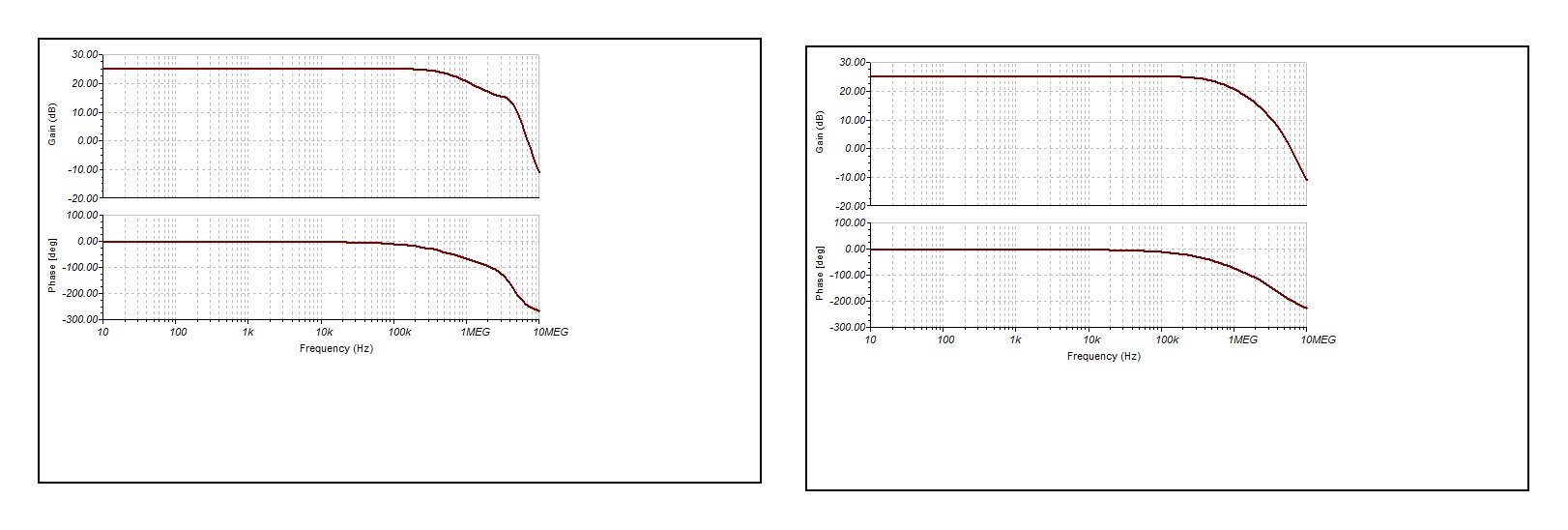

I love your compensation technique. I definitely adopted it . I applied on beginner's CFA 150W amp . and result you can see before and after . Mille bravo . Is it your invention this two way compensation? Is it baptized?
Thank you for the kind words. It is nice to see knowledge transfer being appreciated. The 2-pole compensation is well known for decades. And has been extended to nested feedback loops by Bruno Putzey, for instance. I followed the general rule to reduce additional poles of the gain stages, making them as fast as possible. And I reduced miller cap as far as I could. Most of the development was fiddling with LTSpice for best theoretical performance. So I do not think that there is some detail in my circuit you have never seen before somewhere. All in all it is a composition of what I call good engineering practice.
cheers
