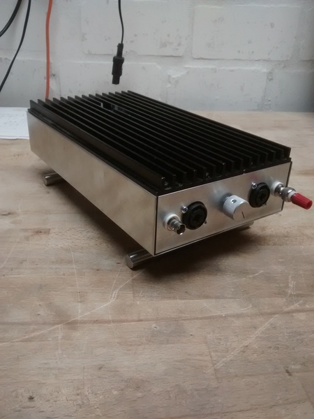

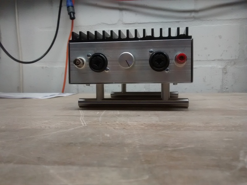

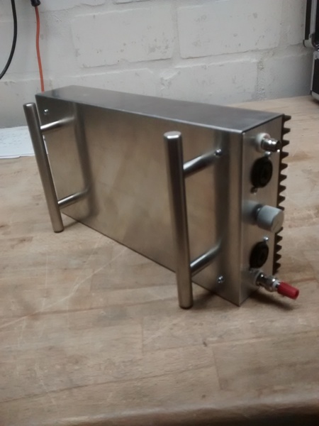

some pictures

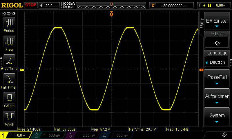

The main reason obviously was overdrive recovery of the hi-speed/low voltage BJT (BC850C) driving the VAS cascode (DZT5551). Besides some fine-tuning of compensating networks (a never ending story) I replaced the BC850C by a low signal NMOS 2N7002 hoping to improve recovery from overdrive. This was a 1:1 replacement without any adjustment of DC biasing: Output DC offset measured 5mV after this patch. All in all there is no reason not to put such NMOS into this very position.

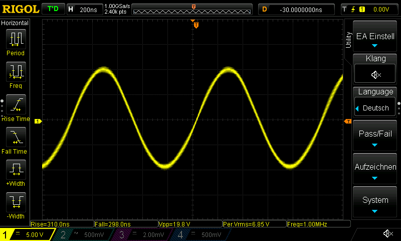

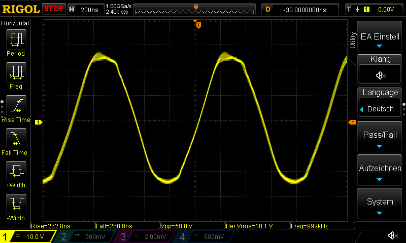

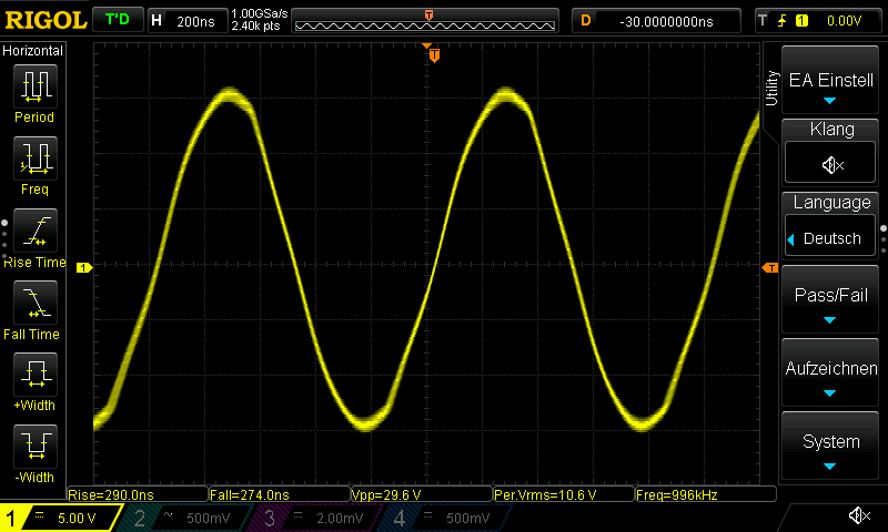

1MHz sinewaves of 20/30/40/50Vpp measured at output, loaded with 10R dummy. There is some visible distortion at high levels. This depends directly of the gate series resistors. After some fiddling I choosed 330R/220R as the best looking compromise. This is an obvious improvement comparing with the results presented in posting #92 from 2019-08-15.

Mains power consumption was 47W with 1MHz 50Vpp into 10R dummy, dropping to 40W w/o dummy load.
I conclude that the series inductance of the dummy load takes over at 1MHz reducing current to a fraction of the nominal value.
40W power consumption w/o dummy load indicates significant losses inside the amp, presumably cross-conduction.
There may be some room of improvement by further optimizing gate drive circuitry.
On the other hand - these lateral FETs handle such abuse without any problems - BJTs would have blown during the fraction of the first second.:)

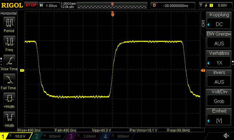

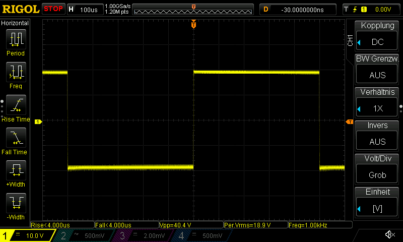

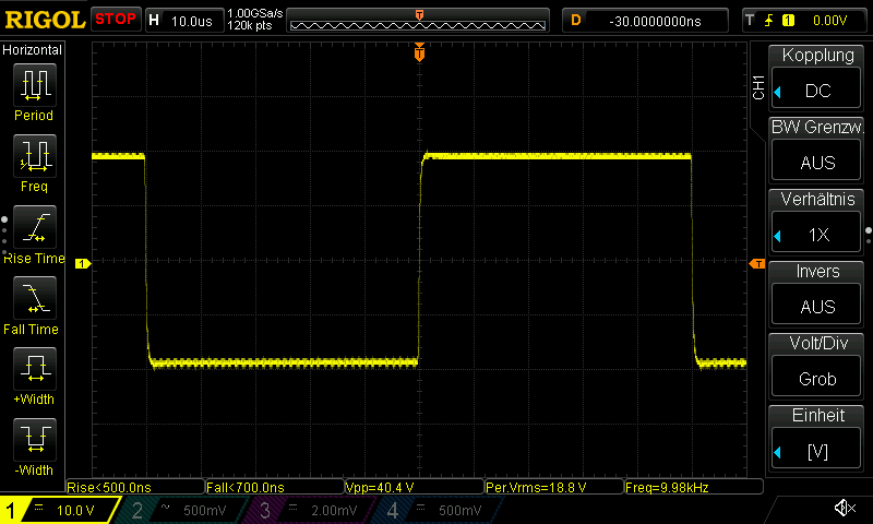

Actual measurements of square response with 1/10/100kHz

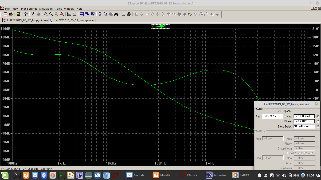

I have been fighting with a slight overshoot all the time - and LTSpice confirmed this behavior. Increasing the input LP filter as a compensation is a poor workaround here. At the end it helped to over-compensate the feedback divider by increasing the lead cap from 33pF to 47pF. This can be understood as some "partial cherry compensation".

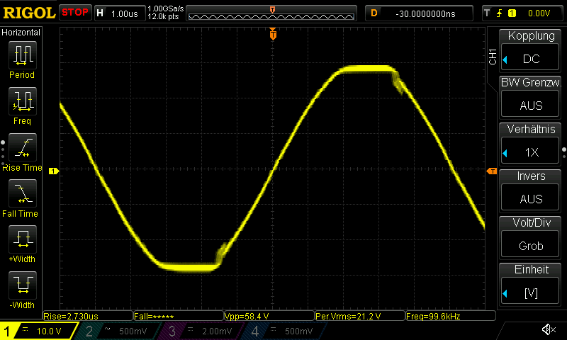

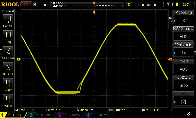

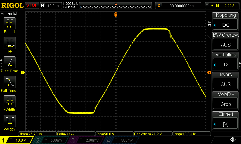

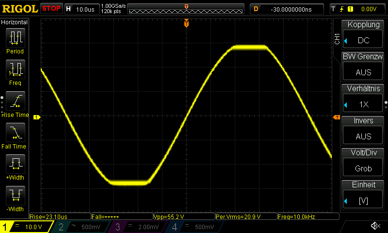

Clipping behavior measured at 1/10/100kHz.
1kHz clipping is worse than 10kHz - very strange:confused:

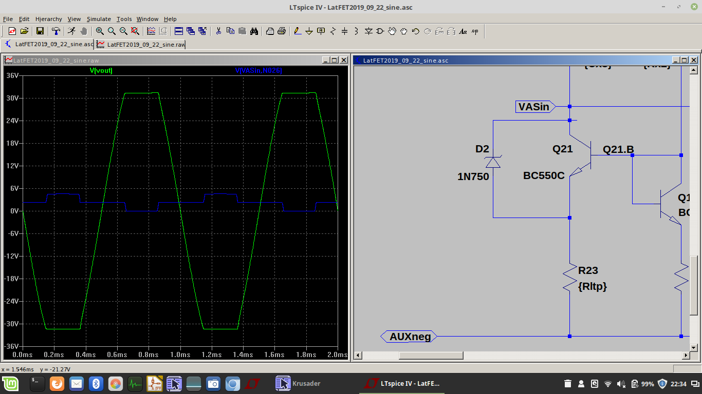

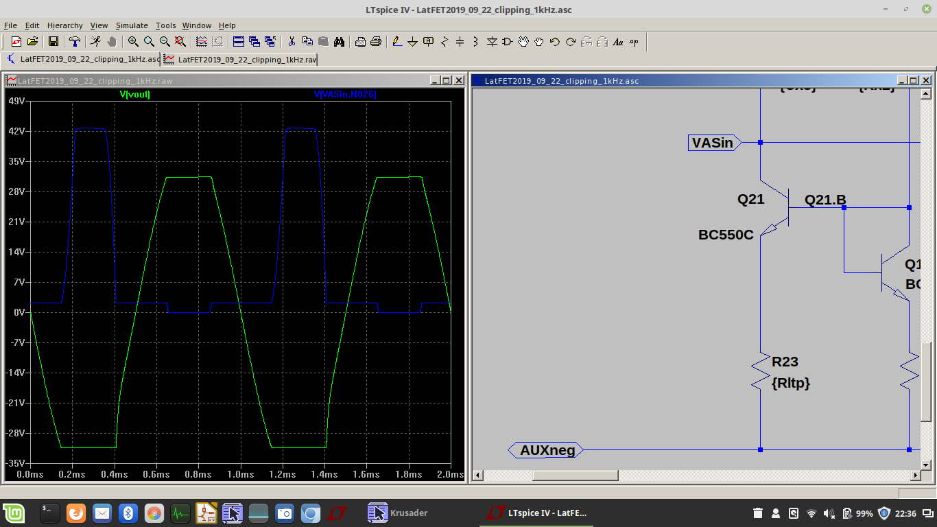

So asked LTSpice - and, voilà, the same misbehavior shows up in simulation. The VAS input voltage rises upto 40V referred to neg supply rail - this is an excessive overdrive that takes time to recover.
This issue relates to swapping the VAS BJT to 2N7002: The BJT-base limited the VAS input level, the NMOS gate does not.
