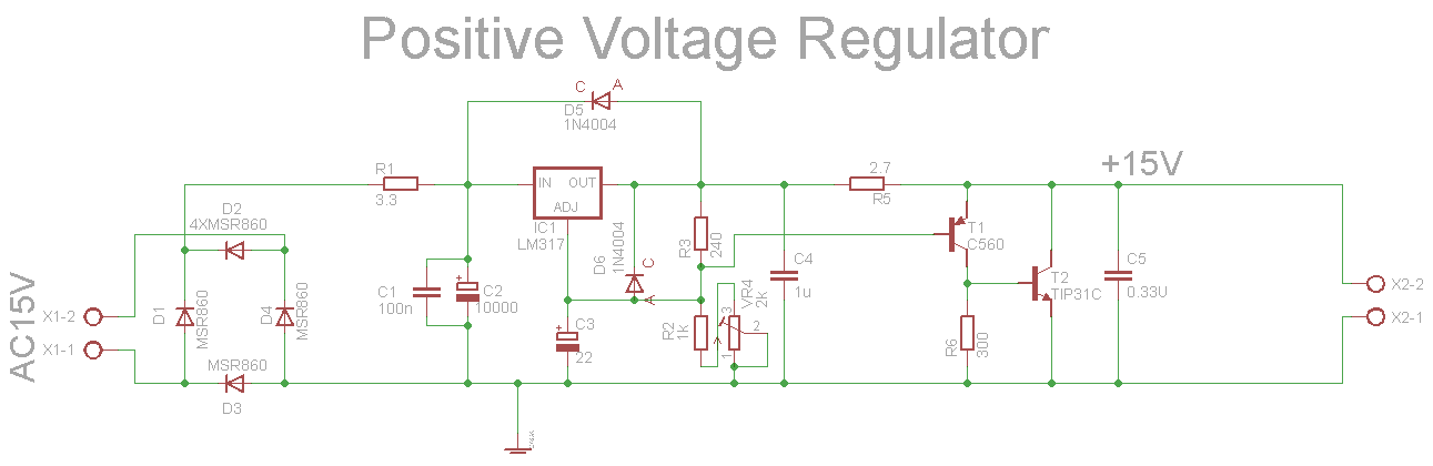

Hi James,
Thank you for your comments.
1. I have not compared Nazar regs with Juma's supply. I did ask Juma regarding PSU for this particular HA and he said any supply thats stiff and regulated would do well. So thats why I went with Nazar PSU.

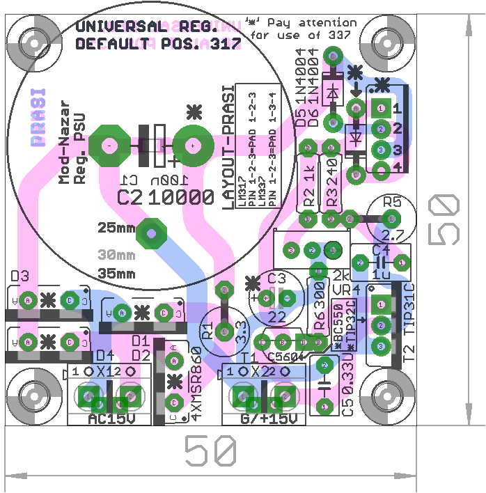

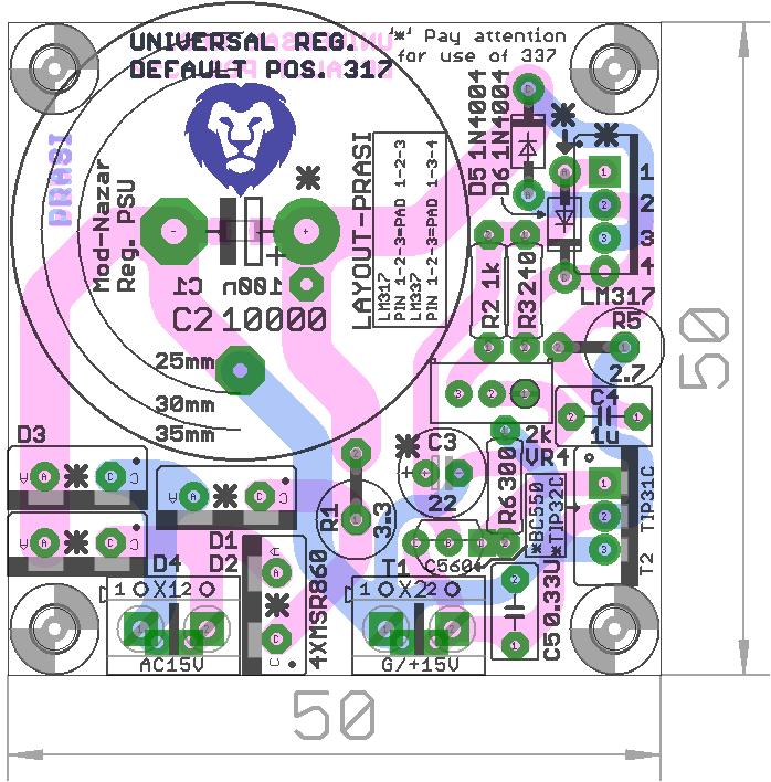

2. I havent sent the boards yet not until I am completely satisfied with layout. I am in process of laying-out a pos/ neg universal supply with Nazar design that I hope would be useful to people here. here is a draft.
Its a co incidence you mentioned grounding for LM based PSU, I had just read the Simple Voltage Regulators Part 2: Output Impedance
and I was doing a layout following the recommendations mentioned in the article. here is a screen shot . still a long way to go, but in right direction hopefully...
However, i feel that ground impedance in50x50 board with short and thick traces would be too small to have any effect.

The second last sch shown with the correct (right) wiring is very important..................... I had just read the Simple Voltage Regulators Part 2: Output Impedance..................
This has been documented by others, probably going back more than 20years and yet it is ignored by most Builders.
The "node" philosophy adopted for the -ve output should also be followed for the +ve output.
i.e. the three attachments to the +ve output of the regulator should all coincide with the output pin.

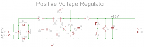

thanks, what about the layout in post 122? does it meet the requirements?The second last sch shown with the correct (right) wiring is very important.
reg
prasi
Nice progress on universal PSU for headamps / preamps. I like the 3-4 pin option so legs don't have to be crossed on the regulator.
here is the sch and layout side-by-side, quite straight forward, tell me if you need clarification on any connection.I would need the sch and the layout.
It would help if the important nodes were labelled.

all thanks to AndrewT😉...Nice progress on universal PSU for headamps / preamps. I like the 3-4 pin option so legs don't have to be crossed on the regulator.
R5 should be rotated 90 degrees clockwise and it's feed should come direct from the output pin of the 317. NOT from the end of R3.
C4 pin2 should connect to the group of three pads (C3 pin-, Vrpin2 & Vrpin3) to make the -ve output node of the first regulator.
This node has to feed to the common node of R6, T2emitter,C5-, output
Note that R6 is directly connected to the last output node, NOT to the first regulator
This all goes wrong from the way we lazily draw the schematics.
We all take shortcuts and use that universal symbol GND for "ground"
They are NOT grounds. They are the other half of 2wire connections. Think through your sch and get the 2wire connections correct. stop using GND. keep your loop areas small. Allow the "stages" to work correctly, by getting the current routes in each stage correct.
Then join them together with 2wire connections.

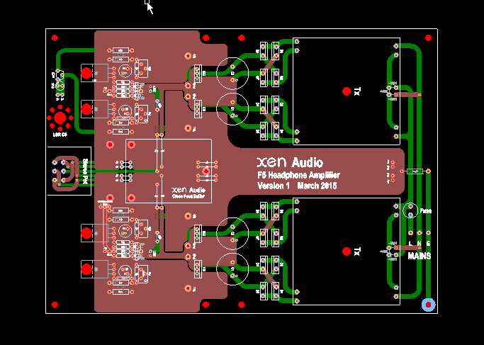

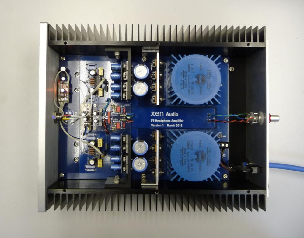

Recalled EUVL showed a teaser of his PCB ... Separate PSU's and transformers make it larger, it can be done smaller with just one PSU (if small is key parameter).
Edit: I added the picture of a multi board version form earlier in this thread for comparison. Please explain what the benefit is of using multiple boards.
If a PCB design like that of EUVL is made with just one separate toroid/transformer and incoming supply lines tied together the board can roughly be one third smaller (or add muting relay + DC protection to protect that valuable cans, remote controlled volume control or whatever). Leaves more choice for the builders which transformer they want to use. IMO the most compact and neat looking, reliable and easy to build way of designing/building but I am prejudiced. Got promoted to chairman by the committee last week 😉
Less drilling and metal work, way easier mounting in a case without the need for a subchassis, no machine gunned bottom of the case but just a few mounting holes, almost no cable spaghetti so no antennas, short paths of signal (except inputs but that counts for both situations) and PSU lines, no 230V mains wiring prone to safety errors but PCB tracks/onboard fuse/possibly PCB mount IEC connector, easier accessibility for easier error finding or measuring, can be designed for a certain standard case to simplify reproduction by builders, power LED straight through front cover, volume potentiometer soldered and mounted straight through front cover, no "I am going to reuse this boards for something else" look. What is there not to like ?

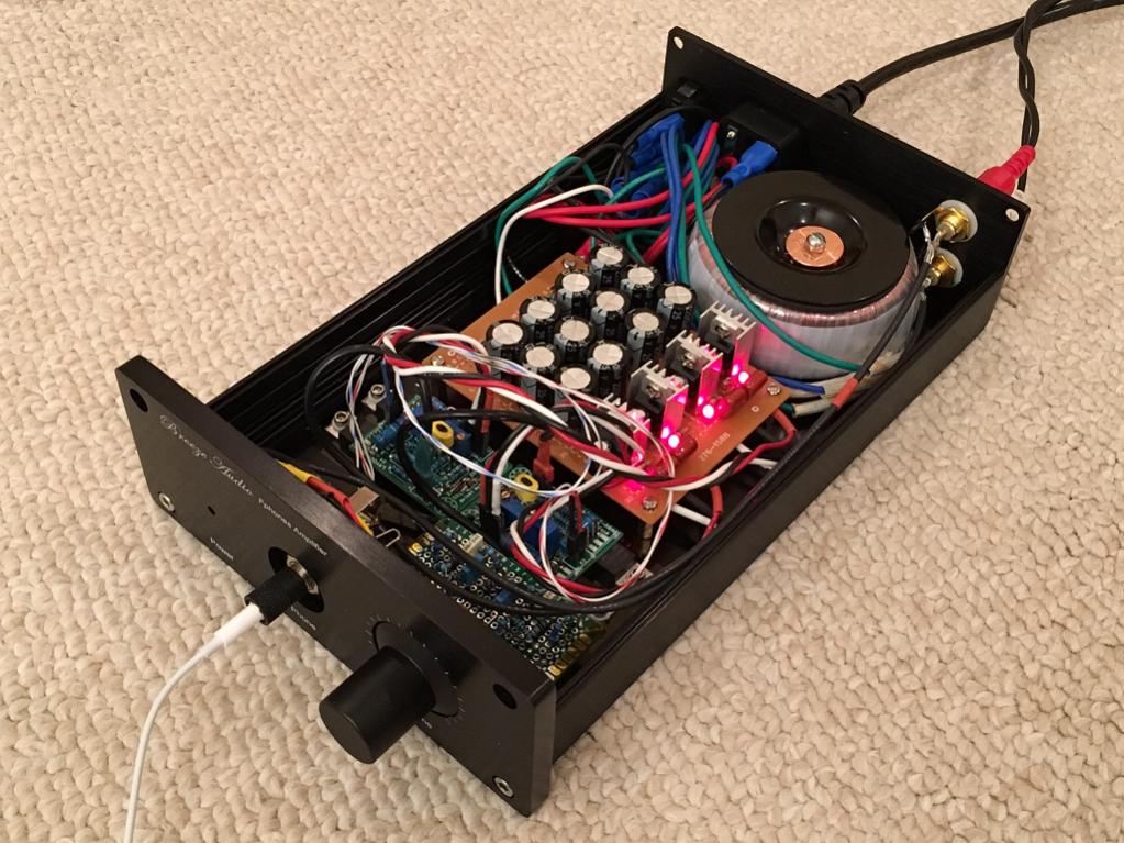

It's because the boards are small and separate that allowed me to stuff this class A amp into a much smaller case than what everyone uses. I used a basic $40 Breeze Audio case vs the much larger ones everyone else uses. The volume pot location was predrilled along with all IEC, RCA and headphone jack holes. If one had the foresight of knowing that this particular case was arranged a certain way one could make a single master PCB. But cost of small 50mm PCBs is $6 for 10. You should check what a 125mm x 165mm PCB costs to make. Anyhow, low cost and flexibility are the advantageous for the DIY'er. For a commercial product with know case a single board absolutely makes economic sense. Just look at inside of a Schiit amp or any other commercial product: 1 board.
