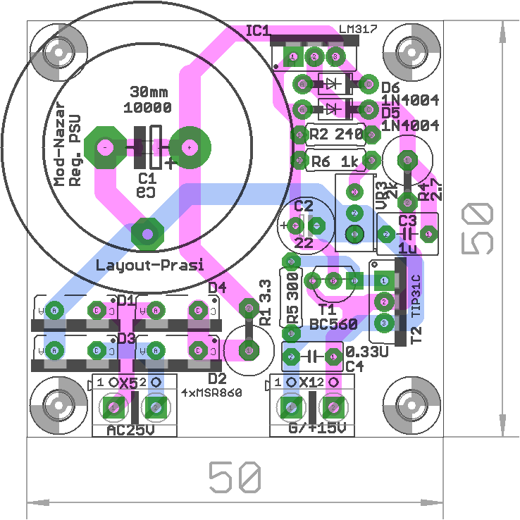

Here is what I could come up with for the reg PSU, like Fred said, one could use D4XH11 or try with TIP4XX or TIP3XX.
For LM and TIP, One could use either a heatsink or mount on the bottom on case or use an aluminium plate as a heatsink. Mounting hole options as per heatsink choice.

here is the LM317 only pcb, if you are done with testing your hack job of the universal psu🙂.
What is the cap size you are using? I have it at 30mm dia and is quite big for a 50mmx50mm job. pcb might need a small support on the bottom where the forth mtg hole is located.
the LM and D44/TIP still have to be mounted on case for sinking the heat. see if you find it useful.

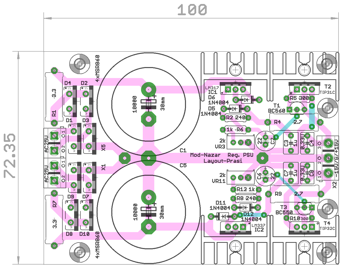

X, yes, you can stack 2 of these (tie the gnd to the +ve of the other) to create a bipolar supply. That's how I plan to use these boards.

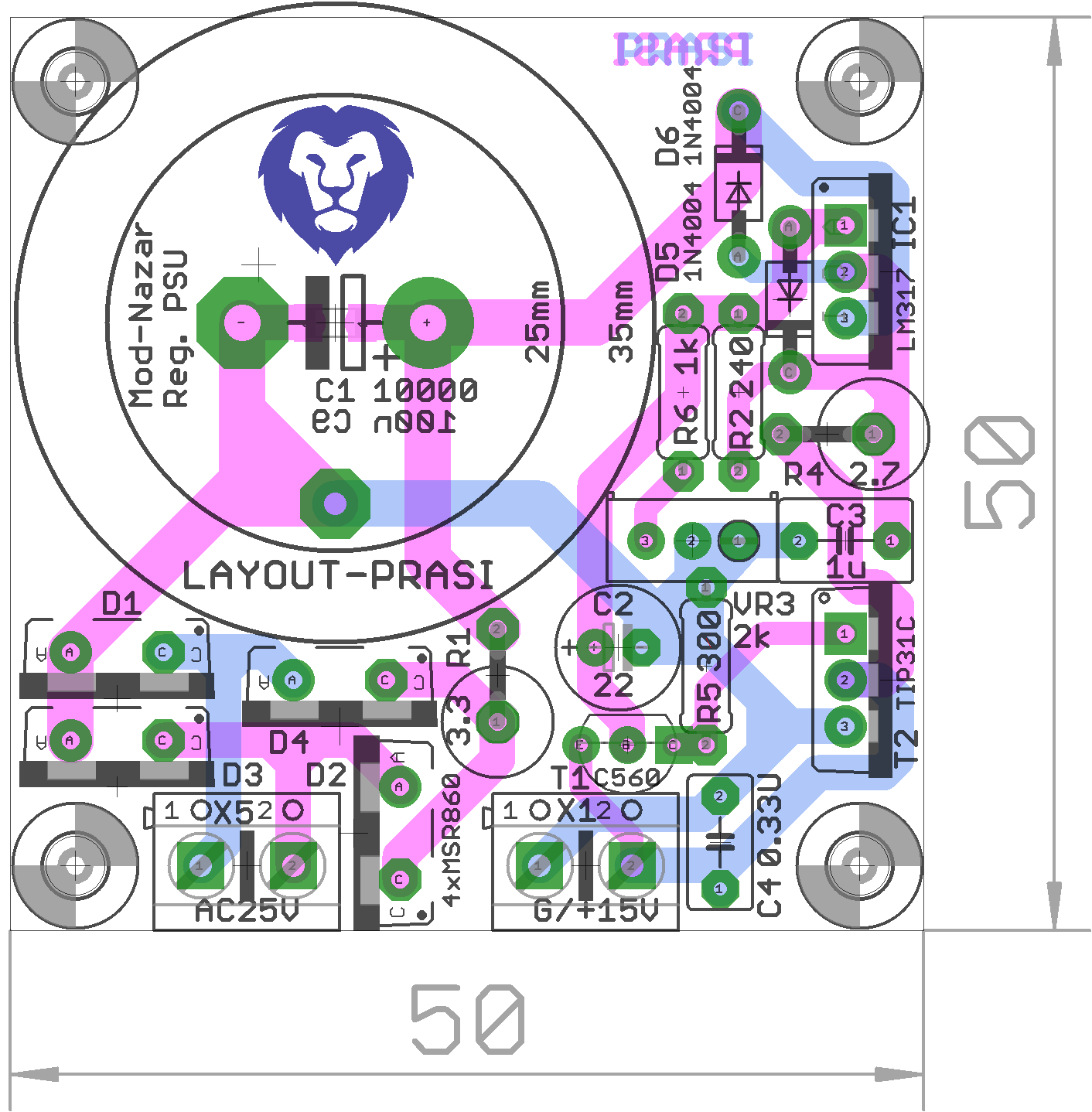

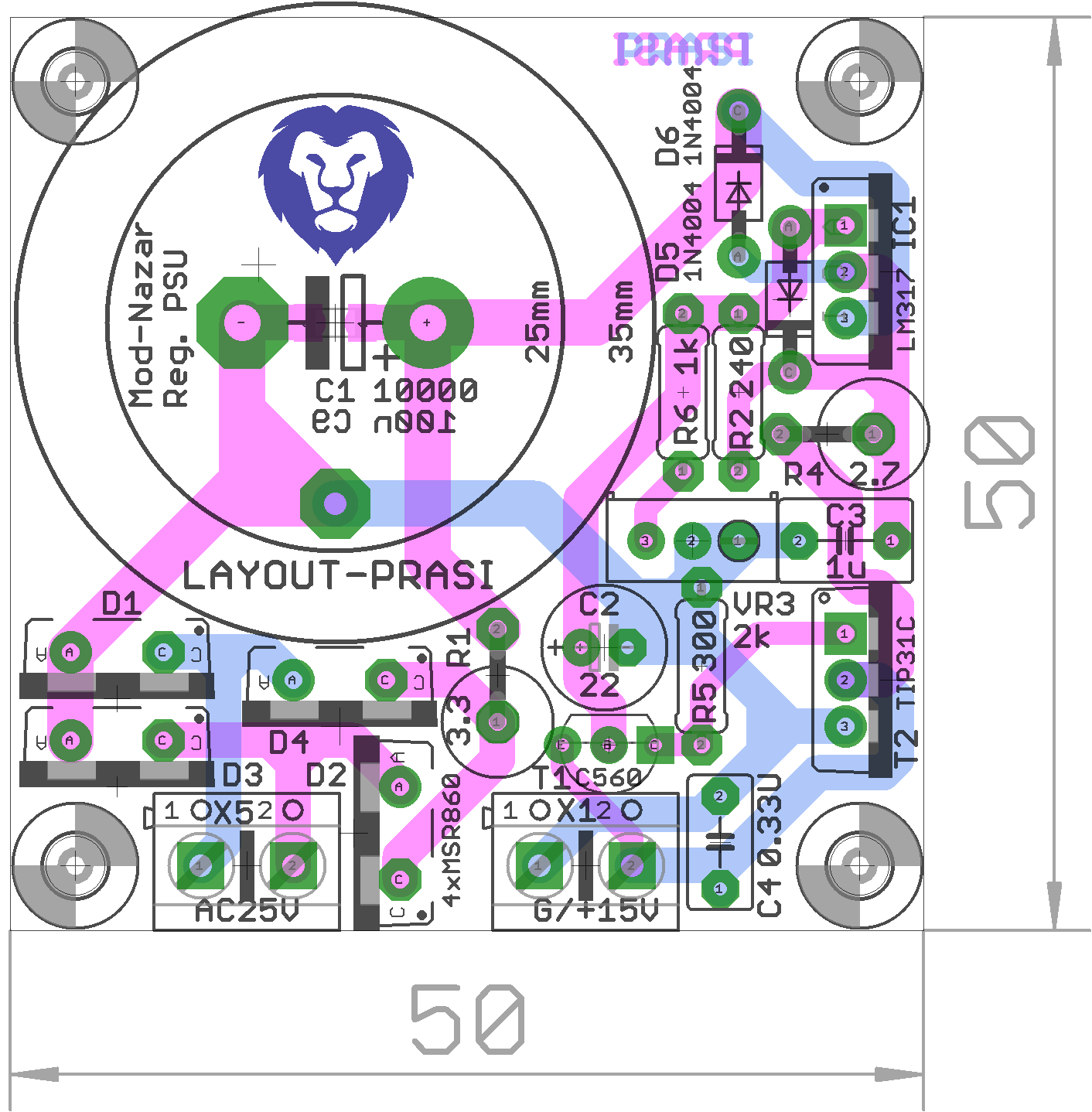

Fred, how about this one, even more cuter😉 and convenient to mount on case wall or main heatsink as both the LM and TIP along the same edge of pcb!!. 25mm cap will fit easily, no probs... with this version, even 35mm cap can be fitted..
just needed to spend some time on the layout

This version neater and can be mounted to the main heat sink.Fred, how about this one, even more cuter😉 and convenient to mount on case wall or main heatsink as both the LM and TIP along the same edge of pcb!!. 25mm cap will fit easily, no probs... with this version, even 35mm cap can be fitted..
just needed to spend some time on the layout...

One observation from my hack up version, the 3.3R can get a little hot for the the BC560 to sit right next to it. I tried up to load to 500mA to simulate 250mA per channel, it was
My gut feeling is that the 1st version may work better in most of the HA chassis because the main heat sink height is not tall enough for 2 to stack together.
For either version, I will move the TO-220 devices out to the edge as much as possible for ease of mounting a heat sink on the side.
Thanks!!
I will just mount the TO220 underhung attached to bottom panel of amp case. Do we really need a 25vac trafo? Would not 18vac be enough to make 25vdc and the LM317 takes to 22v and cap multiplier is 2-3V drop? Still leaves room for adjustmnentonnpot to hit 15v.
One observation from my hack up version, the 3.3R can get a little hot for the the BC560 to sit right next to it. I tried up to load to 500mA to simulate 250mA per channel, it wasI will move the BC560 away from the heat source if possible.
were you using 1W or 2W resistor? with 500mA, Its about 0.825W. The package I have now is for 2W. Also with resistor being vertical, it will help in dissipating heat better (gut feeling). anyway, I have moved it (and the C2 cap) slightly away from the resistor and should now be ok.

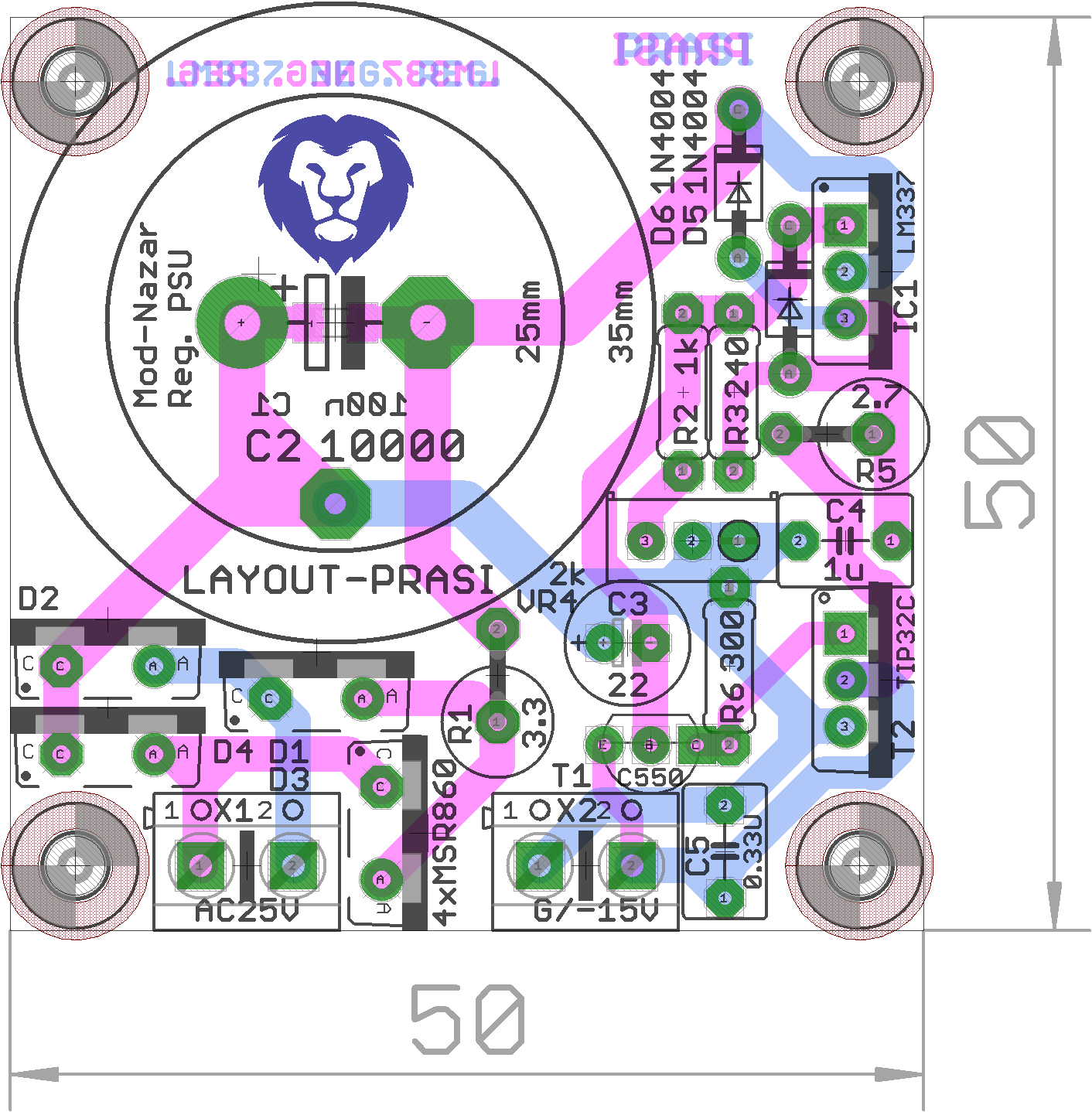

here is a 337 version on the same lines. it seems, one could use the same 317 board and take care of diode orientation, capacitor orientation and LM337 pin config, then same board could be used🙂.
