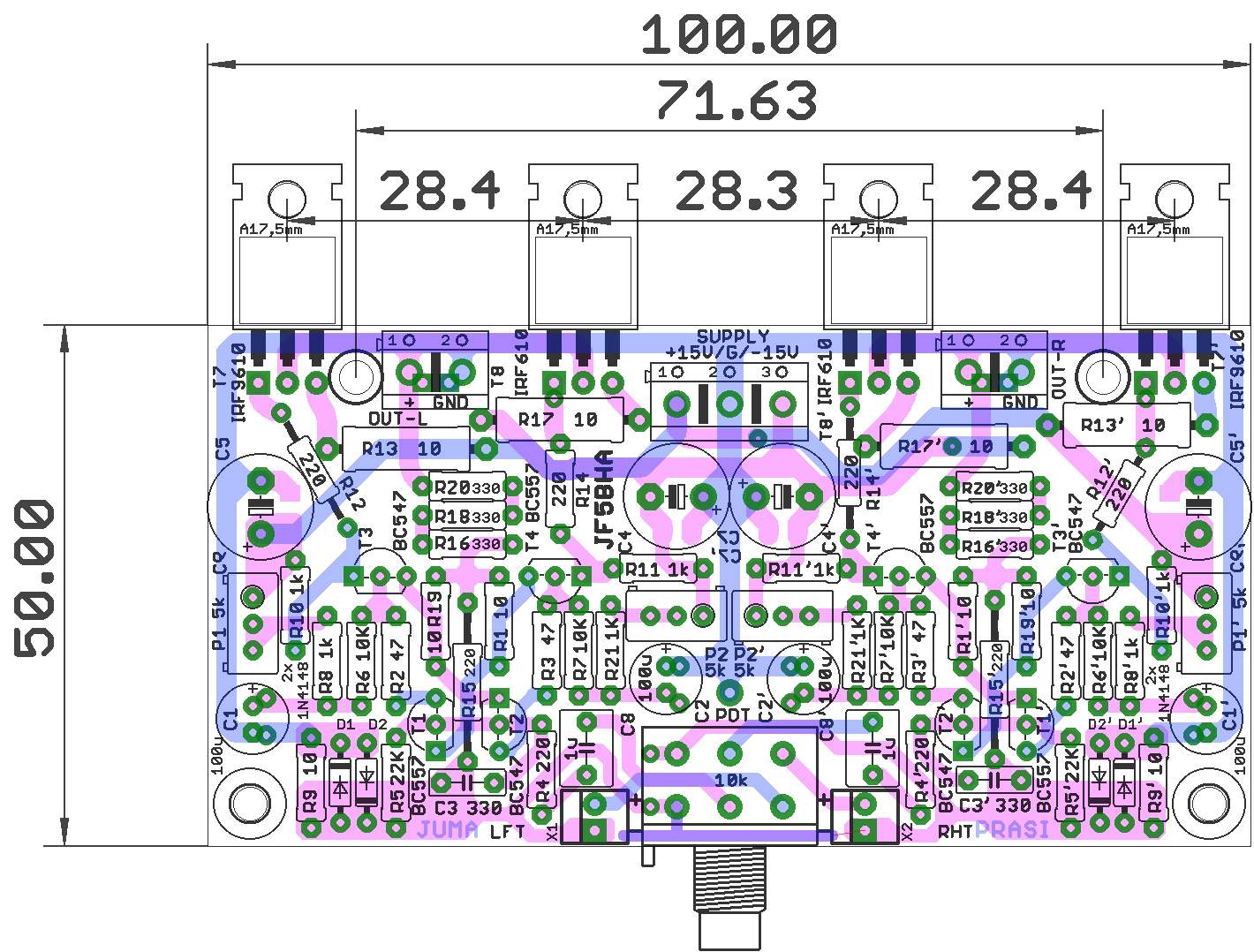

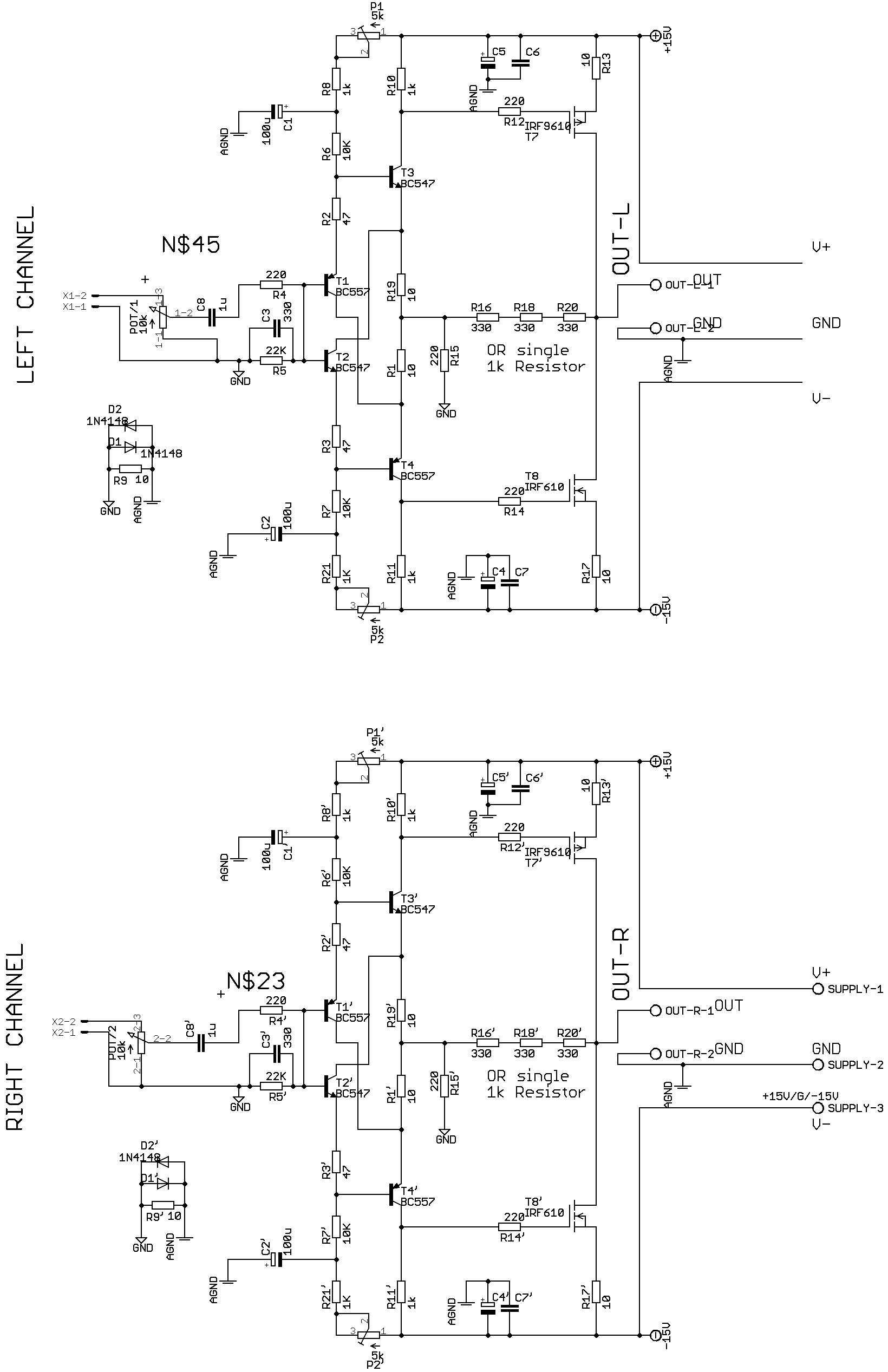

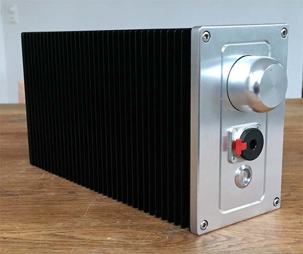

for the nazar psu with the prasi pcb take care of the wrong marked diode (d10) all 4 diodes point in the same direction (d9-d12). i would take 68ohm resistors for r2,r3. i could archive a adjustment range up to 120ma bias (or 1.2v over r13), very stable offset. the adjustment range is narrow, would be nice to be more flexible and get high as 250ma.
i took a first listen with a alps pot (which i don't like) and it's a nice quite neutral sounding amp (a little touch warm sounding, but less then a big f5), post better feedback when a better pot is in.
power output is ideal for dynamic low ohms headphones, wiht 15v it's more a medium-low power amp, likes dynamic headphones better then planar, it's a very quiet amp.

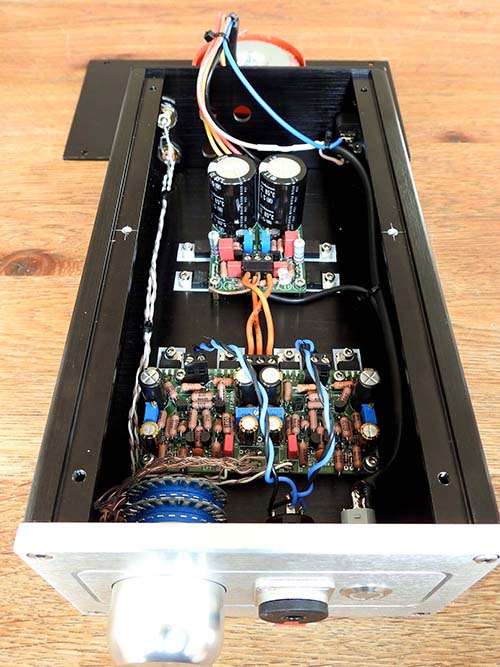

so the potentiometer arrived yesterday and the amp is finished.
had a quiet 50hz hum at the beginning due the small case that was inducted from the trafo, shielding it with some mu-metal was a easy fix. not a new problem from me when you like small cases.
the best pairing for me is with the fostex th-900, gives a detailed sound with a good soundstage, bass goes controlled down but don't touches the super deepest parts (only few amps that i know can do that). the amp is neutral and only a touch of warmth comes with it, so with the fostex which has a strong presence that is a very fine match. more demanding headphones likes planars are ok but the amp is loosing a bit control with these headphones. i would say the amp plays in the leauge of the th-900, above it's a bit tricky. due the nice pairing with the fosex the project is finished for me.
i think the design could deliver more, with my experience i would try to get the bias higher (mine i now maxed at out around 135ma) and let the mosfet run hot. i had amps that gained a lot of authority and easiness setting the bias high.
don't fortget every build is different and its based of personal preferences not absolut truth, one likes sport cars the other limousines 🙂.

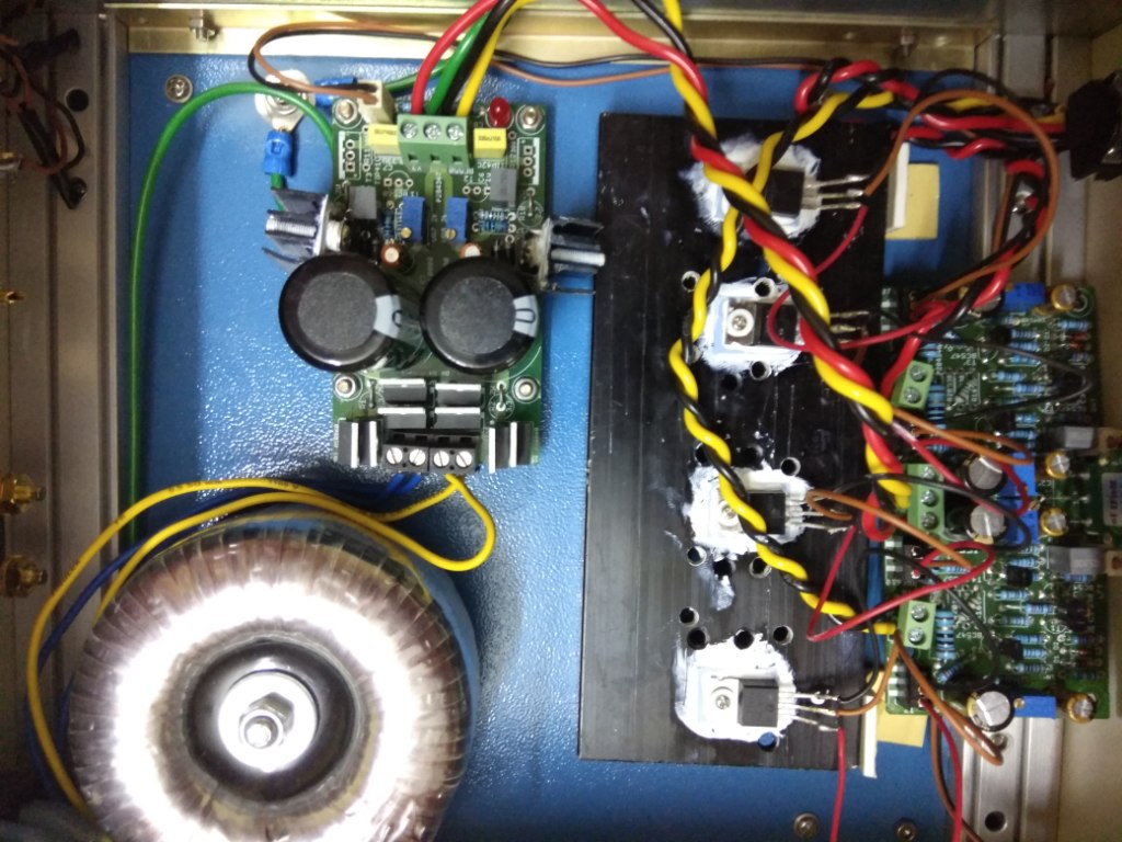

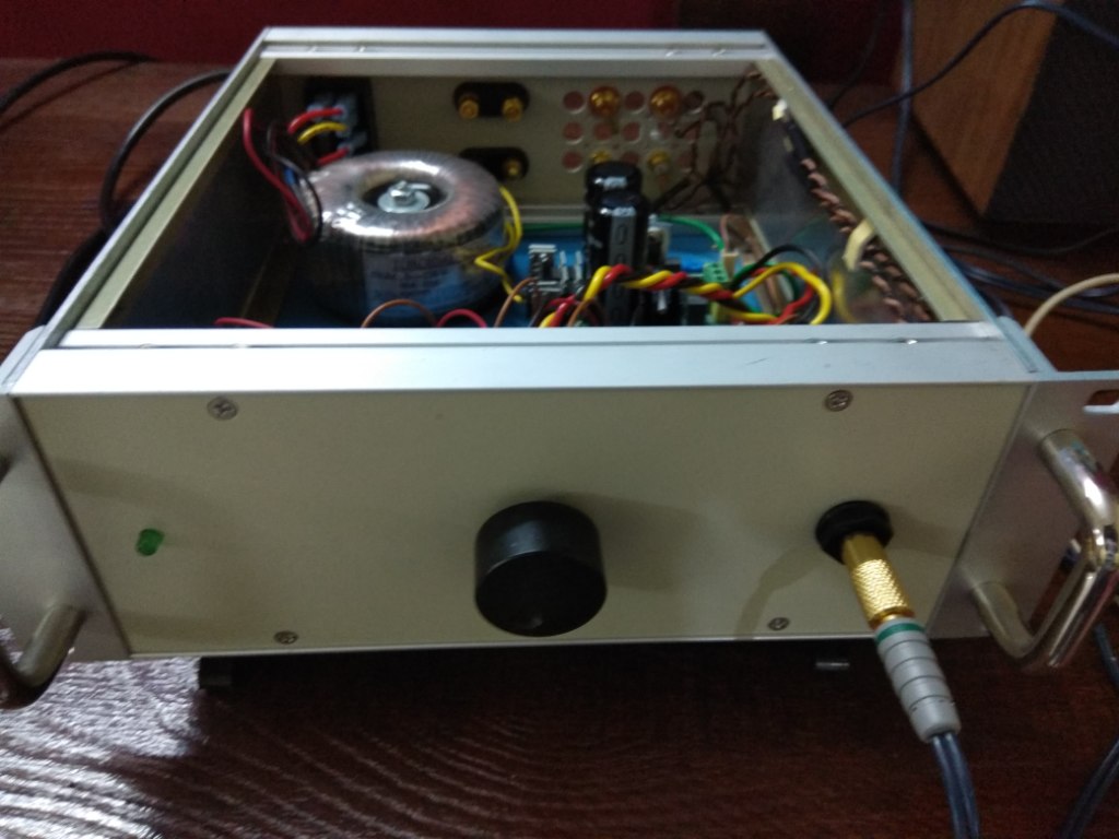

Here is my build of the HA.
Del V across R13 and R13’ is 1740mV and on one ch and 1730mV on other after 2 hours. So hefty bias.
I mounted the IRFP on separately thro wires and that’s why all the wiring.
Heat sink is a bit small for this dissipation and gets hot.
Offset jumps around a bit from -3mV to +6 to 7 mV.
Listened on my sennheiser 25ohm HPs (don’t have a model name/specs as they are quite old, 2009). HPA Sounds good and true but bass is a tad bit less.
No hum/hiss of any kind, PCB designer is a brilliant guy😉😀.
Used a 21 step MFR 10k volume pot, no issues there.
Next on build list is the ESP HPA.
The case is supposed to be a universal HPA cabinet and will probably see a lot different HPA’s and small amps.

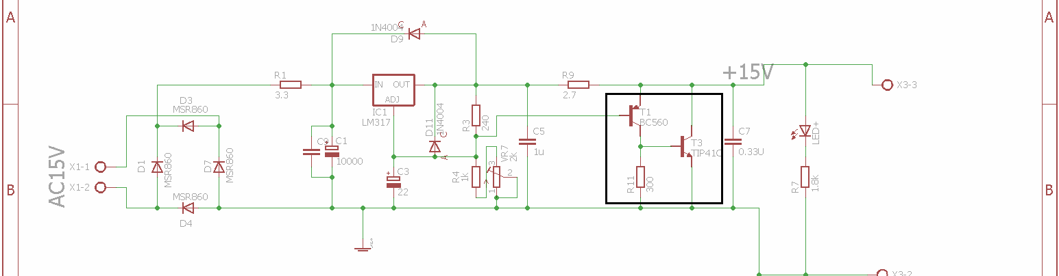

The nazar PSU doesnt use shunt components, so its a plain LM317/337.
