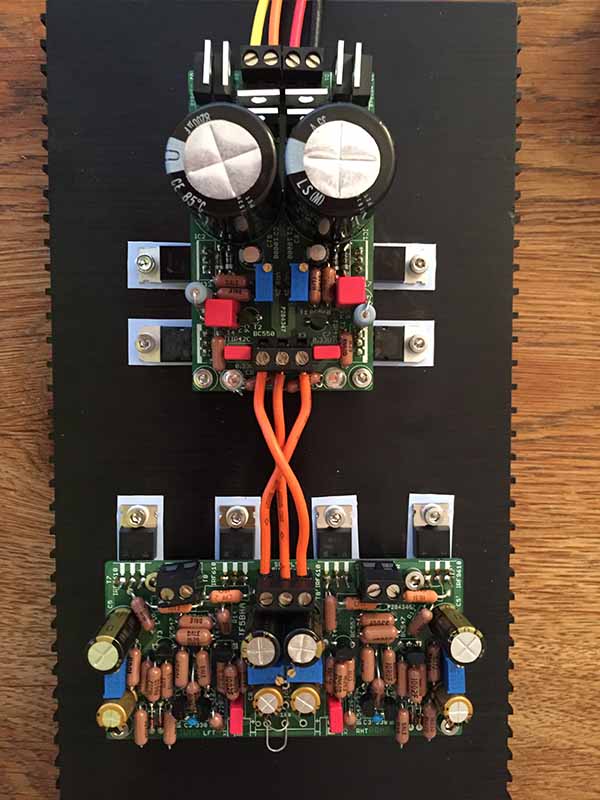

so i understand it right from the beginning, i can't get a good offset, the max bias i can get with the pots is about 1.1 v / 110 ma thats ok, but i get these measurements setting the bias to 0.88 v / 88 ma:
channel a
offset 0.457v
over r2(47ohm) 54.9 ma over r3 (47 ohm) 75.7ma
r8 (1k) 5.05v
channel b
offset 0.348v
r2 (47ohm) 60ma r3 (47ohm) 78.3ma
r8 (1k) 5.22v
the offset rise steady with the bias, starts near 0 both pots closed but jumps to about .170v with a low bias at around 10ma. also the mosfet don't get hot, i think there is a desing problem. measured all the resistors and checked all the parts twice, everything is at the right place (and don't smell bad ;-) ). looks like the amp has start problems. any idea?

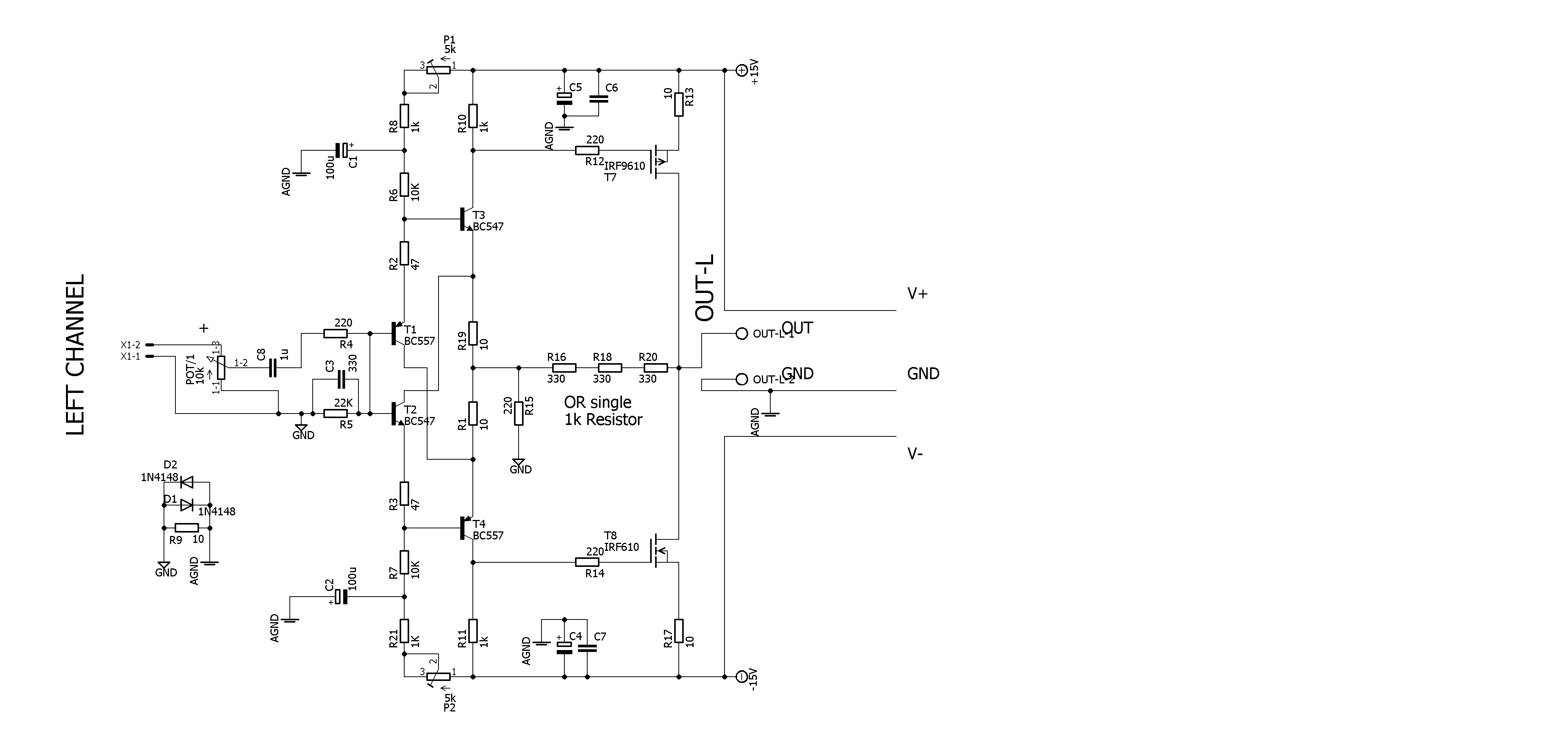

Hi rumina,
Its been tested by atleast two people (xrk971 and e_fortier) that i know of. i think they have tested the mono version and the values were fine tuned (R2/R3) based on xrk's test.
schematic in post #392.

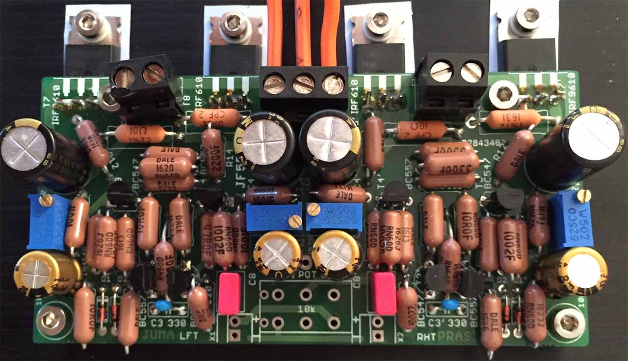

Nicely built, but this pcb isnt designed for vishay RNXX resistors. those are quite thick.
one more thing, are you using 2 multimeters to monitor both Id and offset at the same time as advised by Juma?
care was needed to put the resistor in but they dont shorten other parts, yes i use two multimeters for bias and offset. strange for me is that both channels have the same problem; what would be the effect when i change r2/r3 to 67ohm?

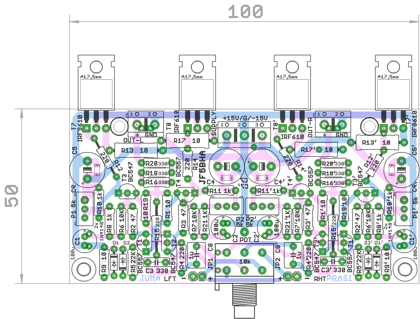

and thanks for the layout, easier to see than the picture of the pcb. i don't understand why i get a offset of 0.2v when the pots ar closed and the bias is low as 10ma. as soon the pcb get power the offset rise up to 0.2v in a minute or two. i think the first stage is fine, is the seconde stage the trouble maker?

no matter which pot you adjust and in whichever direction (ccw or cw rotation), does the offset always stay in positive volts?
whatever resistor values that i could make out from the photo, are correctly located. you could try with a fresh pair of closely matched i/p bc550/560. atleast a DMM match. better would be transistor tester.?
you are using C1 as 1uf and R5 as 100k, right?
Also i/p shorting should occur at pin no 1 and 2 of the volume potentiometer? here is the schema of left channel.

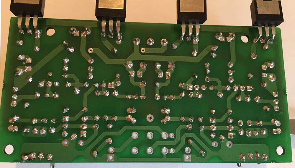

thanks that you take time for me, i don't think i have shorts or cold joints, i always clean the pcb with isoethanol and check the joints. happy when you check the picture for yourself.
i took the chance of a stady hand in the morning and removed the bc547/bc557 and took a octet of matched bc550/bc560 in. i set the pots to 2.5k and get these results:
a
offset 340 mv
r13 127mv
r17 132 mv
b
offset 341mv
r13 150mv
r17 154mv
now with the machted set the measurments for npn and pnp and for a and b amp are similar, so i think the bc550/bc560 are fine. i ordered some irf610/rf9610 and change them tomorrow. also i think the pot could be 10k. the resistors are placed like printed on the pcb, i checked them 3 times now, i don't see a mistake in soldering/placing the parts.
ps the two c3 330pf are missing in the picture, had some trouble once with the one i have and desolderd them today / ordere some new one (don't think they have a great effect on the offset ;-) )
