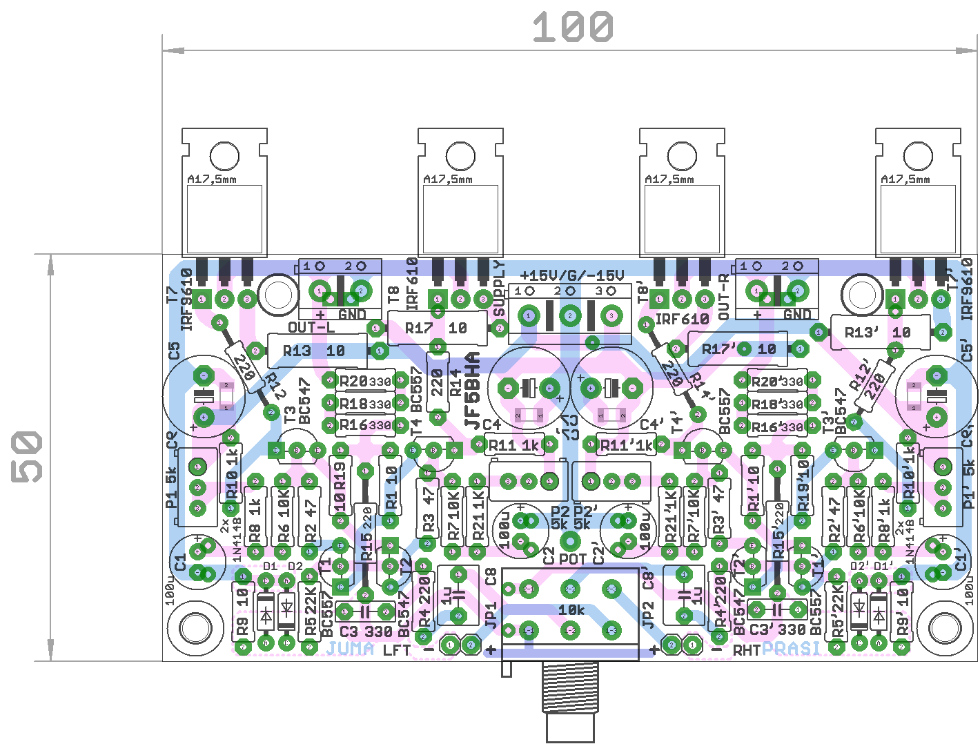

i took the chance of a stady hand in the morning and removed the bc547/bc557 and took a octet of matched bc550/bc560 in. i set the pots to 2.5k and get these results:
a
offset 340 mv
r13 127mv
r17 132 mv
b
offset 341mv
r13 150mv
r17 154mv
now with the machted set the measurments for npn and pnp and for a and b amp are similar, so i think the bc550/bc560 are fine. i ordered some irf610/rf9610 and change them tomorrow. also i think the pot could be 10k. the resistors are placed like printed on the pcb, i checked them 3 times now, i don't see a mistake in soldering/placing the parts.

the new irf610/9610 arrived and it looks much better, with a simple transistor tester i have a 2 pairs with vt 3.72volt and 3.76 volt. i checked the old the mouser one and the where 3.74 volt and 3.54 volt.
the new one behave fine and i can get a stable offset around 0 like i used to see. only thing to solve is that i can't get higher then ca 0.5 volt bias. p1 is at this point ca 2 ohm and p2 2 kohm.
should i change r10/r21 or should i try to change r2/r3 to 68ohm? was the idea to lower the r2/r3 because to much stress for the bc550/bc560?

before changing the resistors, can you post the measurements (del V) over
r2/r3
r10/r11

runs stable since 1 1/2 hour so i could get good measurements:
a
bias 51.5ma
r2 59.7mv r3 51.6mv
r10 4.72v r11 4.87v
b
bias 48.6ma
r2 59.9mv r3 49.7mv
r10 4.62v t11 4.83v
this i with the pots max out , offset floats +/- 0.4 mv thats perfect
would be nice to get a bias of 80-100ma (0.8-1v), the heatsink should thake

With 68 ohm as per original schematic , bias can be adjusted easily above 150mA. Mine is set at 100mA because my heatsink is too small for 150mA.

Sorry I forgot to mention and ask your latest resistor values.
The mentioned del V determines the current thro first stage and second stage...
first stage should be 1mA and second stage should be 4-5 mA.

at the moment every part is like in your bom list. i will test 68ohm for r2/r3. stage 1/2 are fine with these measurements, i read the 107 pages from the f5ha thread twice and looks ok to me. will to this work next week.

mouser was fast, the 68ohm resistors are soldered for r2/r3 and now everything is perfect. have a bias around 100ma and the offset is stable floating +- 0.4mv after 2h. i didn't need to change r10/r21 to get the bias down to 0v. amp gets warm but verry moderat due the big heatsink. now i have to wait for the 10k poti to arrive.
would like to thanks prasi and xrk971 for your help. sorry for my laziness didn't match the mosfet, often the adjustment range is big enough for a 2 mosfet design, learned something new. sorry prasi that you get troubled asking questions for me.

Just curious, why did you change R2, R3 value ? Like I mentionned in my post no.503, original schematic was using 68 ohm.

i couldn't get the bias higher then 50ma with r2/r3 47ohm, with 68ohm the range is perfect for the recommend 50-100ma, can go up to ca 130ma now.
i will post my expierence with this amp as soon the pot is mounted and 100h passed (i let every amp run in when i know that the thermal stability is ok for this time to test the circuit/parts and to settle the components). i build this amp because i'm a great fan of my pass f5t, with the toshiba transitors and thoshiba mosfets he sounds great, quite similar to a ksa100 or ksa5, detailed, warm with a great flow of music and a little bit of extra bass. since i buyed a ksa100 over 20 years ago i'm addicted to this sound signature.
