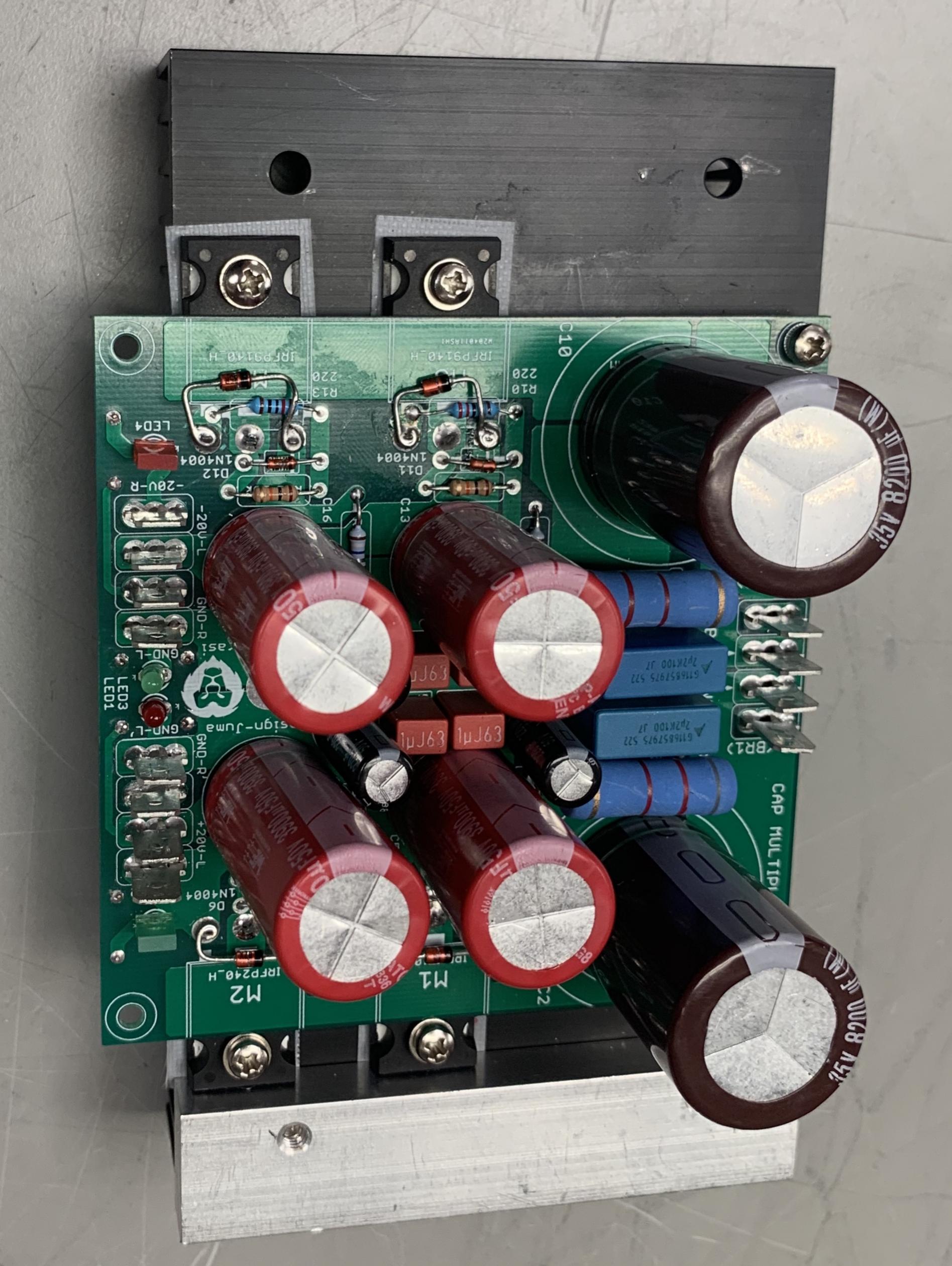

This is great forum and has been very helpful. I just order some W204011ASH1
W61084ASN2_juma cap multi boards from PCBway! I am planing to modify one of the boards by adding a TL431 to add regulation and compensate for the difference in the Vgs of the mosfets.
I have one question about the original design. Do the diodes D1, D2, D4 and D5 eliminate the need for zener clamp between gate and source of the MOSFETs?
In case of a short circuit, C2 is going to discharge through the reference pin of TL431 and maybe destroy the IC
Actually that Zener I was asking about and the addition of resistor can provide simple over-current protection.

hmmm, I briefly ran the cap Mx with my Pass F4 and the heatsink that the Mx MOSFETs mount on got to about 120F/49C. The current draw from the Mx is about 5 amps total. I have a feeling that the Mx isn't going to work in the F4...
Hello Shawn,
Is it the Juma Cap MX?
In that case try estimate the heat dissipated per mosfet by current through a given mosfet x 4.5V approx.
This will allow to estimate the heatsink size required.
Anyway there is BJT Cap MX by M. Johnson/ Gtose that has much lower voltage drop.

After the CRC. But CRC doesn’t have to be so big. Just 15,000uF // 0.1R // 15,000uF should be plenty.

yes just use IRFP240 and caps with sufficient voltage rating
Will I need to use a zener in place of the diode?
