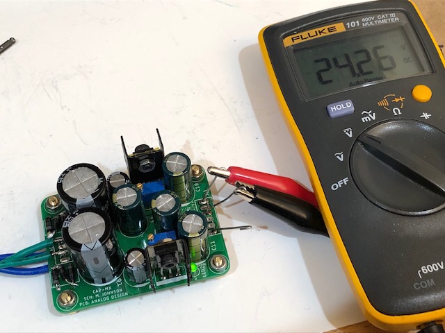

Here is a photo. Of note, first time I ran across a fake BD140. Upon power up, I heard a pop and then no LED light. The positive rail was fine. To be safe, I replaced the BC860 and pulled the BD140 to test it on transistor tester and it was dead - appeared as a diode. I cracked open the case to find a teeny tiny die - no way 1.5amps can flow on that. I had some BD140’s from another vendor and looked carefully at package. Both laser inscribed with NXP BD140 and a date code. But good one has tiny numbers cast inside the little divets on the face whereas fake are plain. Can’t remember where I got these from...
After putting good BD140 in place it fired up and works fine. The voltage range is smoothly and finely adjustable. In a way, a great way to have a variable voltage low ripple PSU. It’s not regulated in the sense of feedback, but gives you choice of voltage setting for steady Class A loads.
These boards are really handy to have around and are proving to be very quick and easy to build. Definitely a nice PSU to have around for small preamp or HPA projects needed quiet dual rail service.

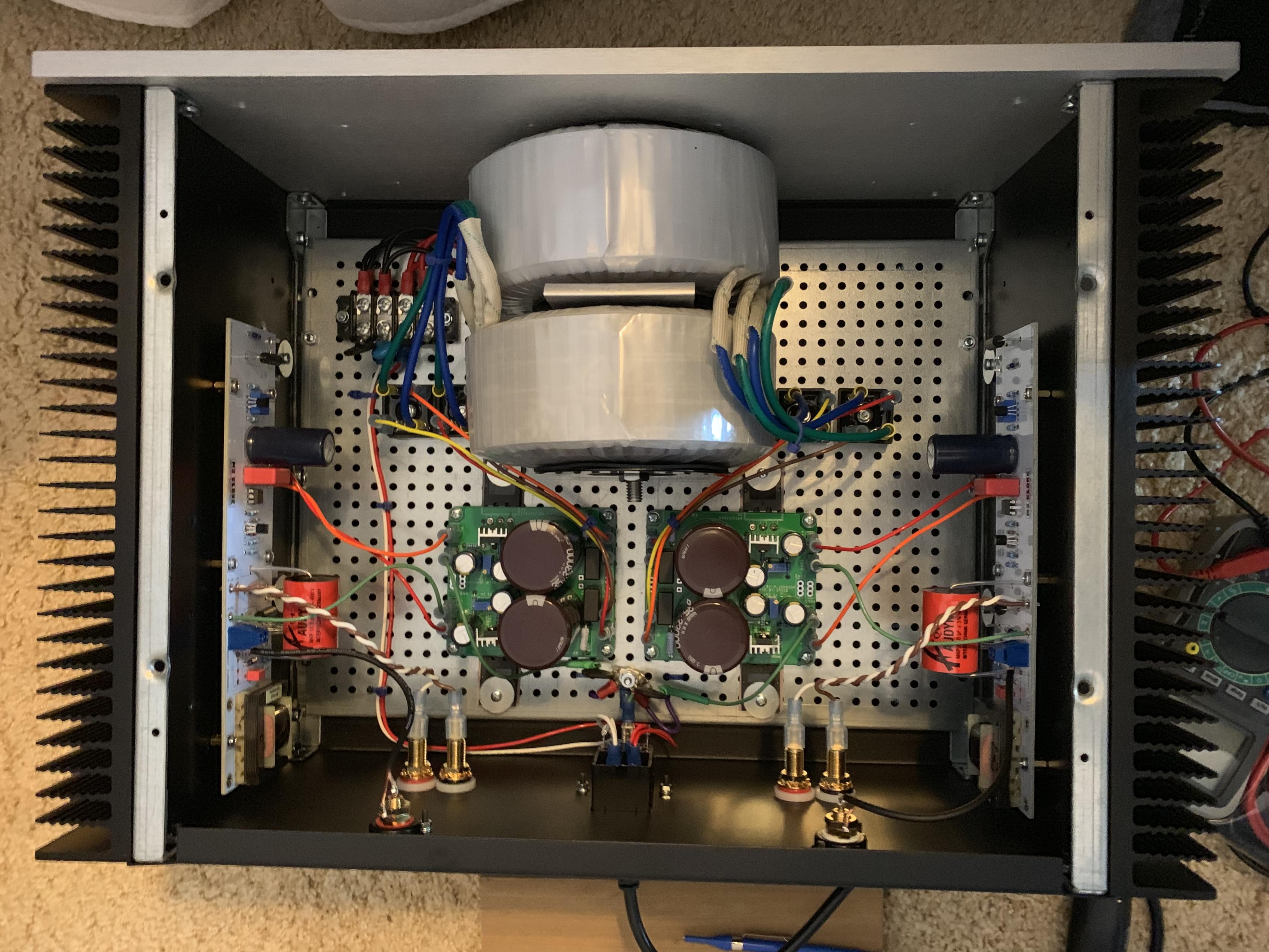

I was able to fix the shorting problem with one of the Cap-Mx in my FW M2C, and put everything together. I did purchase another transformer based on X’s recommendation, and I have no hum. I’m using 20v 400VA transformers, so I have no promblem providing the 23VDC recommended for the amp. The big caps are 33k uF that I had in my parts bin.
Thanks for everyone’s help. The DIYA forum is a great resource and the people are great.

Congratulations, BRN. That looks like a nice build. Seeing that I'll get to my own M2 clone build someday, I have a few questions and comments.
The case looks like a 3U or 4U 300. What is the temp like with lid on?
I suppose 2 x 200VA transformers will be more than adequate for the M2, don't you think (in hindsight)?
I'll definitely look into using 2 Cap Mx's as well.
It's really great to know that you have no hum. What is the sensitivity of your speakers?

I’m using the Deluxe 4U 300 steel chassis.
I would recommend 300VA transformers as the minimum rating. This is based on my reading in the forums.
I have not measured the temp, but I can touch the heat sinks and lid.
My speakers are 92db, and I’m running subs and sub amps off of the M2C speaker outputs.

Thanks for the answers, BRN. This should really go in the M2 thread, but I saw too late that you posted there too.
One 300VA toriod (preferably 400VA) is specified for a stereo M2. 2 x 200VA = 400VA combined.
It's easy to say 2 x 300VA is the minimum rating (if I understand you correctly), but cost is a problem for some builders.
As I remember a rule of thumb is: transformer should be rated at least twice the dissipation of the Amp. So I think 300W is minimum for M2. 400 W is not wrong. More might not be needed.
I’m no expert, but that makes sense since your only driving one channel. I already had the one transformer when I was going to build the amp with just one.
