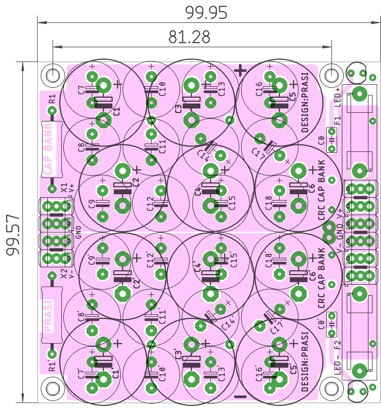

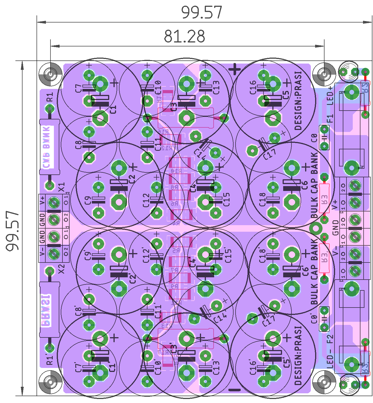

Ok. which one would be a better?
1. CM+ CRC (CRC Power Supply (Class A amplifier))
2. CM+ Bulk cap (100W Ultimate Fidelity Amplifier)
3. CM+Bulk cap converted to CRC
If you are interested to build this one, I can make a quick mod to the bulk cap PCB to act as a CRC.. A number of 1W parallel 2512 SMD resistors will go on bottom to serve as CRC resistor...like the idea??

Hi Prasi,
I forgot all about the bulk cap bank you made. That would indeed be a neat approach. What is maximum capacitance one can expect for 50v rated caps on this board? 1000uF 50v caps are dirt cheap. So I am assuming it would become a 8mF / R / 8mF? 2200uF caps would bring that to 20mF / R / 20mF. I would go through hole 3W 0.22R if you have room for it. Those big SMT resistors are expensive.
But thinking about it more I think I am leaning to just an abbreviated Project16/Prasi layout as CRC would be what I think is useful as I know the board layout is very good.
Thanks,
X

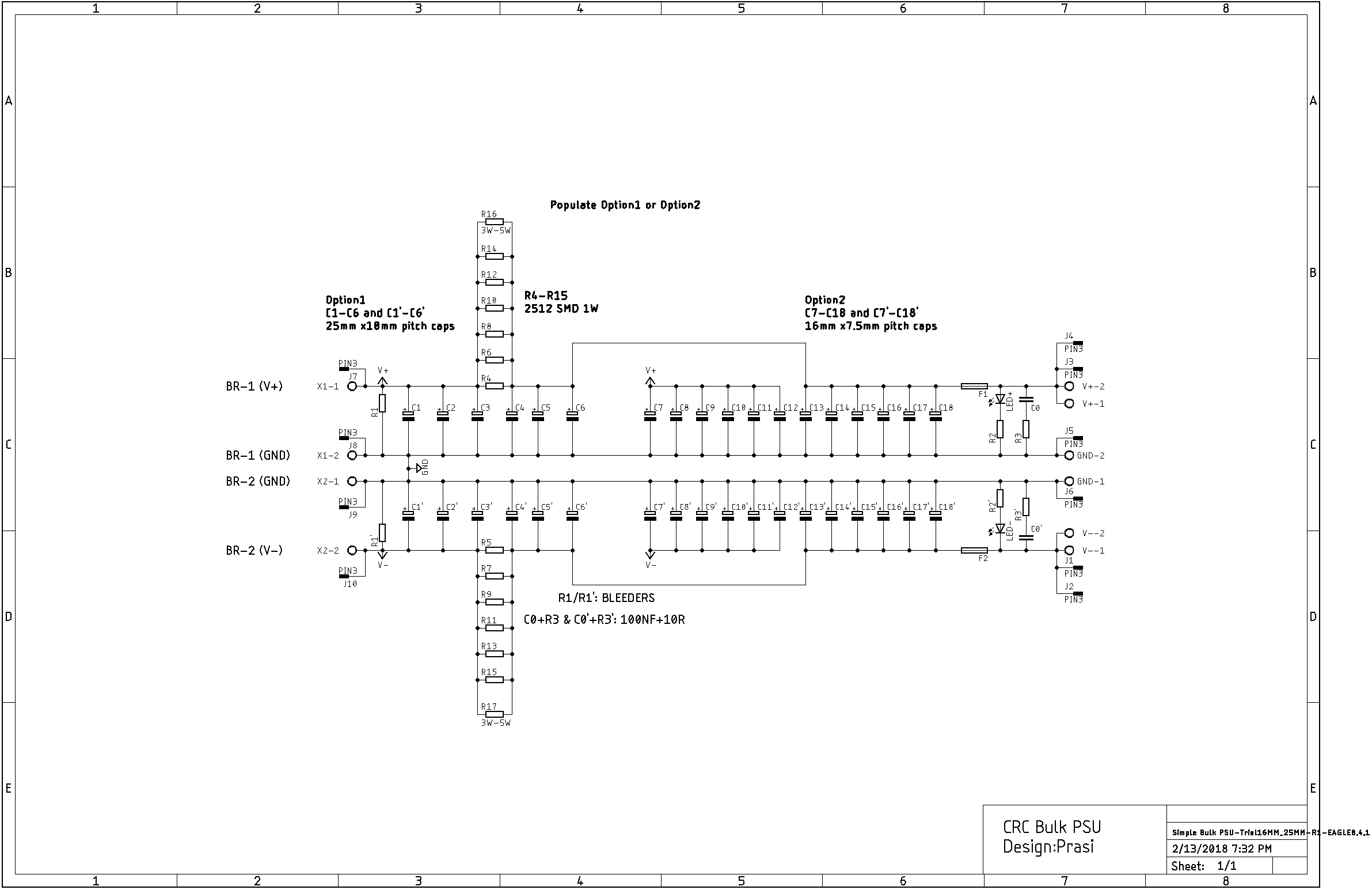

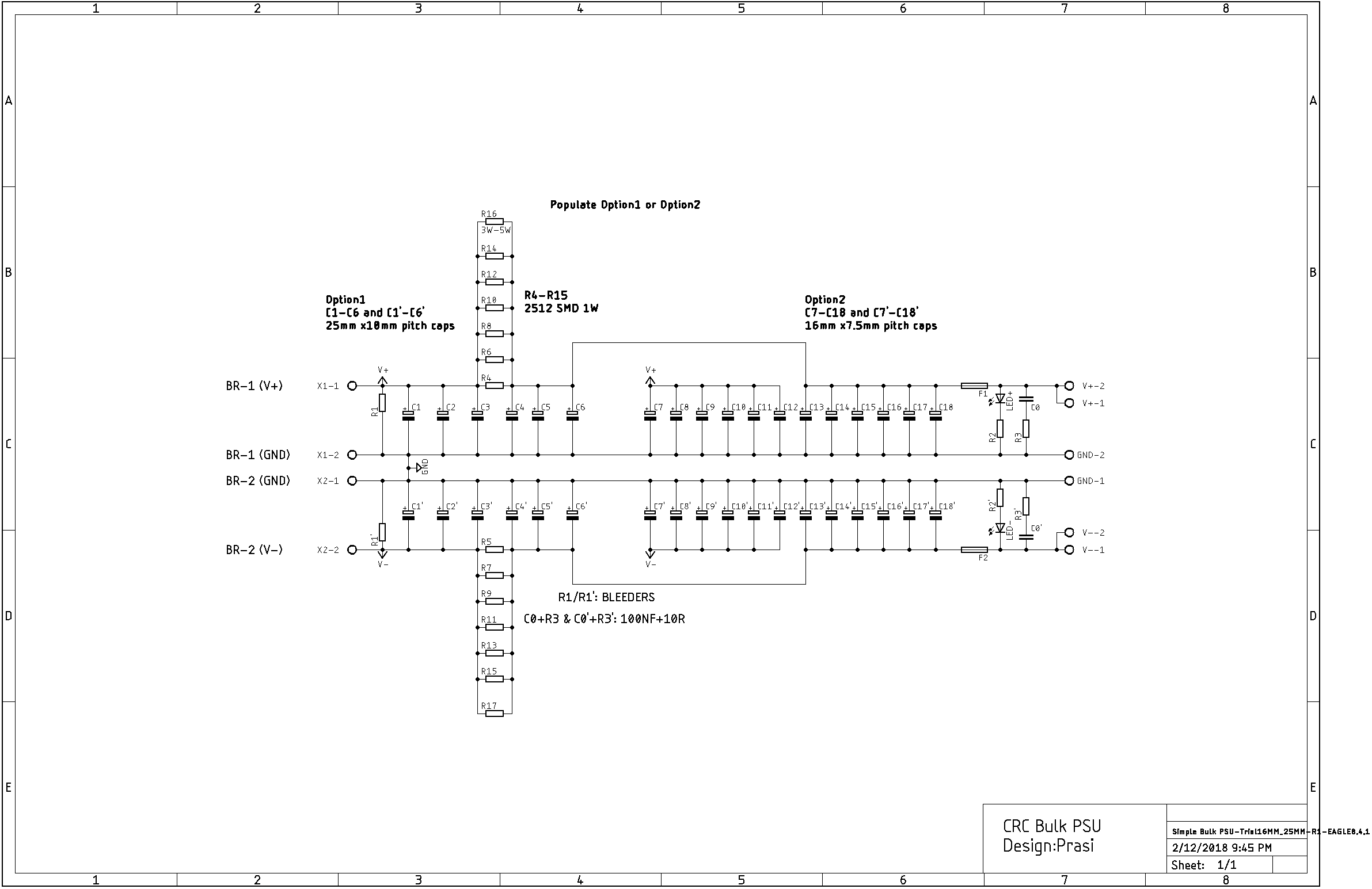

2200uF 50V with 16mm would be 13200u+R+13200u each rail.
I can fit 0.22R3W on bottom if you like it...

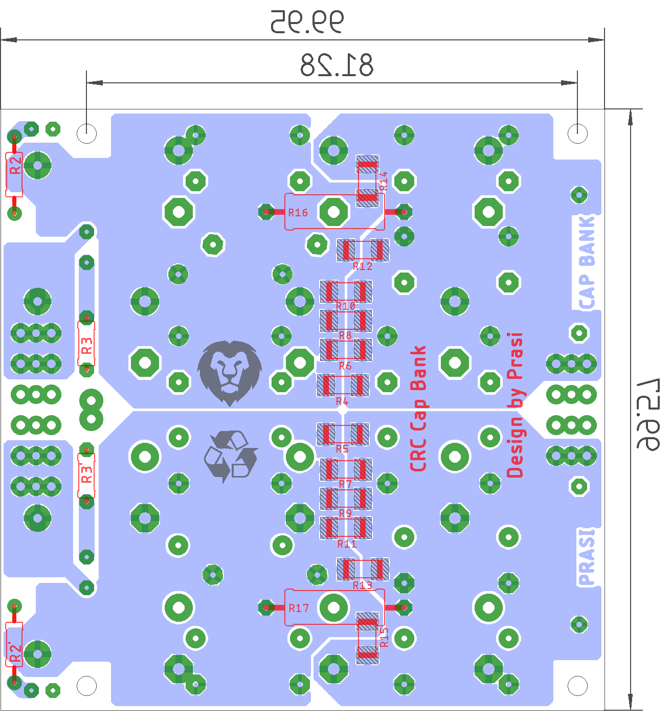

something along these lines...
The red outlined components mount from the bottom. One can take a pick between 2512's or a single TH resistor. I have used this technique of SMD CRC resistors and planes before and works like a charm.
I can keep Grounds of + and - rail separate if this PCB is used in conjunction with the Juma CM, as it has a star.
regards
Prasi
regards
Prasi
This looks very good Prasi.
I think I would like the bulk cap bank ground connected ONLY at the output (lower ripple clean GND) side of the cap bank at the output spade terminals, otherwise unconnected upstream. It has to go to the amp as a common ground from the cap bank as the amp is only 1 GND wire. The sub 100mm dim makes it very cost effective too.
Thanks,
X
Thanks,
X

with these it would be 20400uF+R+20400uF per side.
To x,
I have kept 3W/5W resistor on bottom side of PCB. This would need the resistor to be mounted at some distance from PCB as well as cabinet.
This in turn would mean using longer mounting spacers say 15mm.
dia of TH CRC resistor 6mm+ distance from PCB bottom 4mm+ distance from cabinet/chassis 4mm= 14mm.
Or better option is to use SMD 2512 1ohm 1W resistor, giving a total of 6W dissipation capability with equivalent resistance of 0.167ohm.
regarding your comment on connection of ground on output side, if there is an upstream Juma CM whose grounds are connected towards the output. How would that affect the working. would it make a loop between CM and CRC ?
1st image is the view from top
2nd image is the view from bottom.
6800 uF 50 VDC Aluminium Electrolytic Capacitors - Leaded | Mouser India
To x,
Nice work Prasi!
I like the SMT option - I have done that with a bunch of 0805’s in my amps for source resistors.
Let’s keep the grounds separate with provision for jumpers at either end to be provided by user depending on situation and appearance of ground loops.
