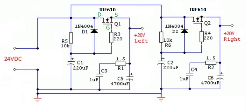

Slow ramp up
I've noticed the cap multipliers on my ACA's ramp up the current real slow - something like 30 seconds, iirc. Which component/s can I change to get faster ramp up to full current?
I've used the values shown in the schematic below.
Change R5 and R6 to 1k or so.
And please stop spreading the confusion by repeatedly showing that schematic drawing - IRF610 can not be successfully used to supply ACA or any other power amp, it's good only for preamps and headamps.
Thanks for the advice Juma.
And sorry for posting that erroneous schematic. Didn't realize that I have posted the one with the IRF610. I have now deleted it from my computer. 😱

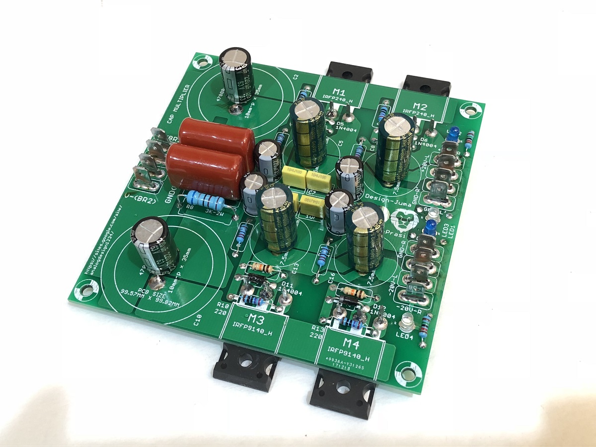

A little OT-Prasi gerbers
I like to import gerbers in to Diptrace, which is what I use, and I can't seem to import the drill files. Prasi's designs are excellent but sometimes I like to put them in Diptrace so I can change component sizes for parts I already have. Any idea how to import the drill file Prasi uses to Diptrace? You can move this if it's not in the right place.
Hi Ripcord,
I dont use diptrace. So will not be able help you.
I could get you the files imported into sprint, so you could have a sprint layout file ready for editing.
You could contact some of the dip trace users that you know who are willing to help you.
regards
Prasi

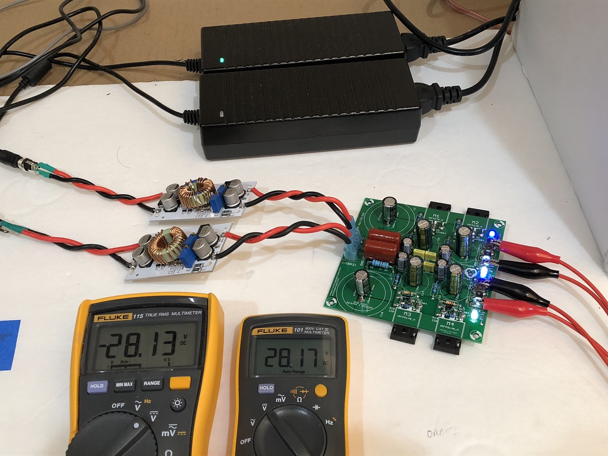

I just built up the Prasi 100mm square dual rail, dual channel layout. Under no load conditions and testing with a 10amp DC-DC step up as input. Will use it to feed an off-board CRC filter so small on-baord caps are used. This may become a nice adjustable (20v to 35v) dual rai voltage regulated high current PSU for my ALPHA amps.
attachment.php
Here is some initial testing for +/-28v output, still need to add output CRC filter.
attachment.php
661956d1518421308-aksa-lender-mos-hybrid-aleph-alpha-amplifier-cap-mx-build-alpha-jpg
661957d1518421308-aksa-lender-mos-hybrid-aleph-alpha-amplifier-cap-mx-build-alpha-test-28v-jpg
More here:
Aksa Lender P-mos Hybrid Aleph (ALPHA) Amplifier
Theese are non isolated.
How you manage to solve the common gnd and safety earth connection(two smps using main earth & - connection)?
