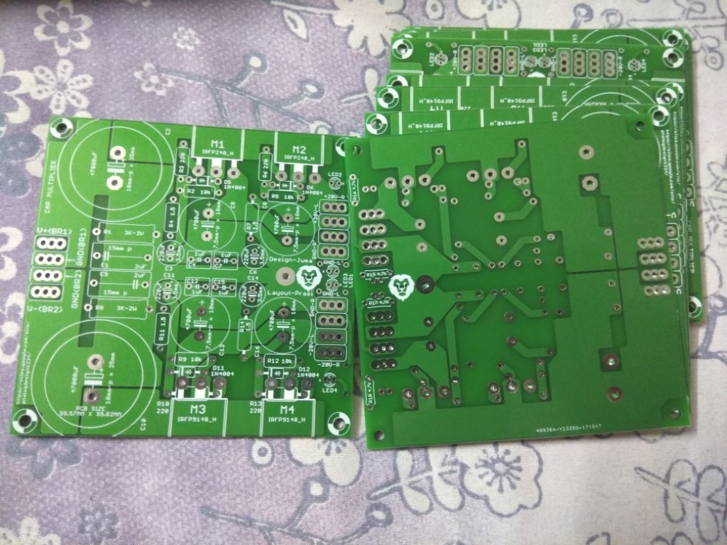

If you do order some boards, could you add an extra 2 boards for me too?
Agreed...I MUST have a couple of boards of this Prasi layout as well.
PLEASE add me to the list.
Not sure I am going to do a GB here as these are handy boards to have so I am going to hoard all 10! 😀
Besides, you guys have the Gerbers like me - just order it from EasyEDA, PCBway, Seeedstudio, OSH Park, etc. $22 for 10 shipped to US. Prasi did a great service for us by making it all fit on 100mm square for big price discount.
easy eda PCBs are very good and I got a pen as a gift😛
How big the heatsink should be for an input voltage around 25-27VAC? Curent threw a fet will be arround 2,5-3A feeding jlh high power amp.
Those look real nice Prasi. They will save a lot of $ in cost of big fat 33mF caps (usually 8) normally needed for a low ripple Class A PSU.

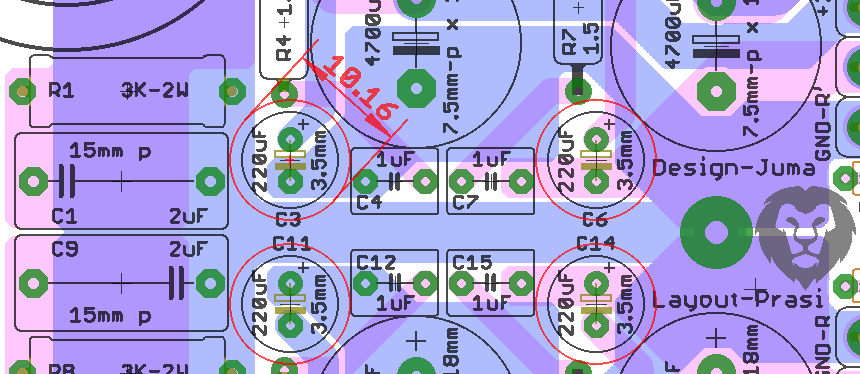

I found the space a bit tight for the 220uF caps but the Panasonic FC's fit okay - can fit other bigger sized ones to the side using slightly longer bent wires - presuming the mounting of the power fets to either a flat heatsink or on the bottom of the case

yes, 10mm caps can be fitted albeit a bit tight.
Just a query, can a lower value be used here? e.g. this one, 180uf, panasonic FM
or many like them.
http://in.element14.com/w/c/passive...e=180uf&voltage-rating=50v&lead-spacing=3.5mm
or many like them.

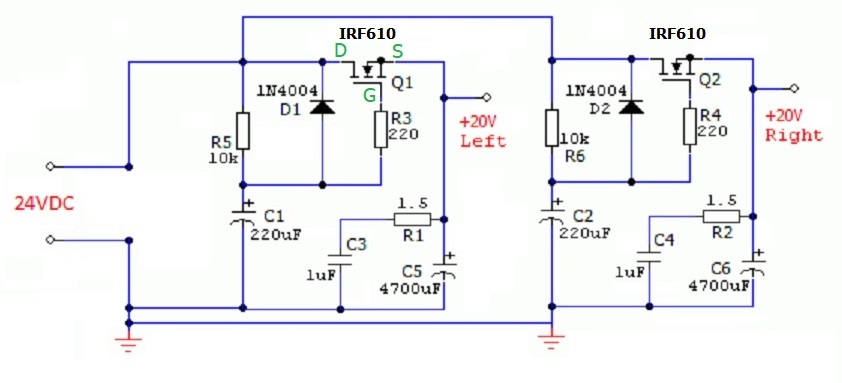

Just a shot in the dark. Can the voltage drop be altered by using different value components?
I've built a two-channel Cx based on Juma's schematic and it drops from 24.5VDC (server PSU) to 18.45V. It's for ACA and I was hoping to get 20V, or at the very least 19V.
Btw. I've used IRF610's, not IRFP240. Could that perhaps be the reason for the 6V drop?
This is the circuit I've used:
Easiest way to reduce the voltage drop might be, to replace enhancement mode power MOSFET with depletion mode small signal MOSFET (DN2530) and power BJT. Now you can get (Vin - Vout) drop as low as 1.00 volts if you wish. It would be a good idea to also include a 20-turn trimmer pot, so you can accurately "split the difference" between min_Vin (at the trough of the worst case ripple) and min_Vout (required by downstream electronics).
