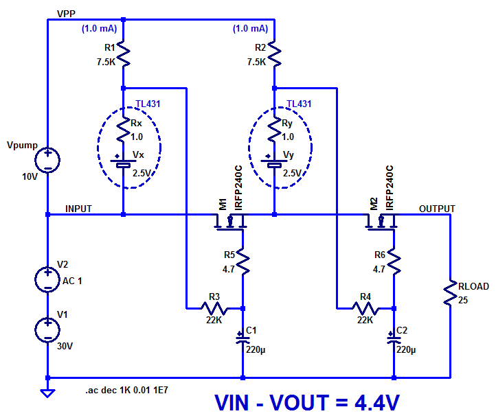

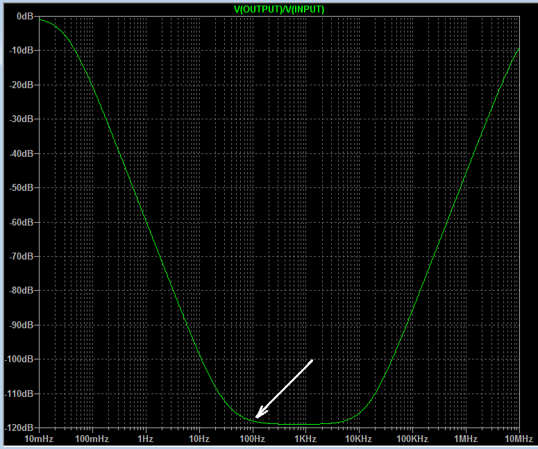

Here's what a cascoded design delivers, using a charge pump to minimize the voltage drops through two series source followers.
TL431 datasheet here
Simulation macromodels of the TL431 are notoriously unreliable so I just modeled it as a 2.5V zener diode whose dynamic resistance is 1 ohm. This is pessimistic compared to the datasheet.

Very good results Mark. But the cascode and the positive gate voltage makes for a little more complex ckt. Do you have a simple charge pump thatll work?
Hi Mark Johnson,
Can you please be more verbose for those of us not familiar with how to build a charge pump? Since you model the LT431 as a Zener and resistor, could we not just use a Zener? Also, I see two stages of cap multiplier being applied here. If we simply took two Juma cap multipliers in series, would the attenuation only improve by -3dB of would it be -45dB x 2 = -90dB. Closer to your -120dB shown here. That is a very impressive figure indeed youth. IRFP240's are cheap - I am game for taking this to the next vias odds charge pumped level if you provide a full schematic without leaving key bits so that "the interested reader can show that..."
Could use a joule-thief instead of charge pump. But suddenly we have a complex ckt and might as well build a proper regulator. For me the interest in the C-x is the simplisity. How about designing in the voltage drop by using a transformer with 3-4 volts more out than otherwise?
And yes cascading two after each other does indeed bring the attenuation down to -90dB or more. In the simulator that is. Will be inteesting to compare the real thing.

Try it in simulation and find out. Don't forget to measure the DC voltage drop from Vin to Vout, it might be as much as 12 volts. One benefit of the charge pump approach is that if you apply it shrewdly, you can reduce the voltage drop from Vin to Vout quite substantially. Especially if you've chosen high-gm MOSFETs.If we simply took two Juma cap multipliers in series, would the attenuation only improve by -3dB of would it be -45dB x 2 = -90dB.
Other members have commented that there is another DC-to-DC converter circuit besides a charge pump, called a boost-type switch mode power supply using an inductor. This is absolutely correct. However boost-type SMPS circuits sometimes poop out when the load current is very small, as it is here (less than 3mA), so read your datasheets thoroughly and design your circuits carefully.
Happy designing!
Certainly a negative feedback voltage regulator made with discrete components would have stunningly greater attenuation at low frequencies (including 120 Hz), all the way down to DC. (here are some measurements) But it wouldn't be a Capacitance Multiplier and it would have more than 6 total parts.

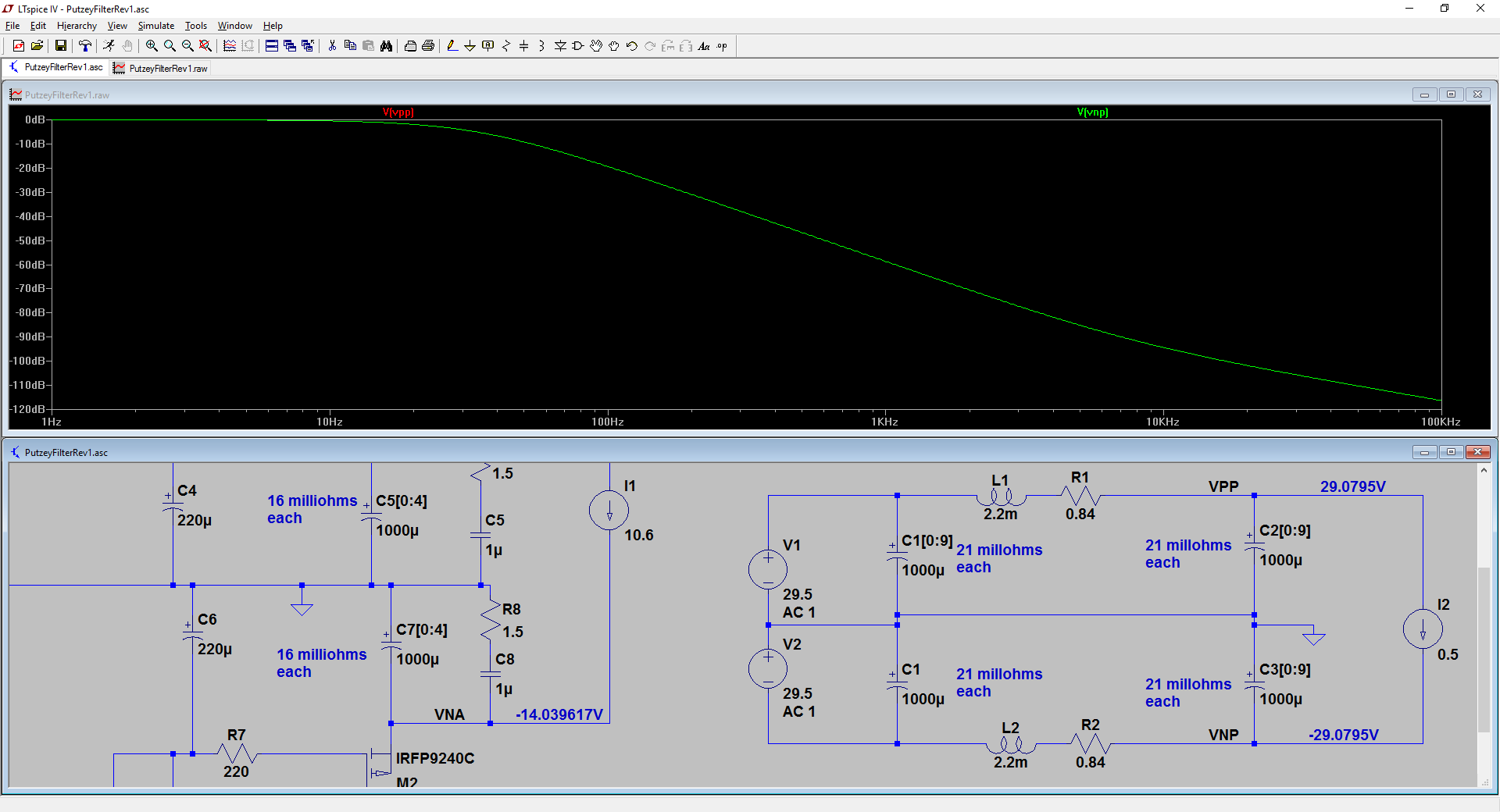

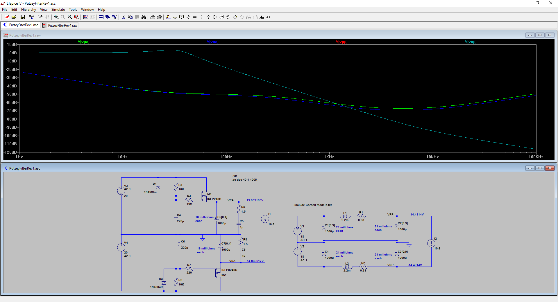

Here is the Juma Mx sim and a CLC sim. The CLC Filter can be a nice addition as a 2nd stage taking over the Mx right at about 1KHz. The draw back its just more hardware under the chassis.
Pic showing Class A requirements at 22V 3amps.
CLC = Vin 10 x 1000uF > 2.2mH inductor > Vout 10 x 1000uF

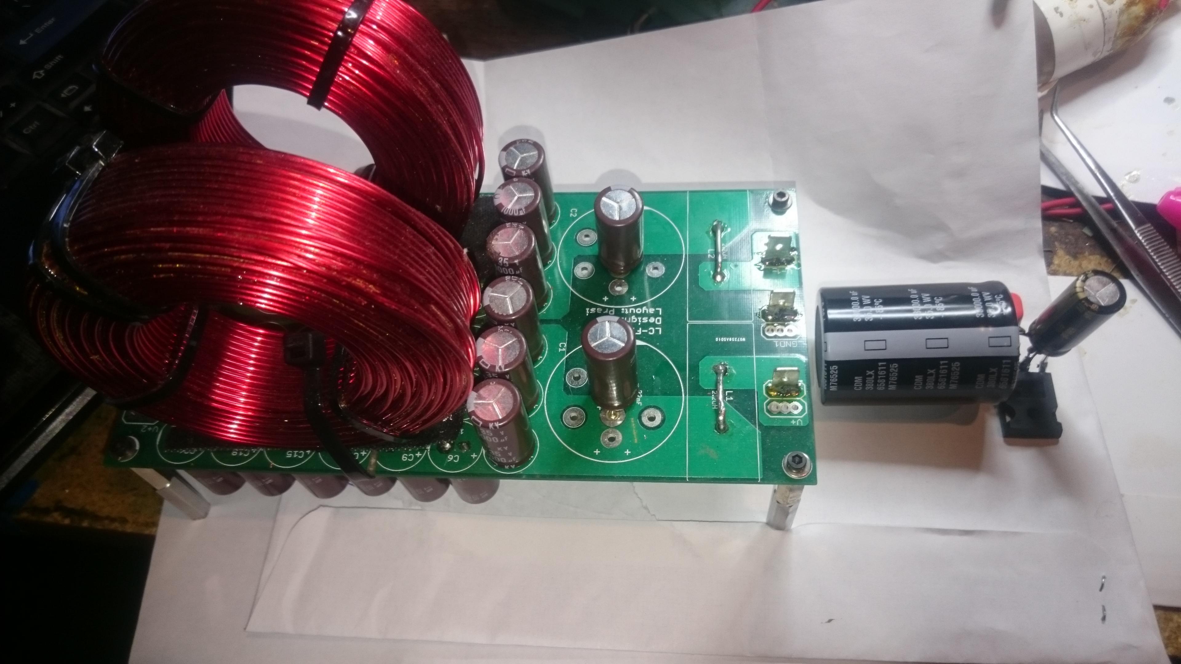

Thank you x,
here are the schematic, stuffing guide and gerbers. LED resistors mount from bottom.
regards
Prasi
Thanks again, Prasi. I've received my boards, in both versions, and I look forward to using them.
