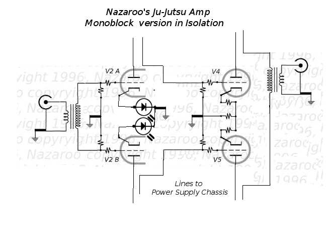

On the Power Supply,
if you add the isolation legs as shown,
the PS can be used for either configuration of amp,
Push-Pull Monoblock or SE Stereo amp.
The differences will be on the Amp chassis:
In the monoblock version, the difference on the Amp chassis,
will be this:
You can either remove one Output transformer,
or just wire the secondaries in parallel (test polarity),
and lift the ground on the primary.
You can put a simple switch in the Power Supply too,
to bypass the 2nd cap in the output for monoblock mode.
For the input you can drop in the balanced input jack
and the Jensen Input transformer.
Try a JT-11P-1T for instance:
It should be able to handle your hottest input signal.
you can get specs of the JT-11P from Jensen here.
Dual inputs can be switched in and out with a switch.

Using SE output transformers (to ground) might also allow dropping the output caps.
Can you show a schematic of how an SE output transformer would be connected from the mu-follower output to ground without a coupling cap?
This can't be done while simultaneously leaving the ground connection attached.Can you show a schematic of how an SE output transformer would be connected from the mu-follower output to ground without a coupling cap?
Here are some of the options:
(1) The transformer upper end can be connected to B+,
but this defeats the PSRR of the top tube, reintroducing PS noise into the circuit.
If the PS is already clean and solid, this can be minimal,
i.e., no worse than any other SE design.
(2) The transformer can be connected to a voltage-divider network,
but this re-applies about half the PS noise to the output tube, through the tranny.
From there you could try some of the Aikido-style tricks,
since the Output circuit is unusual in that it is more or less CCS.
This is why I prefer my original design, push-pull,
with no DC or PS noise applied to the transformer at all.
I merely mention some of the interesting options,
if you attempt to run my circuit as an SE instead of a PP Monoblock.
I suggested building it as an inexpensive test-run,
for those who prefer SE and wish to try the circuit inexpensively.
If they like it, they should proceed to step B, building two,
and reconfiguring to monoblocks.
Its still a good SE circuit without the output cap,
but its not utilizing all my design advantages.
I did not name it "the Ultimate SE",
even though it is a great SE circuit,
because I prefer PP for the clean power you get with my design.
