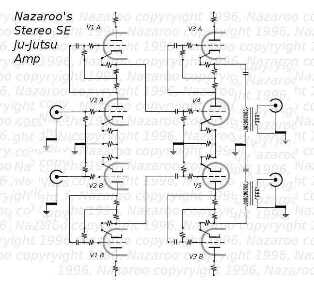

This is correct.So is it a bit like two single ended output stages 180 degrees out from each other? And if that's right for a unbalanced input you would use only two tubes and one side of the circuit?.
You can use one half of my amp for independent stereo SE operation. But you need two Output Transformers and you save having to have an input transformer.
I'll post a circuit diagram.
If you do so, you'll get a bit of that 2nd harmonic tube sweetness in the mix.
You could rig a mode-switch to alter operation in the same amp!
Build one, use it as a stereo SE, then later build another as a monoblock for Push-pull and more wattage.
Keep in mind that the input signal must be only half as large, before clipping,
and the power output will also be halved.
Here's a circuit diagram of the Stereo SE version of my Ju-Jutsu Topology:
The cost difference involves swapping out the input tranny for another output tranny,
and buying one more RCA jack.
The power supply can remain the same.
Now you can all build SE versions at half the cost!

Its a Hafler IM distortion adjustment.What is the purpose of common cathode resistors, some kind of stereo base widening?
But in the SE preamp section it can be skipped,
and on the bottom tube I think diodes can be substituted for bias,
but I haven't tried them.

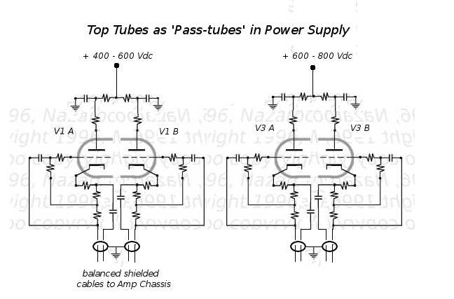

... So is it a bit like two single ended output stages 180 degrees out from each other? And if that's right for a unbalanced input you would use only two tubes and one side of the circuit?.
Sorry, I missed a point here:
SE Output Stage: It won't be only two tubes; For the output, you'll still need some beam tetrodes wired as triodes (they don't come in a two in one envelope).
SE Input Stage: You'll still need two separate tubes, if you're using high voltages (i.e., 500 volts B+) and separate heater supplies.
But you can still halve everything by building it all on one chassis and sharing a single powersupply, and sharing top and bottom tubes (one triode in each for each side Left and Right).
Or you could build the Powersupply on a separate chassis and still share it. It will be more difficult to separate the tubes onto separate chassis, because if you use say a 5998 and share it between channels it will still physically have to be on one chassis or another.
My suggestion is: Rightfully recognize the top tubes as an integral part of the powersupply, with feedback (think of them as fancy Pass-tubes with signal feedback). Mount the top Output tube along with the PS components. It is pretty impervious to hum. The top input tube can also be mounted on the Power-supply, if kept away from other hum-inducing components.
Now your second chassis just contains the lower tubes,
two HV powersupply connections, and only one (lower/grounded) heater supply for the lower tubes (plus a ground). Going backward through the same HV connections (each really coming from the top tubes, not directly from the power supply), the control signal will be applied to the grids of the top tubes on the PS chassis through a cap. These leads should be shielded, but they will only be 200-400 volts, and much safer ran as PS lines to another chassis than a real HV connection (at 500-800 volts).
Being on the PS chassis means you only need one top Input stage tube (dual triode) and one top Output tube (dual triode).
The amp chassis will have one lower input tube (say a 12ax7) and two SE output tubes (say a couple of 6L6s), two trannys, and two RCA input jacks.
A very nice small footprint.
The mode-switching can be accomplished on the amp chassis, with an input tranny mounted and switched in between the RCAs. The second output tranny can also be switched out, leaving a balanced/unbalanced input monoblock.
Now the total number of tubes stays the same: FIVE TUBES, for two channels at 12 watts/channel.
Lets rearrange the Top Tubes in our amp, and put them on a separate Power-Supply Chassis,
with the HV B+.
For SE operation, we have to do a little extra isolating of HV power supply to the top tubes,
using additional Cap/Resistor legs. (top of diagram).
Also, we install the signal caps on the PS chassis, so that at least two of the connecting lines
have no High Voltage DC (this is blocked by the caps.
Even the two lines with DC only have half the full B+ voltage,
since it is divided ('dropped') across the Top Tubes.
You can use ordinary 600 volt insulation wire (shielded) between PS and Amp Chassis.
Make sure you orient any connectors safely (males on receiving circuits, females on power sources).
Although there are now two tubes (a 12AX7 and a 5998 for instance) on the PS chassis,
it really isn't any more than you'd find on almost any regulated HV powersupply.
What has happened is that we have simply made more intelligent use of similar tubes,
with much more spectacular results.
Why have a mere 'regulated' supply, when you can have a 'feedback-controlled' CSS supply?
Don't forget to add a good heavy gauge ground line between the two chassis.

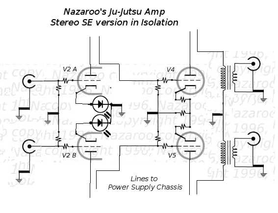

Now we can see the Ju-Jutsu Amp (SE Stereo) in its true light and simplicity.
It is simply a pure two-stage amplifier, in real linear operation,
with a pristine DC supply, and no current in the OT.
Click to enlarge:
I've stuck in some LEDs to bias the first stage, as some people might want to try it.
When the Mu-Follower is understood as it really is,
a sophisticated power-supply regulator circuit combined with an ideal load,
we can see plainly how the amp achieves near-perfect distortion-free operation.
The only two caps in the signal path are in the PS chassis.
Click to enlarge:
with the HV B+.
Nazaroo, I'm not seeing what is the advantage of relocating the upper tubes of the Mu-Follower to the P.S. chasiss. Please clarify. Thanks.
(1) It helps isolate the real dangerous high voltage and keep it contained in the powersupply.
(2) Teaching purposes, so that people can understand the true meaning of the Mu-Follower.
(3) The separate heater supply for the top tubes (with HV offset) is also isolated.
The heater supply is perhaps the most dangerous, because even seasoned technicians
forget that it can have lethal HV riding on it.
Okay, yes. If the H.V. supply is to be placed in a separate chassis then locating the upper tubes there will produce a less dangerous interconnection between the two chassis. I was picturing the P.S. and amplifier circuitry in the same chassis, hence my question.😛
It is quite feasable to eliminate even the interstage coupling caps (with careful design and testing),
since with a self-biased output stage, you can have up to 100 volts on the output grids.
In this case you would use a 6922 for the first bottom tube, which can run on lower voltages.
Using SE output transformers (to ground) might also allow dropping the output caps.
This leaves only the caps used by the Top-tubes,
which are really only PS regulator feedback caps.
Now you have a capacitor-free signal path right to the speaker.
