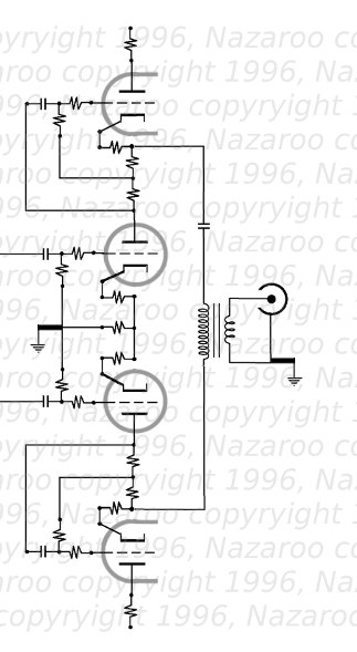

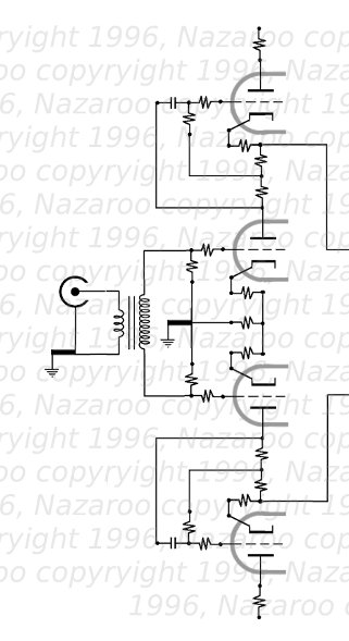

Okay lets look at the input / stage 1.
Overview:
What is going on here?
First of all, I chose balanced stages all the way through the amp.
We have to get to balanced anyway, for a Push-Pull at the output stage,
so at some point I'd need an interstage transformer or a splitter, with all those problems:
added stages, another layer of distortion etc.
Well I learned a lesson working with professional studio gear, which is balanced all the way from the microphone.
It works best, and gives the highest noise immunity and lowest distortion.
All the advantages of the Push-Pull (harmonic cancellation, Powersupply noise cancellation)
are now transferred to the whole amp.
If the Mu-Follower wasn't clean enough, its now bullet-proof.
What you are looking at is two Mu-followers, one for each side of a balanced input.
One is drawn upside down for symmetry and beauty.
The input transformer is a Jensen.
Simply put they make the best input transformers you can buy.
We use them in everything in a studio environment, for isolation, balance, and frequency-response, noise immunity, and low distortion.
They are a cost-effective solution and replace an interstage transformer, which,
to get the same specs would cost a fortune, and they don't make them like this anyway.
Jensen can make near-perfect transformers because of the signal amplitude and size.
Nuff said. No one in their right mind would prefer an interstage to an input transformer.
That leaves the resistor values.
The input stage here could be any tube, but lets pick a 12AX7A
just to keep it easy to get good quality cheaply available parts.
Well, we'd like about 250 volts across each tube.
We'd like to bias them according to my little method.
But people have designed plenty of 12AX7 Mu-Followers,
and you can use tested circuits that are known to deliver high fidelity.
Some things never change.
The input grid resistor for each triode should be 500k to 1Meg R.
This provides an appropriate input impedance for the transformer,
and a path to ground to (self-)bias the grid.
The cathode resistor should be about 1k R to give a volt or two of self-bias.
It's positive voltage at the top (due to the idle current) makes the grid relatively negative.
Input tubes should pretty much always be self-biased unless you have a good reason not to.
If you are using a 6922 or some other more sensitive tube, don't forget a grid-stopper (shown).
Otherwise you risk hidden parasitic oscillation and poor performance.
You'll notice I have a three-resistor network to ground for the two bottom tubes (one upside-down).
That's Hafler's minimum IM distortion trick, discussed in the literature.
You can just as easily use a couple of LED diodes to ground on the bottom tubes (NOT the top ones!!!),
as some people are doing these days (they weren't available in Hafler's day).
The top tubes are set up similarly, but the extra resistor on the cathode is another parasitics-stopper (horizontal, optional).
Again a 500K resistor (or 1 Meg R) is a grid-leak or input resistor (and a horizontal grid stopper if needed: try 1k).
The top resistor is not really a load resistor, its again a 'parasitics stopper' resistor. (500 R would do, or even skip it).
The top tube is operating as a cathode follower.
The input cap for the top tubes are .22 uF, but you could use a .1 uF, its not critical.
What's left? The input is grounded to the chassis- via a star-ground at the bottom of the input tubes.
This is for shielding, but it can be skipped, and you could just use an XLR input for a balanced line input.
You could even eliminate the input transformer entirely if you have balanced lines.
Any questions? No, then we can move on to the next (last) stage.

While we're at it, lets look at the real output stage:
Again we see balanced-input complimentary Mu-Follower circuits,
each providing 1/2 of the P to P voltage across the transformer.
The nice thing is, there is no DC flowing through the OT.
The tubes get their current from the Power Supply through the top tubes,
and the OT route is superfluous.
The blocking cap I used was 10 uF, 600v polyprop, the only expensive cap in the whole amp.
It's also bypassed with a fastcap low esr, just in case.
The cap should not face any voltage other than the output signal.
If there were a slight imbalance between the tubes,
and a small DC voltage difference between the two tapping points,
who cares? its blocked.
The beauty of this is that the tubes don't even have to be balanced, as in a std Push-Pull.
The DC offset can't dump any current into the tranny, so there's no concern at all.
The tubes would have to be woefully out of wack to have any effect on the signal.
Since this is a constant-current style circuit, operating high in Class-A,
there is no question at all of 'blocking-distortion' from grid current in the bottom tubes.
But still the input grid-leak resistors should be as recommended by tube-makers,
e.g., for a 6550 say 100k and an appropriate input cap, say 1 uF.
Again with the Hafler cathode circuit, which minimizes Push-Pull IM.
What can I say?
These output tubes have to be self-biased, because of the huge high voltages across the circuit.
But thats okay, because the Mu-Follower forces linearity on both tubes,
even before they have to cancel out small non-linearities from each other.
Win win again.
Use large wattage cathode resistors, and adequate ventilation.
Don't forget sensible grid-stoppers and screen-grid stoppers on all power pentodes/tetrodes in Triode-mode.
Look at recommendations for the specific tubes you're using.
I left out a 100-200 ohm parallel resistor across the output secondary, to prevent spikes
in case of speaker-failure or disconnection.
The top tube in the WWII model (5998) cannot be substituted with a 6AS7G,
without significant modifications.
Try to put 1/2 to 2/3 of the B+ across the bottom tubes.
If you're using an SE transformer you can try omitting the blocking-cap in the primary!
Again, critically important to have a separate floating or DC-biased heater-supply for the top tubes.
Stay within 100 volts of the cathode, or as per tubesheet recommends.
Not only is any PS noise blocked by the heavy topload Mu Followers,
whatever signal gets through is near-perfectly cancelled across the transformer primary.
Remember that these Output stages are nearly CC,
so whatever small PS noise is left from the voltage-divider action,
is almost always near-perfectly cancelled.
noise free. hear the difference.

Those are some high voltages, but for a DIY'er not wanting to venture into 750V territory, your topology should work with other tubes where lower voltages could be employed although perhaps will lesser performance. Output: The 6L6 is usually operated at higher voltages from looking at the spec sheet. But what about 6V6's at 250V plate-cathode, or if you want to push it further, a 6AS7 which can work nicely at only 100V plate-cathode. Input: there's the 6N23P / ECC88 that will run nicely at 100V plate-cathode.
If you want a cheaper output stage and keep the performance,Those are some high voltages, but for a DIY'er not wanting to venture into 750V territory, your topology should work with other tubes where lower voltages could be employed although perhaps will lesser performance. Output: The 6L6 is usually operated at higher voltages from looking at the spec sheet. But what about 6V6's at 250V plate-cathode,
use 6L6s for the bottom (amplification),
and 6V6s for the CSS.
Play with the voltage division via tube bias.
I found experimentally the 6AS7G couldn't deliver.
It clips too soon, I think.
I think you can use a 6922 at lower voltages,
and even skip the extra heater supply,
by NOT grounding it (i.e., letting it float at an ambiguous DC level).
In regards to the input stage,
don't mix up the different tubes:
Both bottom triodes should be in the same tube (if its a dual),
so the heater can be at the appropriate DC offset in each.
Both top triodes need the same offset heater, and should be in
the same tube too.
the same tube too.
You have a good point about the PSRR problem for P-P triode output stages (using a CT'd OT). It doesn't get mentioned too often. The triode is like a variable resistor, and puts power supply noise into the OT during signal peaks for the usual setups, even for class A operation as you said.
Pentode outputs should avoid that problem however, but they usually get operated in class aB mode for more power, where the tube crossover distortion and OT leakage L switching noise cause problems instead. A Circlotron driven by pentodes should come close in class aB mode, as long as noise is not coupled thru the common mode power supply winding capacitances (use dual bobbin xfmrs).
I suspect the output Mu sections (at least) could be replaced with some modern low capacitance Mosfets (like Fairchild FQP... or equiv.), to get the B+ voltage down to safer levels without much compromise to the sound.
Another thing your setup does, is to use the full OT primary at all times (like a Circlotron does), this has big advantages for the OT bandwidth (cuts leakage L in half) and effectively lowers the winding resistance by 1/2. (4X total primary Z, 2X resistance = 2X improvement over single sides) The Circlotron or Crowhurst's Twin Coupled setup (with cross coupled capacitors) also do this. These are easy ways to get the equivalent of the Mac OT with ordinary OTs.
I myself would prefer to stick with higher efficiency class aB using the Circlotron or derivatives with pentodes and maybe some EC (error correction) drive, a'la Hawksford EC, for fixing the crossover dist.
