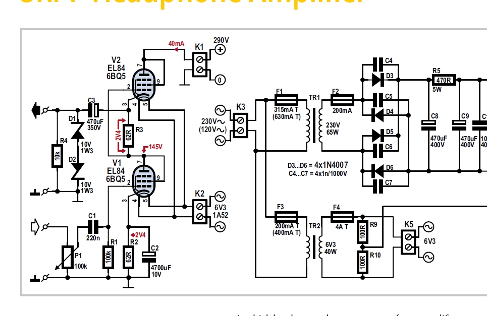

The SRPP output stage is not new. Note the schematic included in the Mullard data sheet for the EL86,
This is a modern version with the EL84.

I guess many folks want a BOM and schematic with the parts values inserted.
Otoh, this is a good place to go and do some reading, get out ur scientific calculator, and try to figure out what values will need to go in the various places based on the schematic presented AND also the likely B+, bias point plus current draw of each tube.
Since there are quite a few sources cited for analysis of the basic circuit, it should be possible to get "in the ball park" pretty fast.
Then you make up a breadboard prototype version of 1/2 of 1/2 of the circuit (it is mirrored x 4) and test to see what the numbers look like, tweak the parts values.
That ought to actually work for the most part.
A scope on the signal would tell you a bunch too... someone with a sound card and an FFT program could look at the harmonics WRT parts values and operating points...
If a few folks go this route, you can all share your results in a build/reverse engineer thread and become famous/renowned in the process!
Seems like a fun way to go to me.

I would think the prices on tubes, sockets, wire, resistor and capacitors are easy to figure. Power supply parts too. Chassis, depends on what you use, what he used. There are some very pretty chassis from China these days... Now the only maybe custom part is the output iron.
Maybe you should ask him what output iron he used, and what specs?
It's not hard to communicate, but one has to ask a question that there is a way to answer.
Maybe I missed something in the schematic - is there anything exotic or difficult to source?
