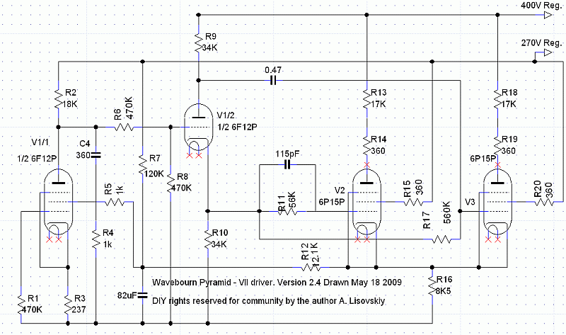

I'm jealous of those 'cold indicator' tubes.
What exactly does the circuit do with them?
Do they flash with the music, as VU meters?
Yes, they flash with the music, as VU meters. But it is not the only indicator: as soon as the amp hits 80W per channel optical compressor engages and bright red light flashes crying: "Hey, pull down the fader!" 😀
Your preamp seems complex. Is that a tube-splitter?
Yes, it is a phase splitter and driver.
