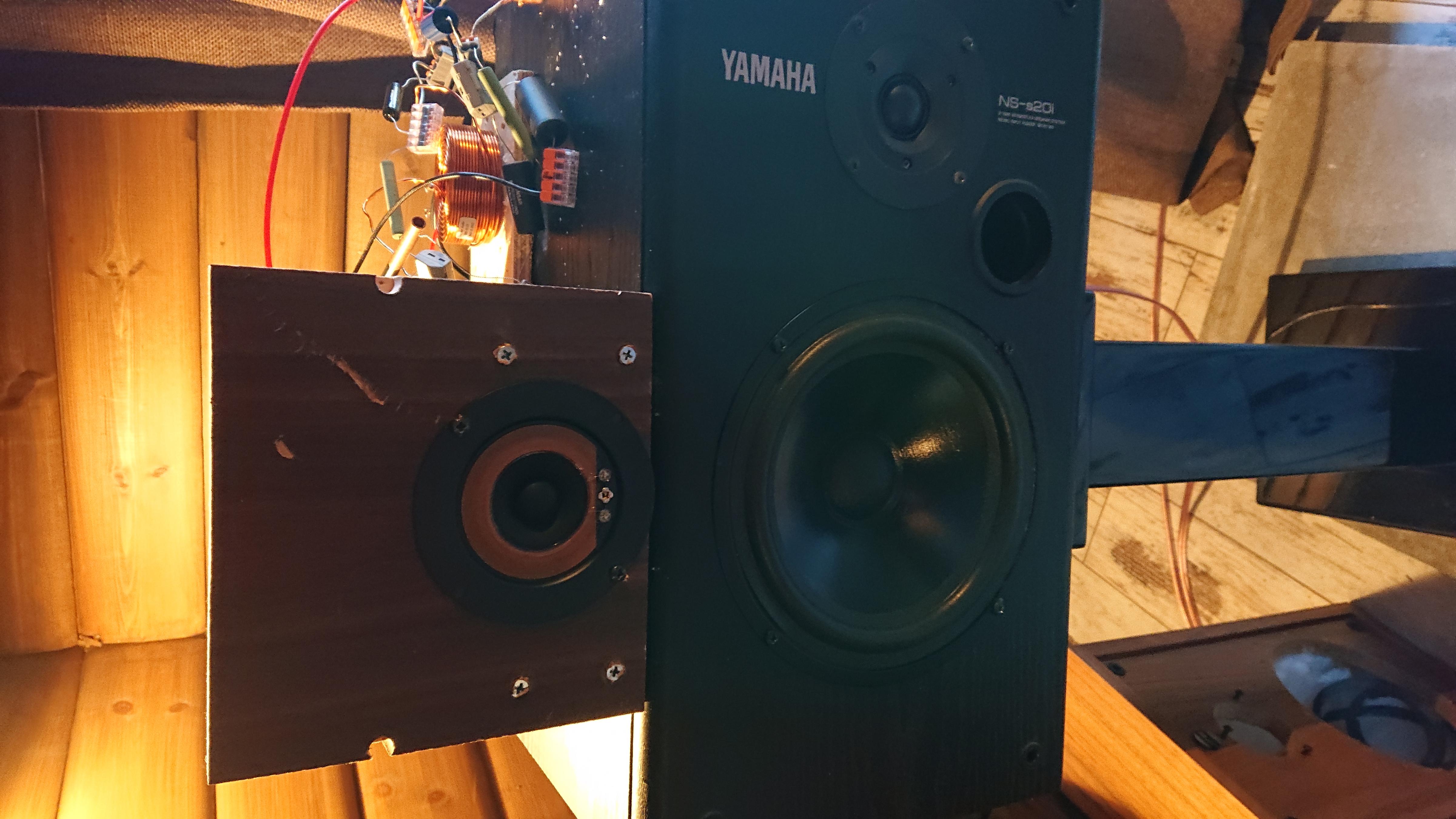

Have been playing around with a pair of vintage cone tweeters while I have been waiting for my GRS tweeters. I didnt like the old ones, much preferred the Vifa's.
But now I got the GRS, and man I dig these! A big thanks to Steve for letting me know about these paper cone tweeters and BW 3 crossover design.

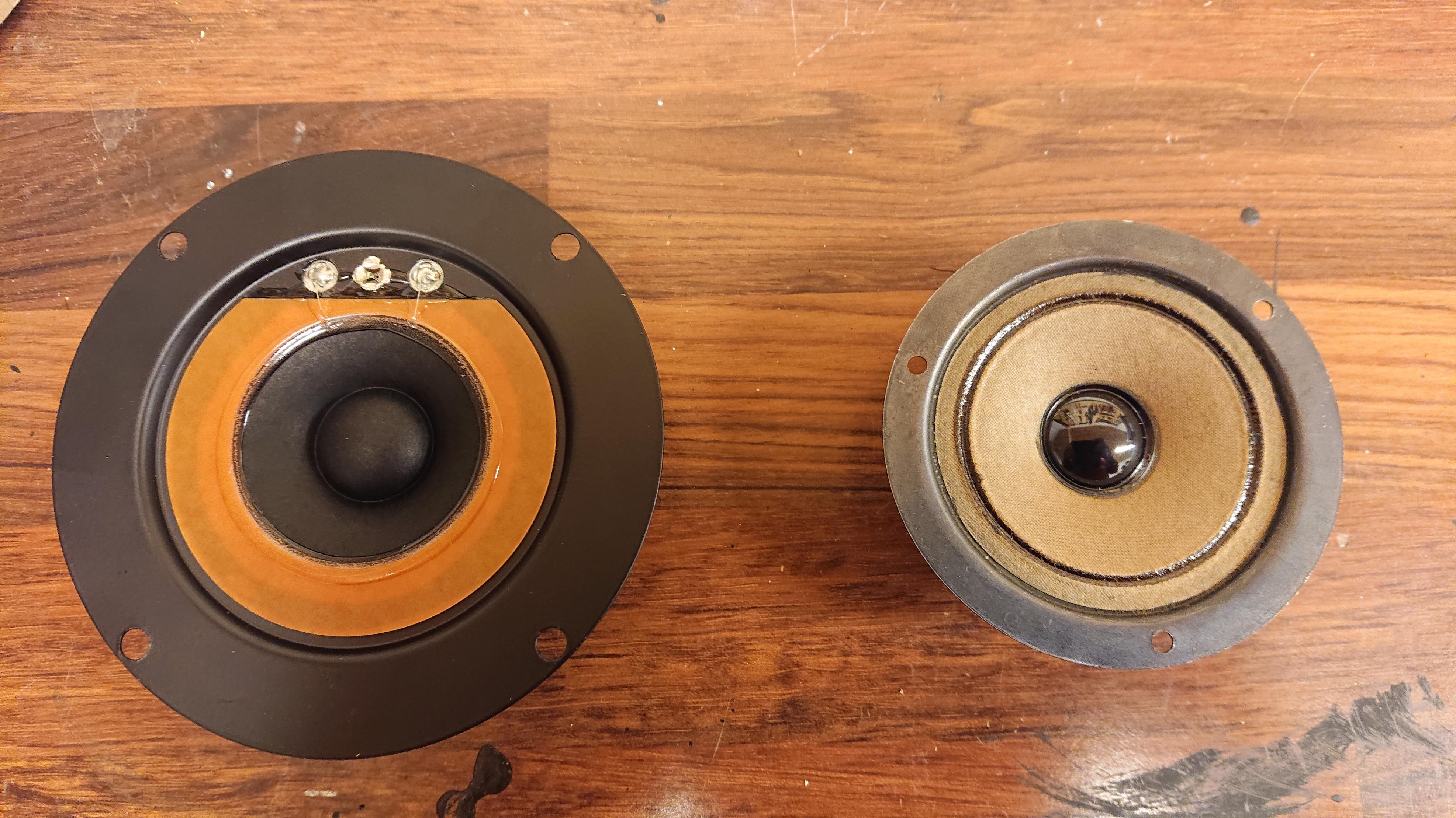

Those old phenolic ring tweeters are a legend! 104mm is a bonus too. 90db output, about 7R DC, and flattish too. Easy!
Phenolic Ring Tweeter Replacement for AR-4X CTS Marantz and More 8 Ohm

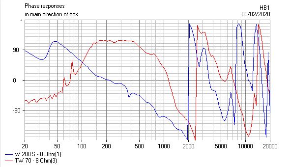

I have been busy with W200S plus Monacor HT22:
Genuine 90 degree BW3! No power hole at crossover!

Just for fun I put the tweeters back a few cm and put them in phase with the woofers, without any change to the crossover. Now I havet measured them, but I think they sound even better. Especially pin-pointing and depth of soundstage.
