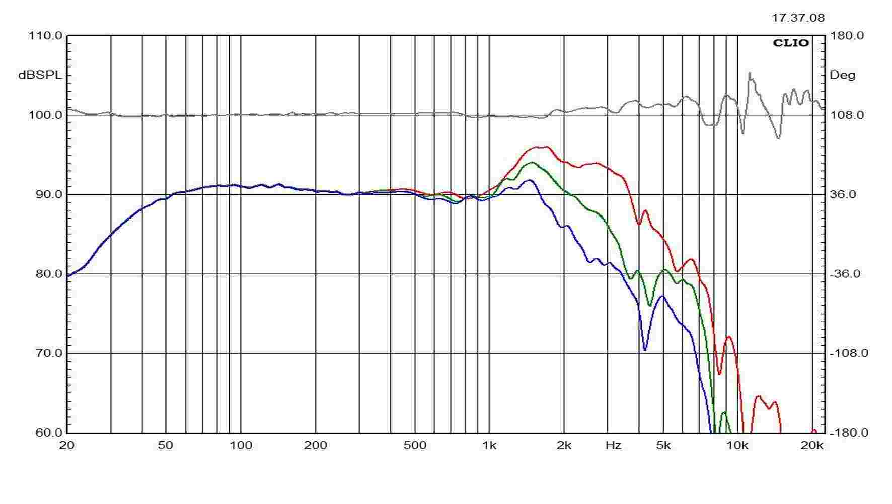

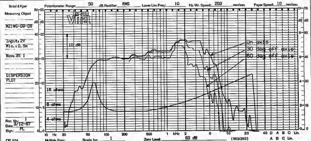

I just can't wrap my head around the 1500hz peak on the M21WG. All the C and M versions of the 17/18/20/21 woofers I have come across has been super smooth. I don''t think it is cone breakup. My suspicion is it has to do with the surround. Scanspeak says it is foam surround that cannot rot. Maybe not foam then?
Look at Troels efforts on the high efficiency page were he changes from rubber to foam surround. The foam helps on the response.

I'm still not convinsed. Look at these othe woofers, measured under the same conditions.
SS 22W 8534:
Monacor SPH 220HQ:
Peerless 830869:
Just thinking out loud here. The Vifa woofers normally has a QMS of 1,5 to 2,5, no kapton or glassfiber voicecoil formers. So how can the M21WG have considerably higher QMS?
And to have a such a light weight cone giving that low FS and high VAS. For that you need a high compliance suspension.
But by nature foam surrounds is a low compliance device.
The suspension has two elements, the spider and the surround. Now since the surround is a low compliance device, could they have done something to the spider?

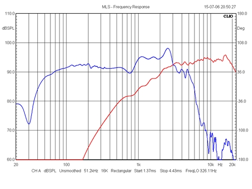

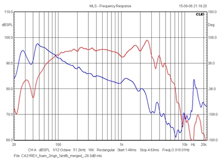

I added a bucking magnet to the M21WG to see what would happen. Obviously QES goes down, but so does QMS.
The Vifa M21WO which has more or less the same cone, just a bigger voicecoil which give a mass of about 10 grams more. It has about the same fs and a little less vas than the M21WG.
10 grammes is a big difference between the two. Which one has the sharpest low frequency resonance?

I'm not sure what you mean. The WG version has higher QMS so the impedance peak at resonanse is higher.
It was a general question that's all,
You have answered it by saying that the WG version has the higher QMS value and that the peak at resonance is higher.
Is it a resonance due to an un doped dust caps, I am guessing the others have larger and maybe different material dustcaps?
