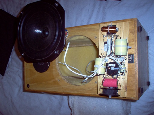

I've got a pair of JPW AP2, and thought I would have a look inside to change the caps and the internal wiring. When I took out the crossover terminals, I realized that one of the previous owners has cut the internal connection between the woofer and the tweeter (see arrows #3 & 4 on the pic.) My understanding is that this is a standard procedure with these speakers, if one is to do bi-wiring.
However, it seems that the smaller coil got disconnected too. On the one end, it is still soldered to the cap following the resistor on the + side (see arrow #2), but the wire is cut on the other end of the coil (arrow #1). As far as I can see, it used to be connected to the - side.
Does anyone have the scematic for the original crossover of the AP2, or at least the value of the coils? I can read the resistor and the capacitor alright, it's just the coil that gives me hard time.
