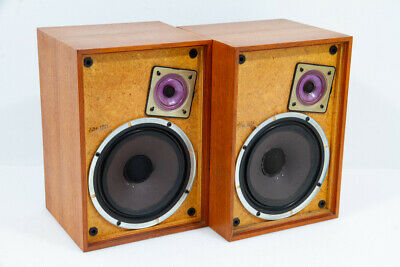

Averse as I am to adopting every stray cat that lurches past my doorway, I am severely tempted by my local charity shop's offering of an 8" paper Wharfedale Linton 2 speaker for £30 or about 35 Euros:
The famous 2" purple jellyfish cone tweeter. With a coffee-cup sized and stuffed enclosure.
It has sat there unwanted and unloved for weeks. 😕

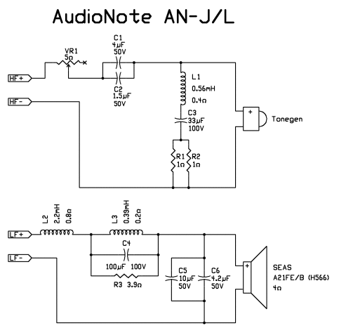

The Audio Note woofers were very high quality 4 ohm hemp cones, with silver voicecoils and AlNiCo magnets made by SEAS:

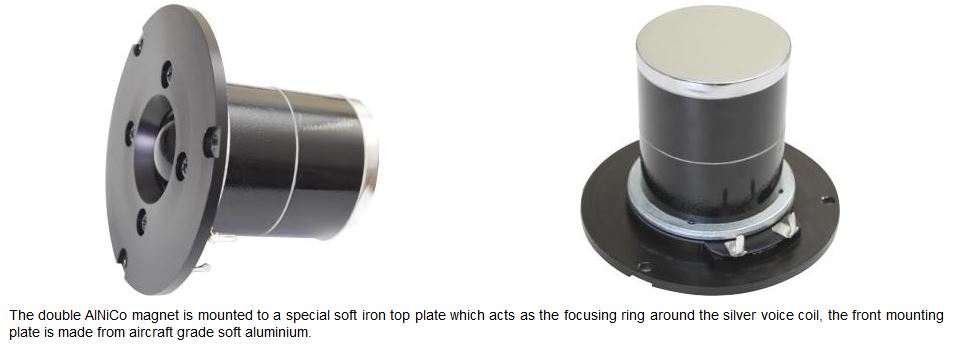

Tweeters are double magnet, to the same exotic standard:
All terribly efficient.

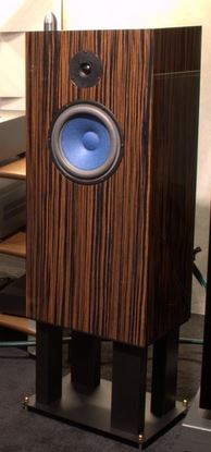

There was a notable debate between Art Dudley with his 8" two way Audio note AN-E Lexus, and Jon Atkinson with his 12" Harbeth 3 way M40.1.
Audio Note AN-E Lexus Signature loudspeaker | Stereophile.com
Harbeth M40.1 loudspeaker | Stereophile.com
I think it came down to the old big speaker in a small room issue. Not a good idea, IMO. Booms terribly.

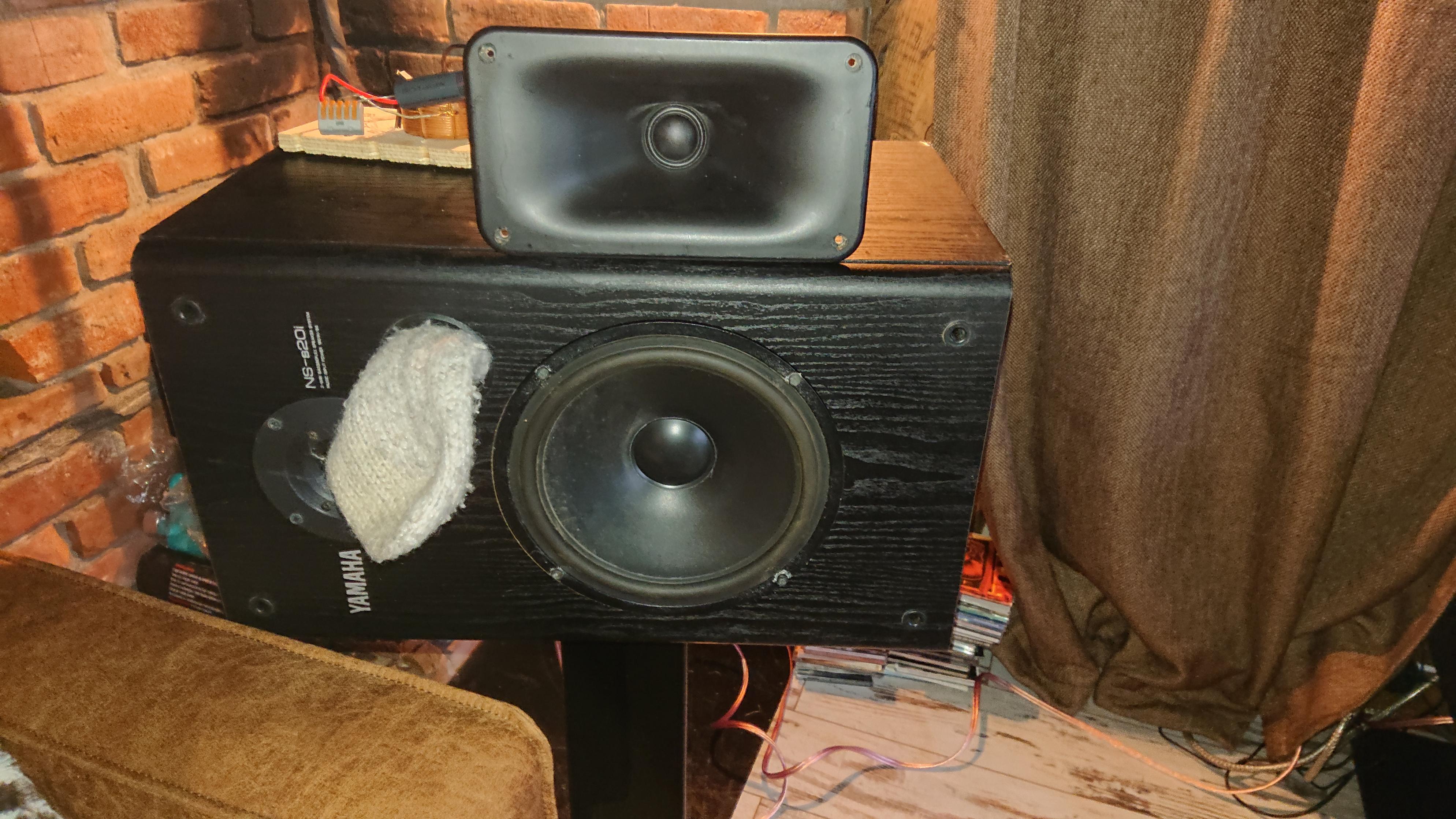

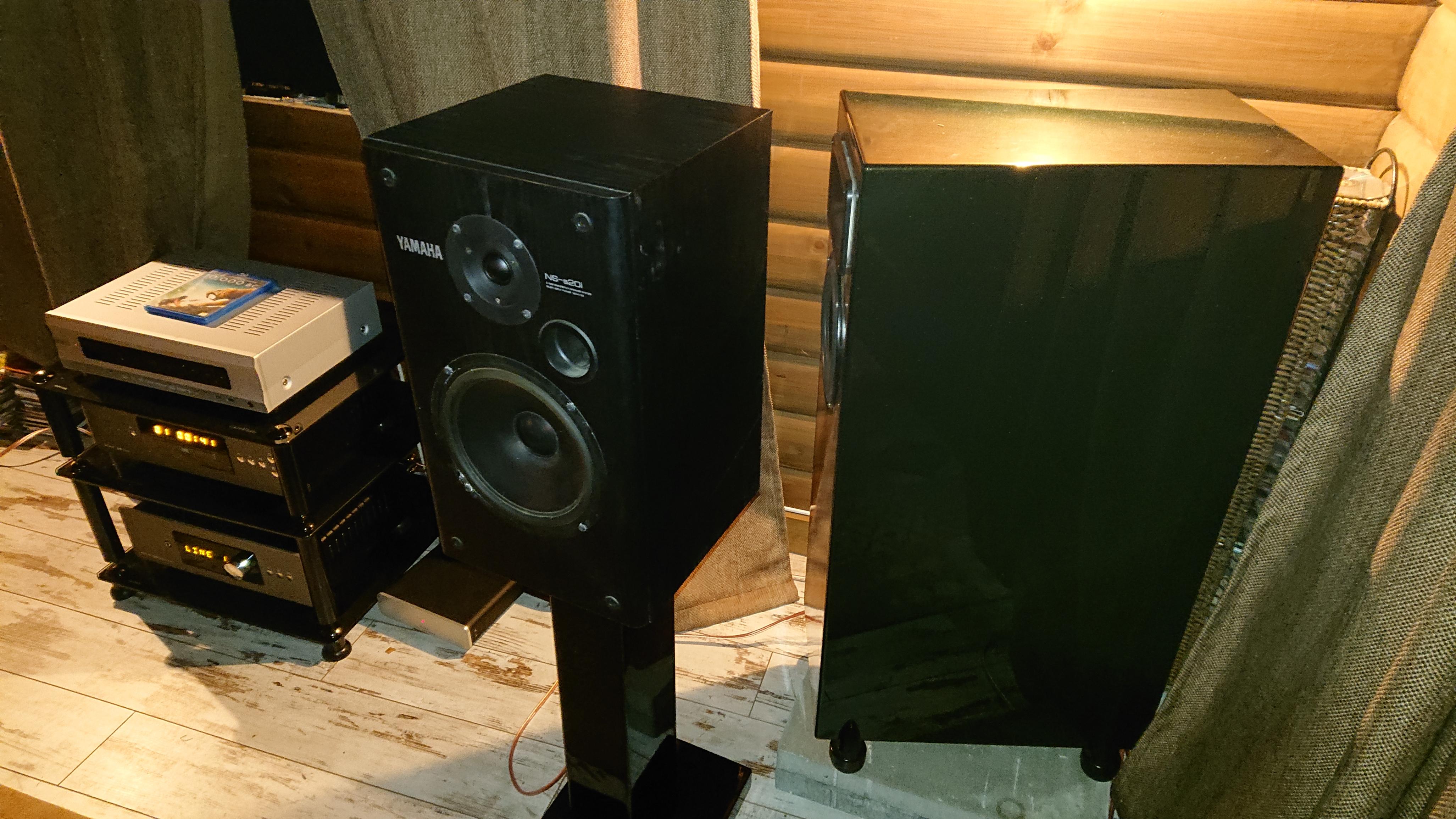

I have been enjoying these Yamaha's for a couple of days now. Been playing way to loud way to long. Really nice speakers. Not only me who likes these:
Stereo Impressions: Review: Yamaha NS-s20i Monitor Speakers - Almost Vintage, Still Sounding Fresh
But they are screaming for some upgrades though.

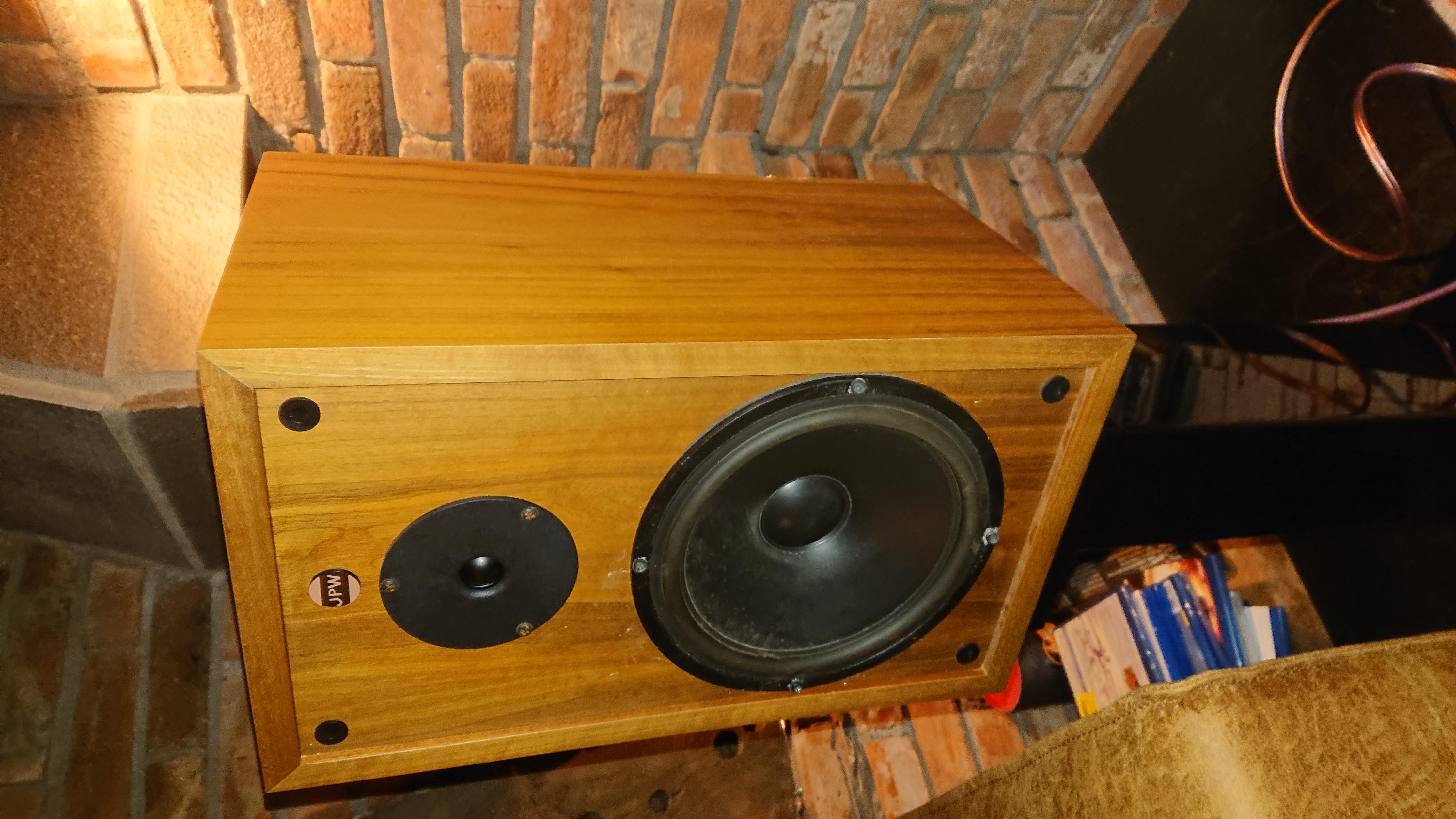

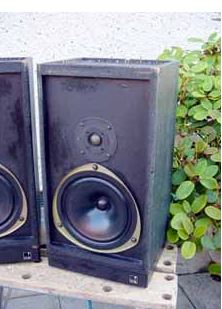

I don't have the woofers for the JPW's so I just popped in the Vifa poly ones from the Yamaha's. Now there can't be much baffle step built into the crossover of the JPW's!
The upside is they are quite dynamic, I don't need to push the volume nob much to get them to sing.
On the ported Yamaha's I had to put a good ol pair of socks and stuff the ports, and still they are a little bit heavy on the bottom in my small room 2,5 feet out from the wall. With the JPW's I have pushed them right up against the wall and even then they are dry on the bottom end.
And the build quality of the JPW's is really nice. I would say they surpass the Snell's I have seen. And miles ahead of the Yamaha NS-s20i.
But the mids are sweet and smooth, but not dull. I am really surpriced by these poly Vifa woofers. Vifa poly woofer and Vifa poly tweeter, what's not to like😀

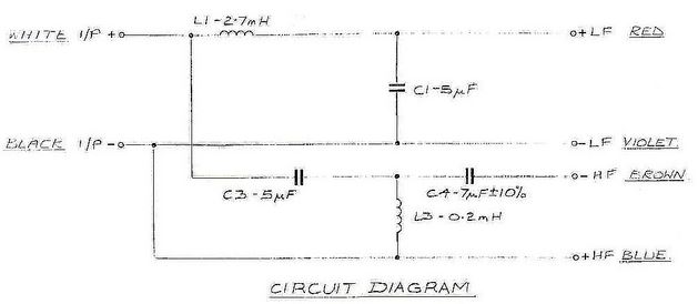

The coil used in the JPW gives full baffle step according to measurements I did years ago. A different woofer will require a new crossover to work in that box with that tweeter and may well need a larger value to achieve full bsc.
The coil in these does not give full bsc. For 8 ohm Vifa's that would be maybe 2,5mH? Just by the looks I would say the coil in these P1's is no more than 1mH, and probably even less.
What's 8ohm got to do with anything? My guess is you've used a calculator to work out bsc rather than measurements.
Just by experience. If you look at my first post you'll some of my Vifa experiments. I found that 1 - 1,2mH for single woofer and 0,82 - 1mH works nice for two paralell woofers.
My big diy Impulse H5 inspired speakers use 1mH series inductor and 10uF shunting cap. That gives around 2000hz crossover and 2db bsc... With two of my Vifa C17 in paralell and 0,82mH series inductor and 19uF shunting cap gives around 2000hz crossover and about 3-4db bsc.
You have to be careful with online calculators, because they assume a linear (6 ohm) resistance in the woofer and take no account of baffklestep:

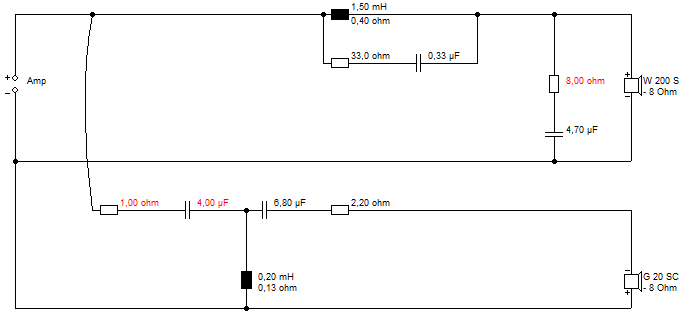

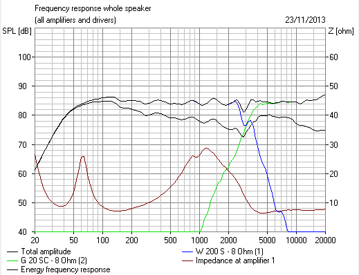

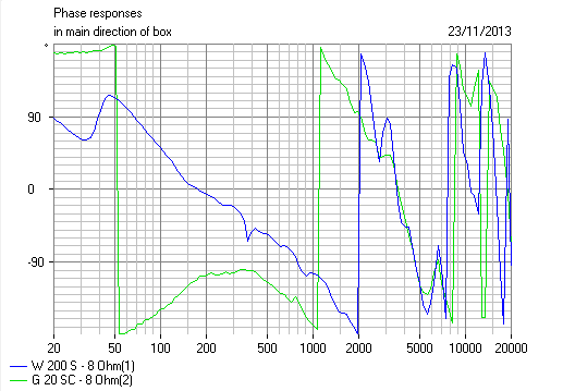

It is quite rapid to set up a 56cmX 28cm X 28cm common enclosure in Visaton Boxsim:
Software | Visaton
I'd set up two drivers for convenience and place them on the baffle of the common enclosure. Now import the W200S-8 as bass and give it a suitable closed box or reflkex volume: W 200 S - 8 Ohm | Visaton
Good 3/4" G20SC soft dome:
G 20 SC - 8 Ohm | Visaton
Now design your filter. This is the KEF Celeste 3:
Dissi found the 3kHz filter:
It'll work OK with a bit of level adjust.
Software | Visaton

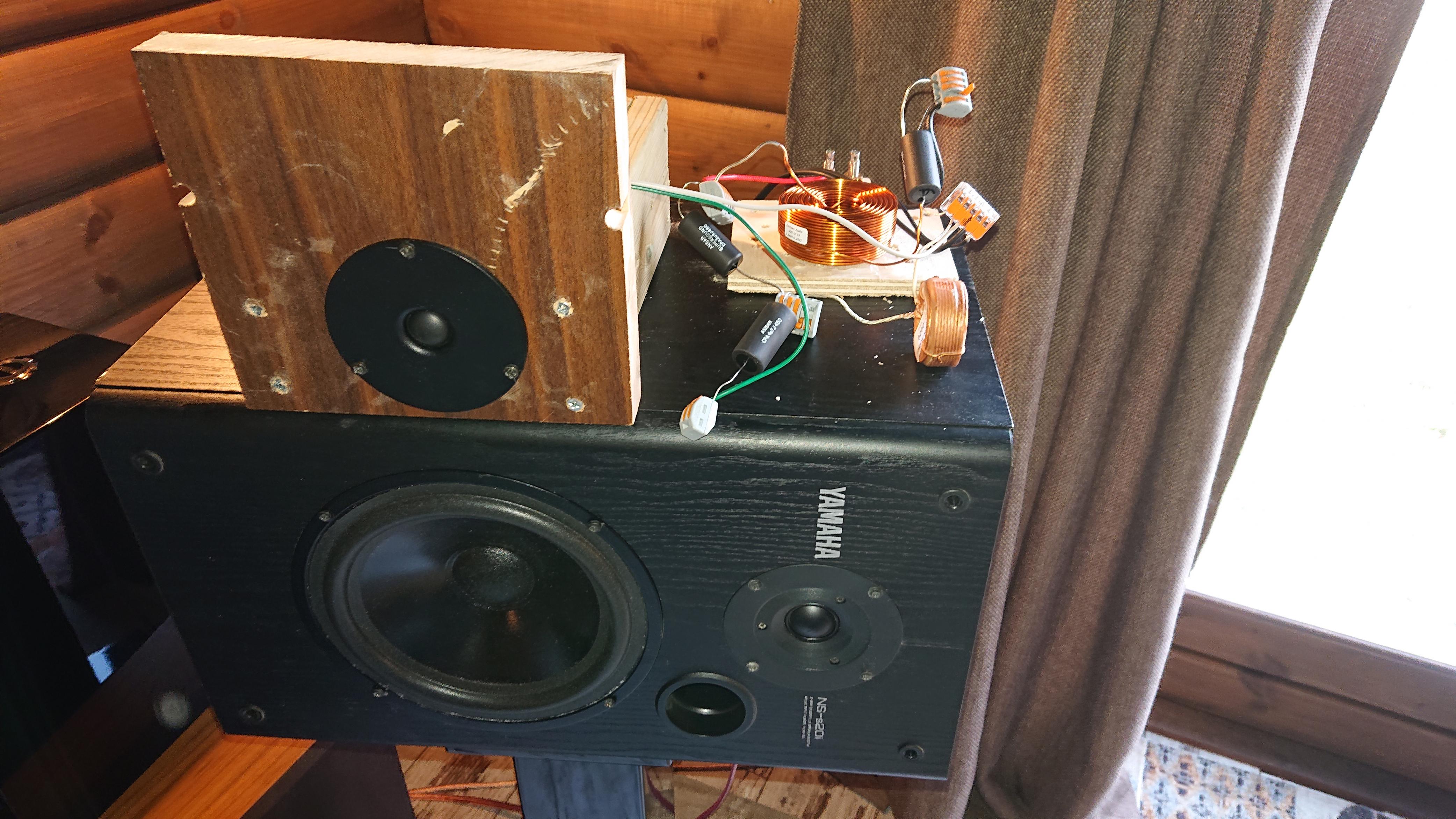

Got the crossover parts on saturday, been fooling around and tweaking a bit. Just some crude Yamaha boxes.
Tried the original Vifa P21WO-10-08 woofers and my modified M21WO-28-08. The poly P21 goes a tad deeper, but the midrange on M21 is better and the bass is a bit punchier.
Now for the tweeter. I have two versions of the Vifa D19 05 08, poly and textile.
Now I'm playing with the foam surround M21, textile D19, and Steve's crossover. And it sounds awesome!
Thanks a bunch guys, now I have to make some nice cabinets.
