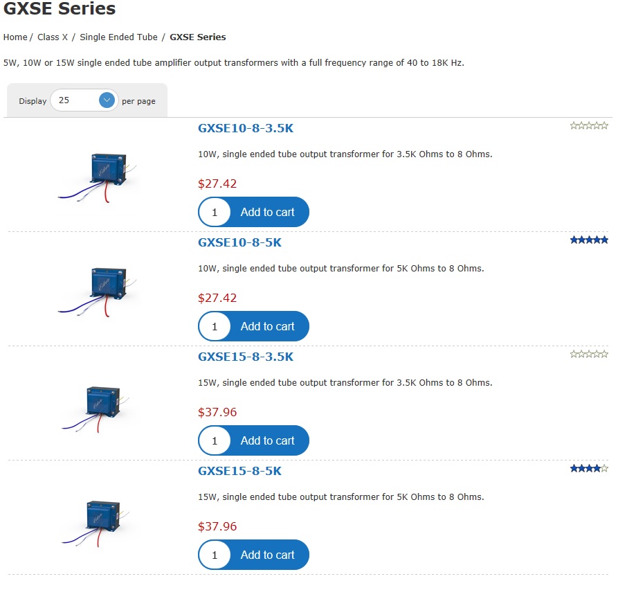

Just collecting the parts for a Jonokuchi build and have a few preliminary questions:
(1) what output transformers would be suitable to give more output for some 90dB speakers? Edcor have a few different options on their site, but I don't have the technical knowledge to pick the correct one.
(2) can anything be done to reduce the measured 1.3% distortion in speaker mode? This seems rather high...
Further to the above post, I notice on the Jonokuchi website that Pete mentions "The OPT is an off-the-shelf 8k:8 ohm SE transformer from Edcor (GXSE10-8-8k). 8k is a higher load than most people use for a 13EM7 (6EM7) amplifier... I did this to get the distortion and Zout low. This is part of optimizing the amp for headphones and not speakers; if you needed more gain and more output power, you could use a lower impedance transformer, like 5k or even 3.5k."
So in terms of more powerful transformers to maximise speaker output, how would the GXSE10-8-8k best be replaced out of the following:
