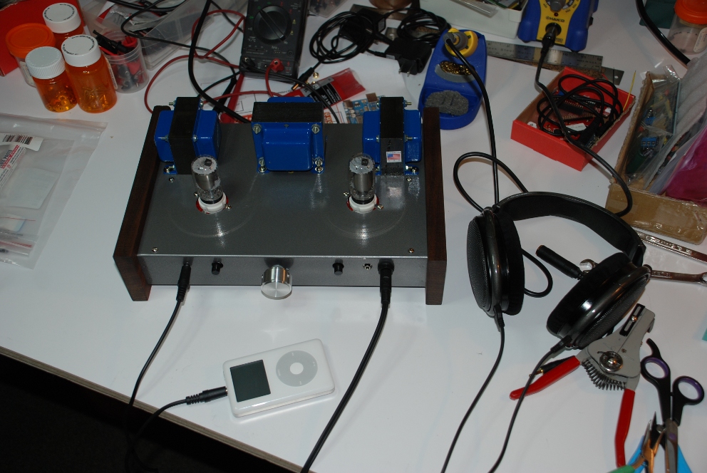

I finished mine today and connected JP1 on PCB because of Pete's and highflyin's comments. Even with the jumper I have hum with volume all the way down and hum doesn't change with higher/lower volume. All parts within whole amp are the same as required on the BOM with Hammond aluminum chassis.
I still get a very light hum in my unit even with the JP1 connected that's unnoticeable when music is playing. It's because the transformers are magnetically coupled, which is surprising given their distance on this design. The only way to get rid of it is to move them even further away on a wider chassis, which would have been too much work in my case. Since you're the third person experiencing the issue while using the Hammond chassis, it may be a good idea for Pete to take down that recommendation on his page.
The hum I get is loud enough that I can still hear it in background when music is playing at lower volumes. I'm using 64 ohm HD280's. With my 88db speakers, hum can be heard 1 feet away from woofer(at quiet times). Hum can be a big problem with >95db speakers.
I read somewhere Pete was saying that even he has hum issues. He said even with his high impedance cans, he can detect a tiny bit of hum which he reports is louder with 32 ohm Grado's.
I wonder if there is something out there; some sort of fix/dampening product to dampen the magnetic coupling. I like this amp, it plays about as detailed as my bigger amps.

I'm not sure what to tell you guys with hum issues. I may not be as sensitive to the hum as others, but on reasonably efficient (~90-92dB) desktop speakers about 2 feet from my head, I hear no hum. Also not noticeable in AKG 701's or HD600s. With Grados I have to be in a quiet room to hear any hum.
I did some experiments when prototyping that showed a lot of magnetic coupling between the power transformer and OPTs. That's why I had Edcor put a flux band on the power transformer. Basically, I moved the transformers apart until I found the hum level acceptable, and that's how wide I made the chassis.
If the hum is constant, with the inputs shorted, and is also present with the volume control all the way down... the issue is most likely magnetic coupling. There is also a little bit of hum from B+ ripple, but it is not as significant (at least in my case).
Assuming that the issue is magnetic coupling (flux leakage from the power transformer), there are a couple of things that might make things worse than what I experience. If the line voltage is high (mine is 120V), the transformer will leak more flux. Same likely is true at 50Hz. The transformer looks a little small for the power output, so I do wonder if Edcor cut it a little tight, and the transformer is close to saturation. That makes it leak a lot of flux.
If any of you have access to a variac, try dropping the line voltage 20% or so, and see if the hum decreases.
Another thing to try is to rig in more B+ filter capacitance (parallel in more capacitance across C9/C10) to see if that makes a difference.

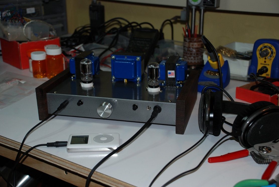

finished my build
I decided i wanted to build an amp and after reading lots of threads here i settled on the jonokuchi to cut my teeth on. I liked the large PCB and the option that it could drive headphones or small speakers. Mr. Millett's design is very straightforward to build and other than me not paying close enough attention to the drilling pattern (i got the back panel swapped left/right) the build was quite simple. I added the 'hum' modification as shown on his web site but there is still a small amount of hum. Even with that the overall sound is quite good (currently driving with an hand me down classic ipod and using Sennheiser HD650's). Thanks Mr. Millett for answering the few questions I had. The only real modifications I made were to add Walnut panels on the ends and spray the Hammond chassis with Rustoleum Hammered Metal finish paint.
