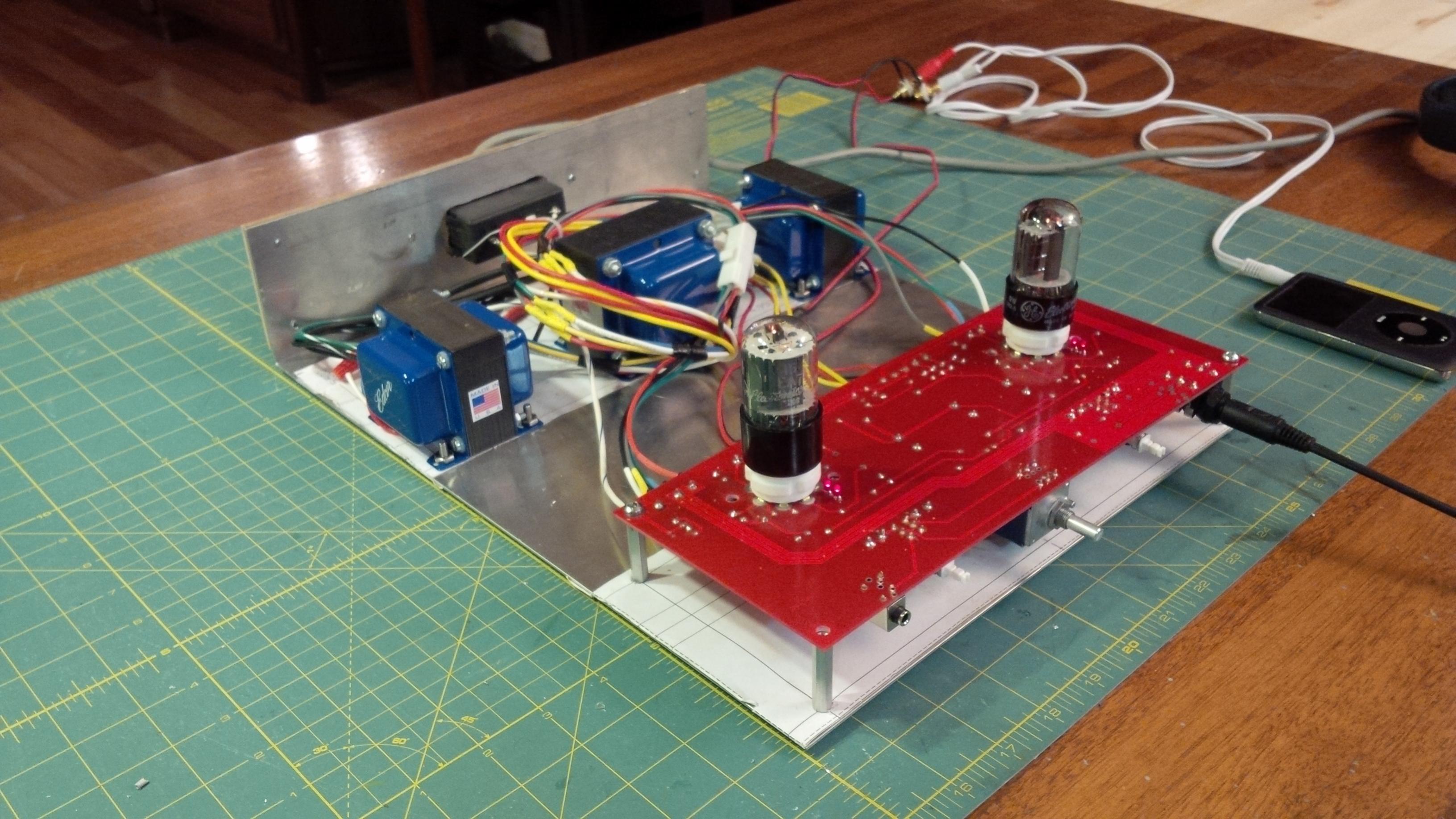

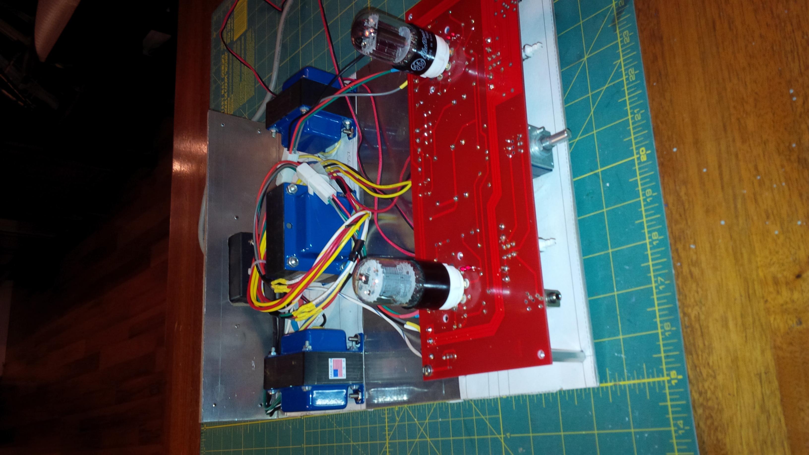

another Jonokuchi lives.
this in still on the construction chassis and i will have to decide how to case it
sound is very clean and a little bassy. i would like a touch more gain as i am running the volume wide open (or almost) with both my grados and senn's

i have 2 problems to solve before casing up.
1- there is a buzz that changes with volume if there is no load on the amp.
2- i have tested this with 8 sets of headphones. on 6, there is no hum. on 2 sets there is a low hum that does not change with volume. this is not audible when playing music.
the only difference seems to be the impedance of the phones. the 6 with no hum are 32r or 300r. the 2 with hum are both 60r.
any ideas?

yup. i did the low hum mod when i built it. i also have it on a temporary chassis with the transformers spread apart
A couple of things...
You may need to ground the volume control bushing. If it is installed in a grounded metal chassis, that will do it.
It looks like you have the ground loop breaker D1 installed, and no jumper on JP1. You can try shorting JP1 to connect AC ground to audio ground. That removes some noise for most people.
For the low level hum, try moving the transformers even farther apart, to see if it is coupling.
Pete
Pete

i will check the grounding tonight for the buzzing. it also occurred to me that the input jacks are not currently grounded to the chassis either and i will try grounding that as well.
i will spread the transformers even further to eliminate the hum, but i am puzzled as to why it is only noticeable on the 60r headphones

no luck. i shorted jp1 and mounted the input jacks on the chassis and the buzz is still there, but only until i connect to the source and then it immediately and completely goes away. it is quiet with the volume low and increases as the volume pot increases
the hum is also still there for the 60r phones. i moved the transformers around up to 12" away from each other (the length of the wire harness) and it has no effect at all.
That pretty much says that the buzz is a ground loop / ground noise problem, I think. Quite often EMI filters on equipment plugged in to the same circuit (computers are particularly bad) inject noise back onto the safety ground.
Not sure what you can try. Changing grounding, moving equipment, changing interconnect cables - all can make a difference. But sometimes it's always there, though usually at a low enough level to not be a bother.
As for the hum that is there at all times - you can try bigger filter caps. Some of this may be just power supply ripple getting through the output stage.
Pete
the buzz is fixed. i put 220r resistors across the L/R inputs to ground and the buzz went away. it does not appear to have affected the output levels.
i will try changing the filter caps to larger. these are C9 & C10? any suggestions as to values?
would changing the values of R4 & R3 have any effect?
