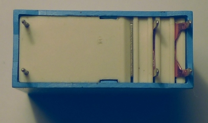

No, see bottom view.
The Amplimo LRZ relays I have are a different pattern from those in Edmond's picture, but they are certainly not hermetically sealed.
There is no sealant around the tags, and anyway, as with all such relays I use, I popped one open to inspect the internals.
No they are not hermetically sealed, true. You could mount it with a gasket between the relay and board, if you wanted, I guess. The solder pads should be airtight.
