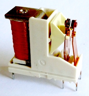

Almost all signal switching relays war made with gas filling, either nitrogen or argon. You know the plastic dpdt 2A type with gold over silver contacts.
Many useful POWER relays are made for automotive applications, these days. Low cost, high quality, advanced contacts.

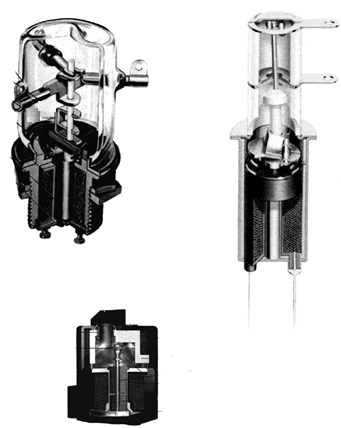

vacuum relays are typically used for HV and RF applications.
For RF it is fairly commonly used in antenna switches and for switching in high power exciters to biggggg amplifiers...
Don't think they're terribly applicable for this application, but who knows?
The Ruskies are exporting them now you can find 'em on epay if ur interested.

Yeah their website is not a model of clarity. They still sell the relay though, just send them an email. I think they cost about $ 8 or so. They are not exclusive, I have been told there are more relays that have dual contacts, but somehow these are not 'visible' to the audio community.
Jan Didden
While I think that this relay is interesting, I don't know how I could even buy it. Personally, I will stick with the more modern automotive relays for their price and availability. I can still get an A rating, using them. However, I do agree that power relays, in principle, are a problem, and should not be used for low power amps as output gates, or even most bridged designs.
