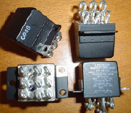

Manufactured by Leach LRE in Germany, used to drive the gun and turret of an armored assault tank.
Sealed and innert gas filled, balanced force relays. (maybe too expensive for your taste though) =>
