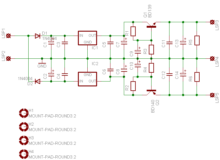

The CTC supply is composed of 2 regulators for each voltage. One is a 317 or a 337, and the other is an open loop shunt regulator to capture any transient overshoot coming through the 317. The final series regulator is ALWAYS on board the specific circuit board that it regulates. Here, a cap multiplier using a mosfet power device is adequate. This is NOT a quiet regulator as the mosfet makes too much noise for that, and this final regulator is inadequate for a phono stage. I hope this this is sufficient to remove any questions.
John,
Thanks for your update on any info I may have missed.
Given the fact that the PS is one of the key sections in an open loop line stage and one aimes to design it as noise-free as can be, I wonder why you have choosen the last stage to be a series regulator which as you already mention is noisier, but also has a higher impedance.
Secondly what kind of PS or stage would be more suitable to use for a phono stage?

Power supplies have come a long way since 7815 and 7915's. They were supposed to be perfect in the early 80's.
-Chris
Enough to follow them by transistor capacitance multipliers to get extremely clean PSU.
