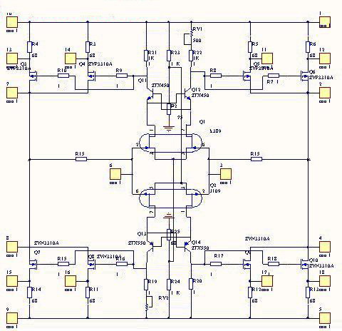

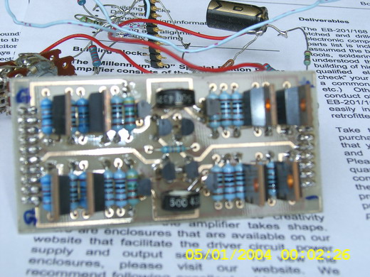

john curl: Our latest CTC designed preamp, that is much cheaper and easier to make, has little or no wiring, BUT it has double ground planes on a big circuit board. It should be available sooner or later.
John,
Is this the Halo P2(JC2) you are referring to, or is it an entirely different CTC version?
I'm confused, I stole the design from Chas Hansen! What is the schematic that goes with your picture?
mlloyd1
mlloyd1
john curl said:I'm confused, I stole the design from Chas Hansen! What is the schematic that goes with your picture?
