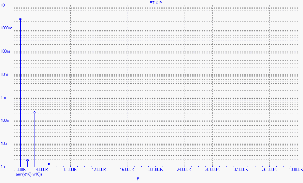

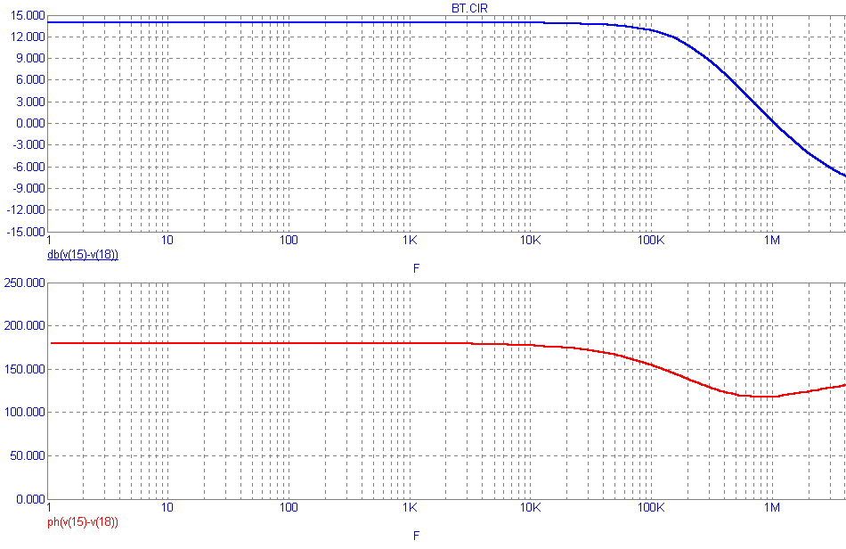

Well - does this fit?

I assume an R-C-R configuration would do the job, but to what extend does it effect the output impedance? Looking at the simulation plots PMA (thanks Pavel) presented, what approach is best in limiting
the bandwidth to say 90 kHz?
Janneman, thanks for your input and any comment on given plots and suggested roll-off @ 90 kHz.
Sorry, but I have to ask. The schematic looks OK, but what can I learn from this simulation? Bandwidth? That takes about 5 min with an audio analyser on a real preamp. It changes with volume pot position. DUH!
What about noise injection from the second stage to the input? What about distortion with output and frequency?

Regarding simulations
Friends,
I have received several questions concerning simulation today. The problem is not in circuit diagrams or spice models, IMO. For circuits like this, simulation usually yields reliable results. The problem is in application of simulation software for distortion spectral analysis - think about it.
I would like to mention several points:
1. I do not intend to build, try to copy, or to be guessing (this word has become popular recently) its real circuitry. I was just curious how simulation fits to measurements on real circuit and I got the answer.
2. I do not intend to support or consult attempts to simulate the preamplifier. The proper use of simulation tools is a part of my know-how, like the circuit design is a know-how of John Curl.
3. The circuit was designed by John Curl and I fully respect this fact. I congratulate him to smart circuit idea.
Yours,
Pavel Macura
