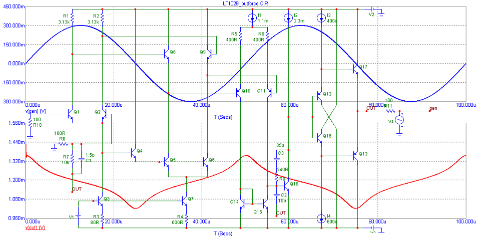

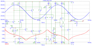

Sigrurd, I certainly see you doing good work, but I addressed these problems long ago, without a computer, and I am starting to see oversights in the design process, and excessive reliance on computer models. I am not against computer simulation, I have used it myself for the last 43 years.
PMA said:You're right as always, John :
Either you and John never read my AES paper or you didn't understand it. It has pictures too showing removal of crossover "bump" same bump as you show here on "other" guys part. Bruce Hofer of AP understood.

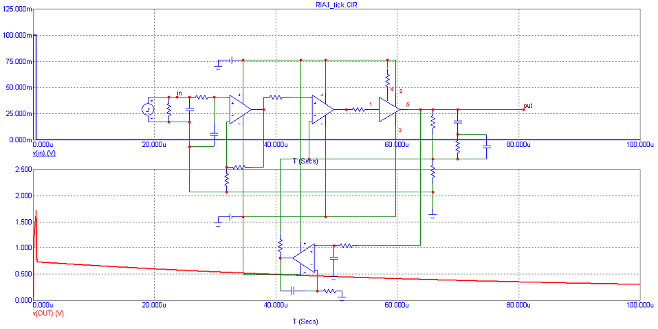

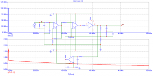

Silly question of the day:
What happens to the AD797 when the phone cartridge encounters a "tick" (no, not the kind of insect that causes Lyme disease) on a record? The load impedance on the output is only a few Ohms at 10 KHz, if I read the schematic right.
0.5mV input signal, 64dB gain
The feedback network values are in kOhm, not Ohms,
otherwise you wouldn't get 64dB of gain
It is so surprising ... it can be done with a calculator, easily enough, or even pencil and paper. 😀
