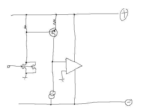

Back to non complementary, single-ended (BF862) input stages:
As for better PSRR, why not aim to actually improve the input stage performance too?
A big fat AC coupling cap from a drain resistor referenced to supply rai....BARF!
Maybe do this (just be carefull how you frequency compensate it):
G.Kleinschmidt said:
How much did ~200 jfets for sorting cost you? :D
$80 :D
You certainly don't like JFETs, arent you :D
That option is in the cards; but I'm thinking more and more about cooling the thing. A 1x1 inch Peltier device is cooling 10W at 70 degrees centigrades under the ambient and costs $20. Have to figure out what to do with the heat and condensation, though... Soo this thing is going to look like a power amp, with finned heatsinks, etc...
