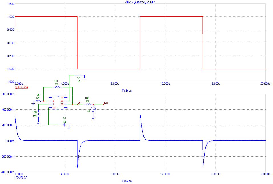

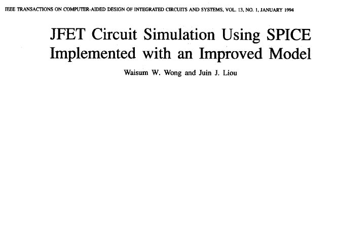

Remember the "fudge" factor in the FET noise model comes from integration of the ideal Shockley equations for an ideal symetrical FET. These short channel devices most certainly are not ideal.
Have you seen this paper, they use Toshiba JFETs to prove out the fit to the new model?

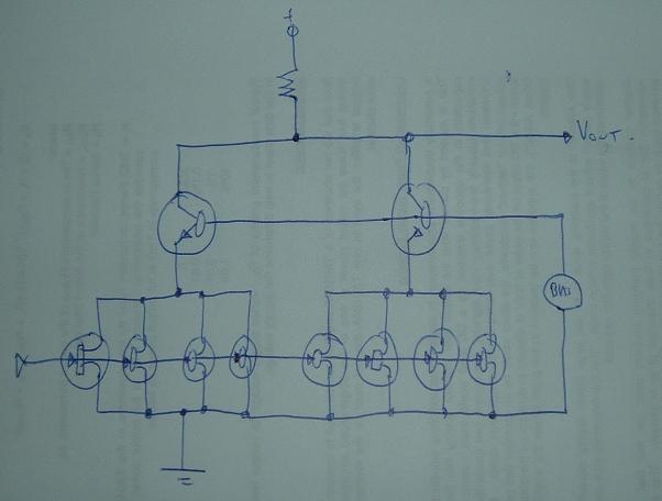

G.Kleinschmidt said:
:idea:
I just had one of those ideas that is either really clever or really dumb.
If you can't get more than 4 of those JFET's to operate directly in parallel without oscillating due to high net gm, then perhaps, if I'm not missing something here, this may be a solution. Add as many quads as your heart desires:
Glen
I taped this out last month on some left over space on an ExpressPCB run. I was planning then to parallel 8 of them to get my 32x. I'll tell you if it works. I have space for an SMT ferrite bead on each 4 group just in case. They spec at .06 Ohms Rs so that should not be a problem.

PMA, I note your simulation, but I think what we have to look at is the transition between class A and class B in the 797 output stage. This should occur at about .1V out, I should think. This is where the 'action' is musically as well. It is the harmonic series that will be generated, because the load is so low, that worries me.
Right now I am using the same IC, but with an 800 ohm load to do the same job. I'm worried, even though I have 10 times less loading than SYN08 has in his circuit.
