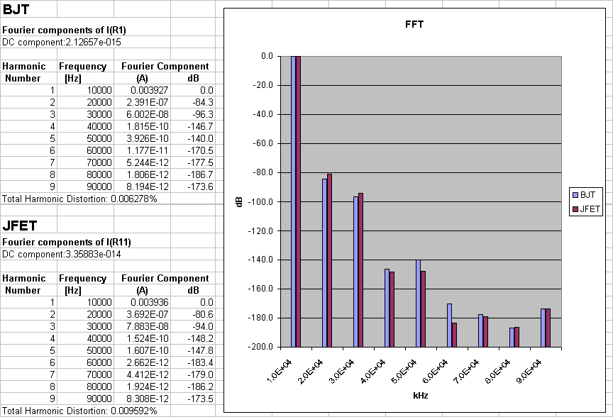

zinsula said:I'm only showing what I got. Nothing to "prove".
An I tried to compare same topologies.
Your BJT topology should be compared with a similar JFET topology.
See attached schematic.
As far as I can see the emitter currents of Q1,Q2 vs the value of R2,R3 is not optimal. For minimal distortion R2=R3 = 0.5 * VT / Ie. (VT is the thermal voltage, ~26mV)
Would you try this also, please.
Cheers.
Cheers.
Changed to 2.7 Ohm / 5mA Ie
I had also chosen 10 and 20 Ohms for Fet Sources mistakenly, now 10 Ohms for both N and P channel.

zinsula said:
With both arrangments, I have a "gm" in R1 or R11 of 3.75mS (=3.75mA per 1V input swing), and this is fair enough I think. This Gm I use to mirror the current and this will result in the same OLG.
But I have changed the arrangement:
R2 - R5 = 150 Ohm
R6 - R9 = 750 Ohm
For the same current swing, I had to set R1 = 100 Ohm.
These are the results:
