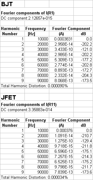

G.Kleinschmidt said:
This isn't a fair comparison because the 10 ohms emitter degeneration is nowhere near enough to bring the BJT gm down to that of the jfet gm. The optimal "bridge" resistor (R1, R11) will be far from the same in each case also.
With both arrangments, I have a "gm" in R1 or R11 of 3.75mS (=3.75mA per 1V input swing), and this is fair enough I think. This Gm I use to mirror the current and this will result in the same OLG.
But I have changed the arrangement:
R2 - R5 = 150 Ohm
R6 - R9 = 750 Ohm
For the same current swing, I had to set R1 = 100 Ohm.
These are the results:

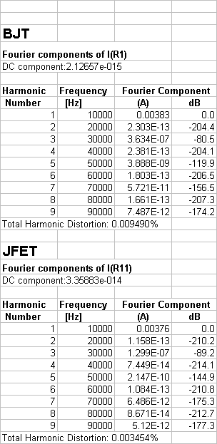

Re: Not fair?
Hi Zinsula,
So you are testing the circuits with a 1V input swing. Isn't that far, far too much? Under normal operating conditions, the differential input voltage is far less. Could you also look at the distortion figures at 0.1V input, please?
Cheers.
Re: Re: Not fair?
Edmond Stuart said:
Hi Zinsula,
Cheers.
Differential input voltage, or preamp input voltage? Under "normal operating conditions" the input voltage at preamp input terminals is up to 2.5Vrms SE from CD player output, twice from balanced output.
Re: Re: Not fair?
Edmond Stuart said:
Hi Zinsula,
Cheers.
Well, I am thinking about "open loop line stage".
But of course, if feedback is applied...
Here is the same config. as above, but 0.1V input swing.
Tino

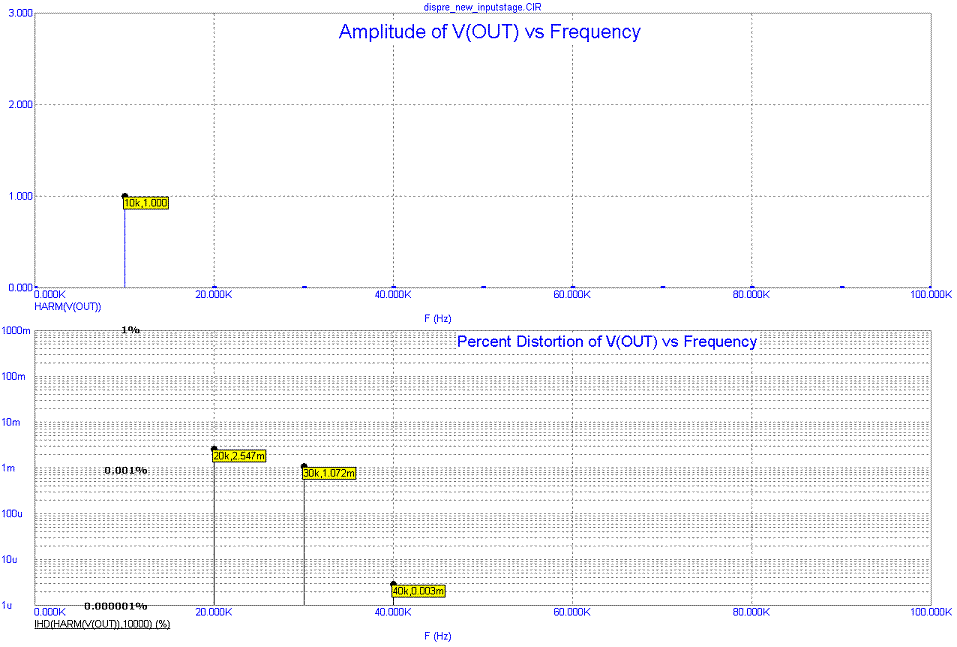

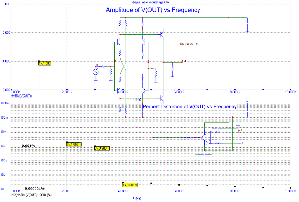

That's also the case with Douglas Self's analysis of "Small signal stages". He shows distortion of the whole amplifier, no one knows at what output amplitude, no one knows what is input voltage, no one knows distortion of the isolated input stage. And, analysis by 1 frequency sine tone is not very interesting, especially in case of high NFB design with low-frequency OLG roll-off, where differential voltage rises proportionally to signal frequency, pushing the input stage to less linear portion of transfer function. I want for my design to respond properly to input step with non-limited rise time, i.e. to some 5-10ns. Properly I mean not to get slew-rate limited.
Pavel, of course my simulations only show one frequency (10kHz), I fear I'm not able to perform more sophisticated tests.
It was one of my first trials at distortion simulation....
I did it more for myself, trying to see some difference between BJT and JFET.
At least, I believe I have isolated enough the input stage.
Tino

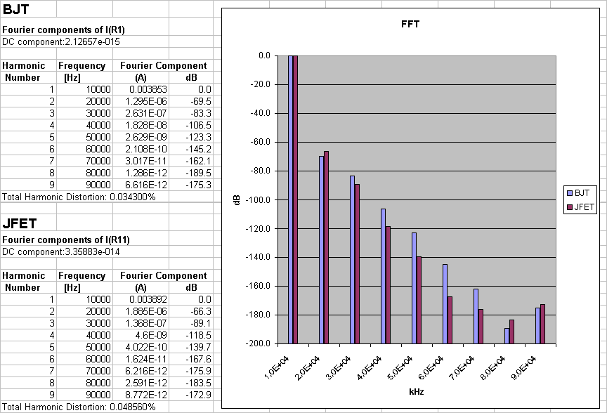

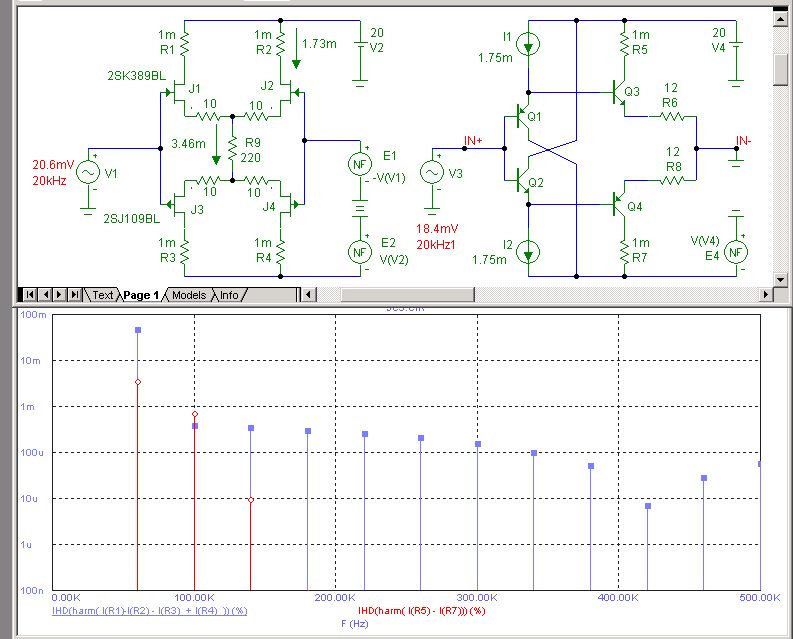

Pavel & Tino,
Are you proving that JFETs produce less distortion than BJTs?
If that's the case, then I'm not convinced.
The circuits below convinced me of the opposite.
They were operating at almost the same conditions.
Io = 2mApk-pk
JFET: THD20=479ppm (blue)
BJT: THD20 = 36ppm (red)
Cheers.

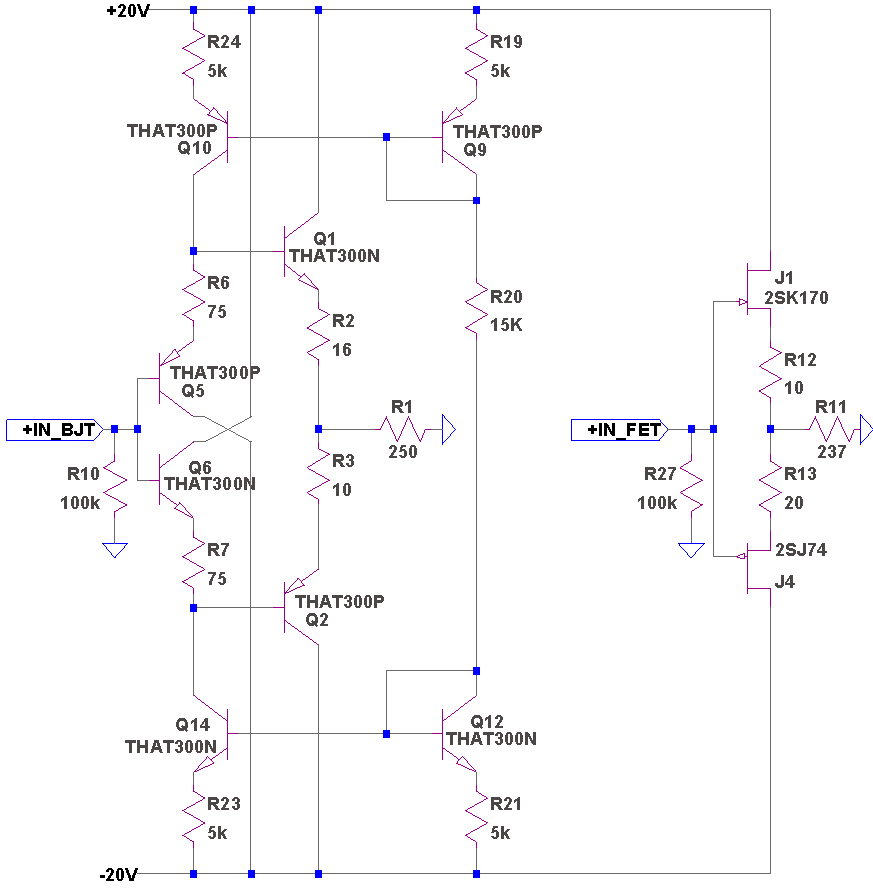

Edmond Stuart said:
Pavel & Tino,
I'm only showing what I got. Nothing to "prove".
An I tried to compare same topologies.
Your BJT topology should be compared with a similar JFET topology.
See attached schematic.
