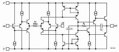

Hi Glen.
Agreed. One more reason not to use jfets. Another reason is that, at least in my application, jfets produce twice as much distortion.
So I'm using something like one half of circuit as shown in your h.gif. It's a CFB input stage, configured as diamond buffer.
BTW, I assume that it is just as immune for HF interference as the AD844 (also a CFB amp).
Edmond.

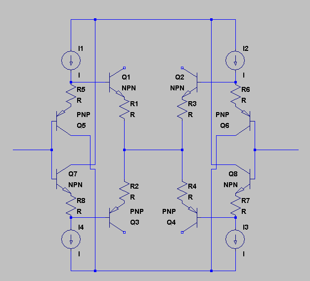

zinsula said:Of course, such a complementary input differential can be done with BJT's...you just need a whole bunch of more parts.
As in the example here.
Does somone recognize this schematic? No, it's not a one million dollar question 😉
Tino
Apparently you don't know the difference between an input stage and a complete amp or op-amp. 😀
My IPS contains a 'bunch' of only six trannies, current sources included.

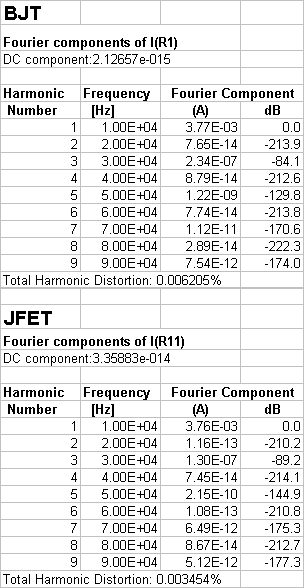

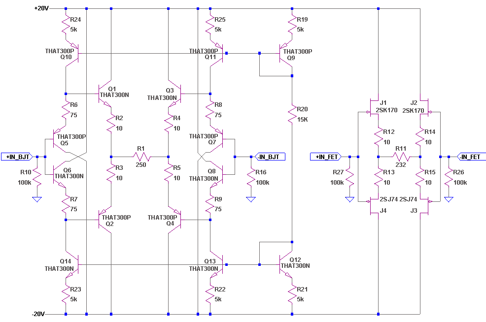

Yesterday evening, I have compared the following BJT (left) and JFET (right) differential stages.
R1 respectively R11 set to get same current swing with same input voltage (around 3.7mA/Volt).
This current could be mirrored to the transconductance node in the next stage, eg. as in the AD844.
In the next post, the simulated distortions.
OK. And for balanced (the BT is balanced, for instance) you'd need 12, isn't it?Edmond Stuart said:My IPS contains a 'bunch' of only six trannies, current sources included.
Zinsula,
Okay that is a bunch of BJTs, but it's far from representative of a common CFB input stage.
zinsula said:Thank you for the reminder.
My circuit is already balanced, as it is complementary. It is pointless to double balance this circuit. Ask Bob Cordell. 😀
Moreover my IPS (a CFB thingy) is faster, i.e. less phase shift in the FB loop and equally important, it is suitable for DTMC in order to increase the phase margin of the FB loop even more.
zinsula said:Yesterday evening, I have compared the following BJT (left) and JFET (right) differential stages.
This isn't a fair comparison because the 10 ohms emitter degeneration is nowhere near enough to bring the BJT gm down to that of the jfet gm. The optimal "bridge" resistor (R1, R11) will be far from the same in each case also.
