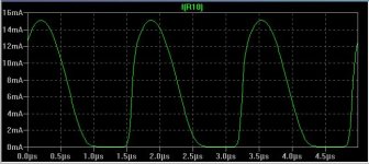

Just to illustrate a few points I made in a previous post about the ability of emitter degenerated BJT input stages to pass relatively large RF voltages linearly and the fact that RF overload and AM demodulation can happen in stages after the input stage before the input stage actually causes a problem, I have run a quick sim of the basic amplifier I described earlier (post 7031).
The LTspice schematic appears below. The original circuit had a complementary Darlington emitter follower output stage, but for simulation purposes I just used a VCVS.
Please note that this does not represent a “HiFi” design, but the principles are applicable to amplifiers of far greater complexity and I think are rather important with respect to the potential problem of AM demodulation.

And lastly, here is a plot of the collector current of the VAS clearly showing a half wave rectified sinewave making it clear that AM demodulation will happen here well before it does in the input stage.
The simulation of the VAS current was of course done with the negative feedback connection to the inverting input restored.
To summarise:
The input long tail pair is responding in a linear fashion to a high level RF input signal without overload.
This RF input signal, further amplified by the long tail pair, is causing overload of the following stage – in this case the VAS.
A single ended VAS such as this when overdriven has the capability of conducting far in excess of two times the quiescent current, as a consequence of which, a crude rectification of high level input signals takes place.
The most important point to make at the end of this is that, with the same value (220 ohms) emitter degeneration resistors, a BJT input stage of a more refined amplifier supplied with a tail current of, say, 5mA, will have vastly improved frequency response, improved linearity and an overload margin almost TEN times higher than the one presented here.

To summarise:
This RF input signal, further amplified by the long tail pair, is causing overload of the following stage – in this case VAS.
[snip
Hi Glen,
Okay, it's the single ended VAS, being the greatest culprit. So I wonder to what extent a fully complementary front-end will rectify HF interference. Perhaps you can simulate this too (I can't do it at the moment, as I'm not at home now) and perhaps you'll find one more reason to use a complementary VAS.

Hi Edmond.
Unfortunately it is 1am here so I should probably go to bed.
BTW, the single ended VAS is much better behaved if you use miller compensation, as this turns the VAS into an integrator which effectively kills the HF gain right where it matters.
I think a differential VAS will only be better in so far as it can maintain balance when over driven with a high frequency signal. Also, again, like in the singe ended VAS topology, it depends very much on how the amplifier is frequency compensated.
Glen
