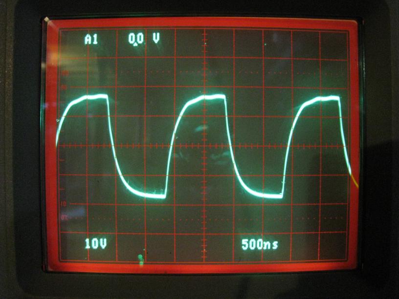

PMA said:I meant generallly used simplification as VFB, usually dominant-pole compensated device, with low roll-off corner and with very strong NFB. BTW, I have recently made interesting simulations of PIM, that is inherent to this structure, only a question of measure.
Pavel,
This is the step response of one of my purely opamp based line preamps. Not "dominant pole compensated" and of course not slew rate limited. Do you need me to calculate the slew rate?
I can't measure any distortions (and my lower limit is -130dB) on this preamp, including the much feared 7th. Noise is around 5nV/rtHz (remeber, this is a line preamp).
Fits in less than 1 sq inch of SMD PCB. The details will be published on my site ASAP.
How's that? Think it's good enough for audio? The cost (in SMD parts and PCB, without power supply) was around $10.
Edit: gain is set to 10.
