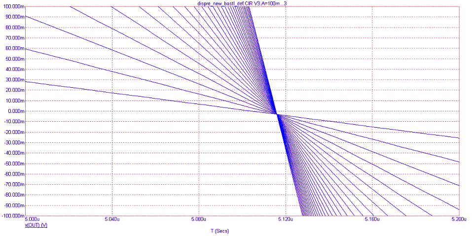

Nothing really special. Just challenging Pavel's statements about op amps "dominant pole" "slew rate limited" etc... On a more general tone, challenging the "all discrete" approach in Anno Domini 2008. Which doesn't impact the merits and records set 20-30-40 years ago by John Curl et. al.
Edit: at the same cost and size, John? Ahem... And just in case you or anybody else is asking, yes, there's a lot to design in such a design. Starting with the compensation schema and ending up with the layout.

I have another one that slews 30V in 45nS but its not 100% opamp based and has only -110dB THD20 and noise 10nV/rtHz. Its built on microstrip 😀 I will post some pictures tomorrow.
Edit: do you really think I'm using 5532? 😀

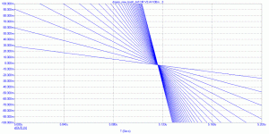

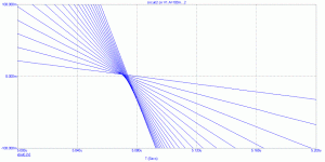

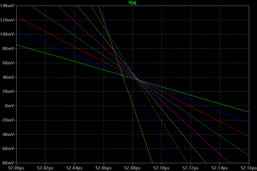

I for one can *not* exactly reproduce Pavel's "PIM"-graphs, but slightly different ones, still showing some zero crossing shift with increased amplitude.
Albeit with a different amp (F5-style, but with bjt diamondbuffer frontend, which doesn't matter much in this context). It is compensated for decreased open-loop gain above the audio band (pole/zero pair) to better handle cap loads (10nF used here). When I remove the compensation and cap load, I get the similar curve "distortion" as Pavel with his dispre vs. 5532, better correlated zero crossings and overall shifted in time.... until I zoom in further...
Test freq was 40kHz to get a clear picture 😉, and drive from 10% to 100% (of just below clipping level) into 5.6R.
EDIT: I recognize my graph doesn't match Pavel's
- Klaus
