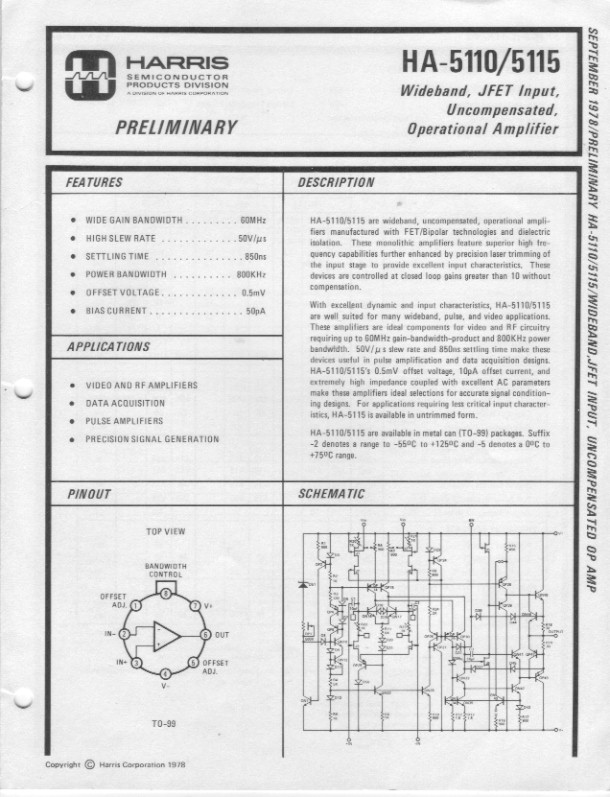

Courtesy of John Curl:
Except for using current sink loading instead of resistors, isn't this part similar to an AD845? The AD845 has lower bandwidth, but better slew rate, better "power bandwidth", and better settling time. Plus you can still purchase them...
Of course, this Harris part was pretty remarkable for its time.
if anyone has access, i think this may be mentioned in the trade rag "electronic design" for 1979 or so. they used to run special analog highlights issues every year to talk about new hot parts that had just come out.

The AD845 appears to have been introduced 10 years after the HA5110. Who were the HA designers, anyone know?

I've known Barry Harvey for a long time. He was at Elantec before the buyout. I don't think he was at Harris, but I have some friends that were. I suspect the guilty parties are from the days of thin black ties and white shirts, military style flat top haircuts required🙂 . As I recall the military bankrolled a fancy DI process for Harris. That design is what I would consider a little "gothic" way to complicated for the HP-35 and breadboard style of design so I also suspect they had their own mainframe for early simulation (I could be wrong). We used to buy/resell some of these amplifiers (mostly to military customers). The days of $65 mil-spec IC op-amps. BTW 50V/us for a DE-compensated op-amp is pretty slow. I sponsored a thread last week on classic discrete op-amps where in the same time frame they were at 2GHz GBW and 1200v/us.

It's hard to see the 5110 schematic but on a closer look I guess it's not far off from some of the discrete op-amps of the day. The use of FET interstage coupling mostly became deprecated after the module days. The choice of source followers on the input rather than using the FETs as the input pair is still a valid one, examples of both are still current.
I also remember that the last thing Dick Burwen did here was build a settling time fixture for one of those Harris op-amps, that I inherited .:dead: It broke one quarter and I thought we were going to have a full military inquiry because the parts ended up in some nuke subs.

As I recall the military bankrolled a fancy DI process for Harris. The days of $65 mil-spec IC op-amps.
Yup, I remember that very well, Scott. Also the SOS (silicon-on saphire) CMOS logic by RCA. Harris was called Radiation back then, and then they bought RCA's CMOS line. DI was the only way we could get through the military nuclear hardening requirements. Bendix worked very closely with Scandia Labs when they were in the semiconductor business, making super-beta transistors that would maintain sufficient hfe and low enough leakage to continue to operate after the nuclear "event" test. Hardened PNP devices were especially difficult to make, and very susceptible to permanent damage.
Very interesting work, but the data items went on forever and qual testing was very intense. Each bombarded device came back in a lead-lined box with a big yellow radiation warning decal on the cover, and in the early days the devices were accompanied by a Scandia official to ensure proper handling and test and safety for the personnel involved.
