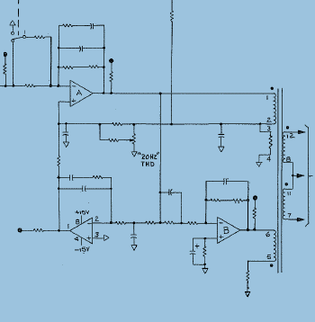

Want to post a schematic or two to prove 'where' API uses audio transformers and how?
calm down, John
